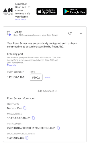

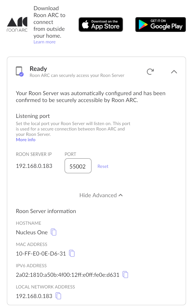

I add the ARC page on Roon, no warning there

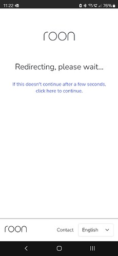

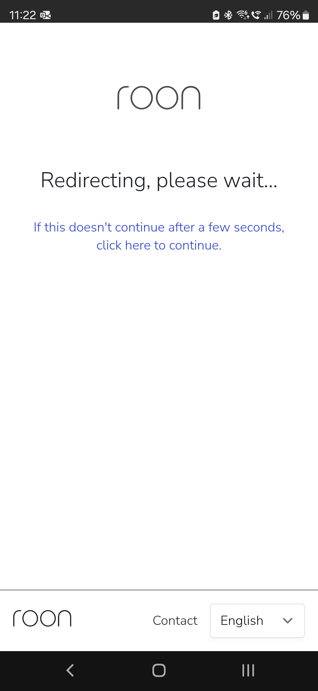

I get no warning only ‘Redirecting please wait…’ and clicking below after a few seconds doesn’t change the message

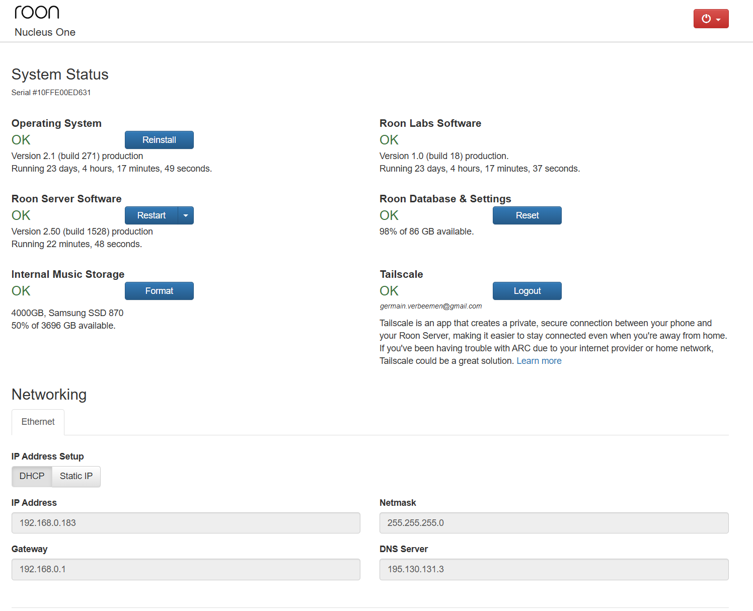

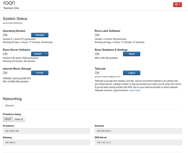

And I add the Nucleus One page

Just to confirm, you are seeing this message before you are able to get to the Roon Server selection screen? If so, this sounds like an issue unrelated to your Nucleus, but rather to the general login from your S24. Do you have any VPNs, popup or content blockers that could be interfering with ARC from communicating with the login servers? Can you share a screenshot of the exact state that ARC is failing the login on? Thanks!
The screen coms after I choose my login, the choice of the server is not yet asked

Hi @Germain_Verbeemen,
Can you try logging in with a different browser? In some cases, privacy or security settings in your current browser can interfere with the login process. Let us know if that helps!
Dearest Daniel, it helped!! When putting Chrome as default browser on the S24 ARC could login to the Nucleus…
