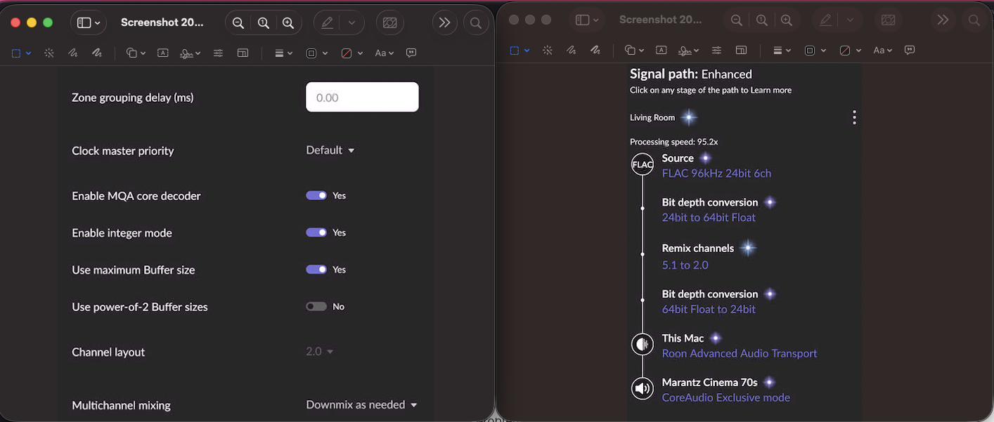

· Hi! I am trying to get Multichannel Audio working on my setup, but every time I try to play a 6ch FLAC file, it seems to revert to streaming in Stereo. The option to set more than 2.0 channels is greyed out. My setup:
# Roon Server 2.6.2 (build 1641 - production) - Mac Mini (2023, M2)
· * Also hosts local music files on an external hard drive
# Marantz Cinema 70s
· * connected to the Mac Mini via HDMI ultra high speed cable onto an 8k port
* 5.1.2 Bi-Amped
* Tested multichannel audio on my Blu-Ray player and it works fine, so I know it's not my gear
I've tried the following:
* Closing Roon, opening the "Audio MIDI Setup" app, and changing the "marantz-AVR" to 8 channel 96kHz, and then opening Roon - it reverts to stereo "2ch 24bit 96kHz" when using exclusive mode; without exclusive mode, it is not honored, and the channels remain greyed out
I've followed the instructions laid out in other threads, but it doesn't appear to be honored. I'd really like to be able to use exclusive mode and rely on Roon instead of the OS mixer to stream audio in multichannel.
· Server connected to ethernet. no VPN
Hi,
your pic on the left shows that Roon is set to play in 2 channel mode (channel layout - 2.0) and to downmix channels (Multichannel mixing - Downmix as needed). Have you tried setting channel layout to 5.1?
Yeah. What ends up happening initially is that it lets me change the channel setting to 5.1 or 7.1, but it still outputs in stereo. Changing a setting, such as toggling Power-of-2 buffer size, sets the channels to 2.0 and greys out the option (not allowing me to change it). In both cases, the OS reports it’s outputting 2ch 24-bit integer 96kHz.

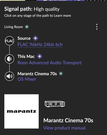

Setting Exclusive Mode to off does allow for multichannel output, but then I’m relying on the OS mixer and not CoreAudio to process the music. The signal path then indicates the stream is not lossless unfortunately. It would be great to have both lossless and multichannel!
