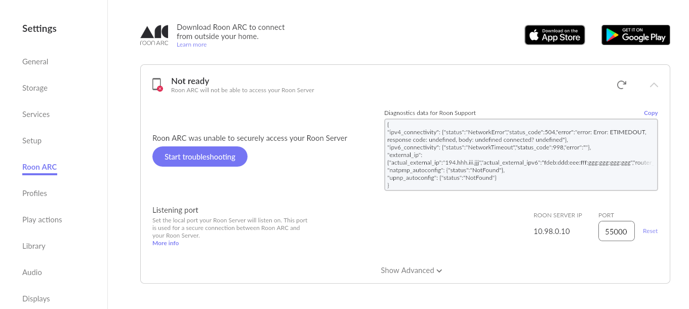

Hi @Mark_Jaffray, please copy and paste the Diagnostic data for Roon Support found under Roon Settings → Roon ARC. Thanks
It’ll look something like this.
Hi there
“ipv4_connectivity”: {“status”:“NetworkError”,“status_code”:504,“error”:“error: Error: ETIMEDOUT, response code: undefined, body: undefined connected? undefined”},
“external_ip”: {“actual_external_ip”:“206.aaa.bbb.ccc”,“actual_external_ipv6”:“null”,“router_external_ip”:“null”},
“upnp_autoconfig”: {“status”:“NotFound”}
Looks like you may need to look at your UPNP and NATPMP settings or do some port forwarding.

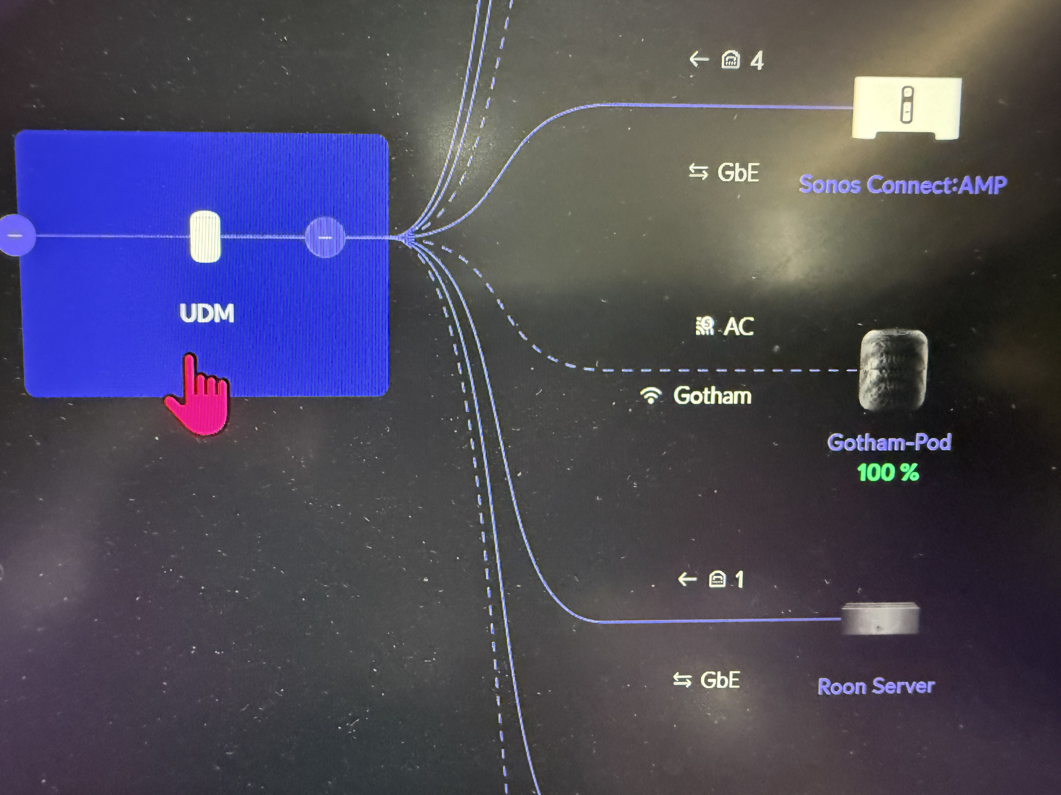

With regard to 1. Use unifi router and roon connected directly to that using Ethernet.
Roon and unifi about 1m away from each other

This is suggesting that the router to which your Roon Server is connected (your UDM) has a WAN side ip address of 192.168.1.52. This is a private ip address range and so will not be issued to your UDM by your ISP. This being the case, it still looks like you have another router between your UDM and your ISP supplied line. The most likely culprit is an ISP supplied ‘modem’ which is a tally much more likely to be a midem/router device. To eliminate the double NAT, you will have to, if possible, put this modem/router into bridge mode or modem only mode.
If you can’t change the mode of the ISP supplied modem router, you will have to abandon the use of uPnP and configure manual port forward on both routers.
On the ISP router forward TCP connections on the ARC port to the WAN side ip address of the UDM (192.168.1.52).
On the UDM forward TCP connections on the ARC port to the ip address of the Nucleus.
Again, since manual port forwarding is used, you will want to set up a DHCP address reservation on the ISP modem/router for the UDM and another on the UDM for the Nucleus
