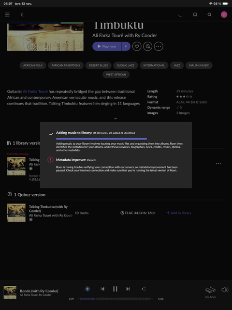

see EB1F08 I get this error message when playing through my NUC but NOT when playing ROON via my Win11PC. Is this related to the drop outs?

If you’re referring to the “Metadata Improver: Paused” notifcation, RoonServer is usually having issues resolving URLs with upstream services.
Please follow the suggested steps here and let us know if this helps:

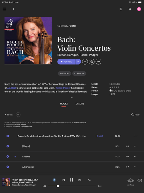

Hi Benjamin, I started up my system at 07.30 approx and played a Bach violin Concert. (good breakfast music) at 07.59 I had two short drop outs.
Best Regards
Harald

11/21 06:58:25 [Local 11/21 07:58:25] Trace: [my Aries] [Enhanced 36.6x, 24/192 QOBUZ FLAC => 32/192] [100% buf] [PLAYING @ 0:42/5:15] Violin
Based on the logs, the problem is between your Roon Server and the Aries, not between Roon and Qobuz.
