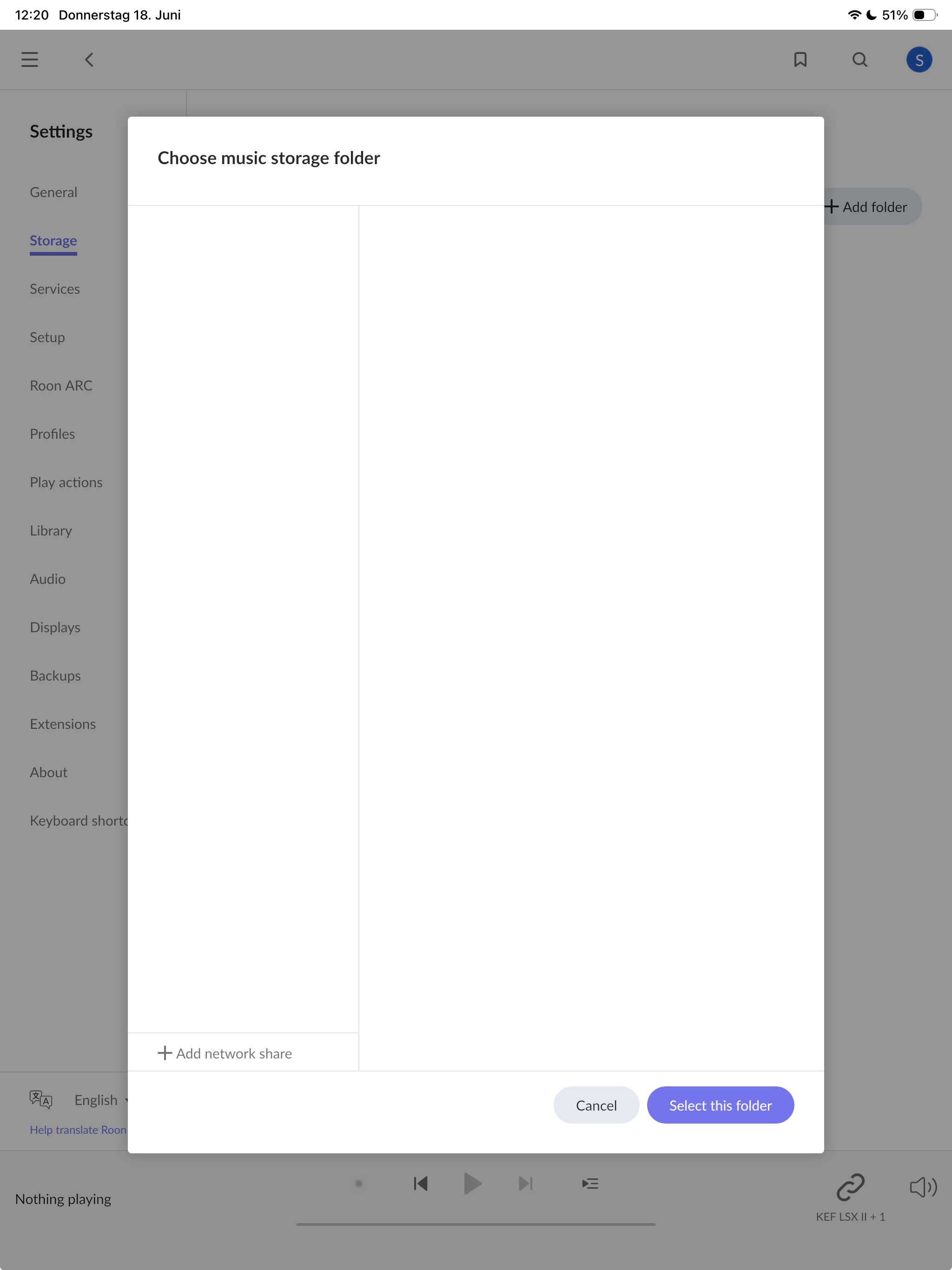

· After a reinstall of ROCK on my NUC I can't play radio stations anymore. The web interface shows missing codecs. I installed ffmpeg to ROCK (I tried both the amd and x86 versions) but even after reboot, the codec is still missing. I tried to set ffmpeg to executable, but smb won't let me. Also I cannot add a local folder, only network shares. A problem with the file system?

Also, access over the network works fine. I can access the data folder and my Music folder inside it. I can play files from it on my computer. Also the Codecs folder is reachable. What I cannot do is add the Music folder to the ROCK system for scanning. The file browser is empty. I can add a network share (which I tried, adding smb://rock.local and also localhost but that doesn’t work and clearly is not the idea)

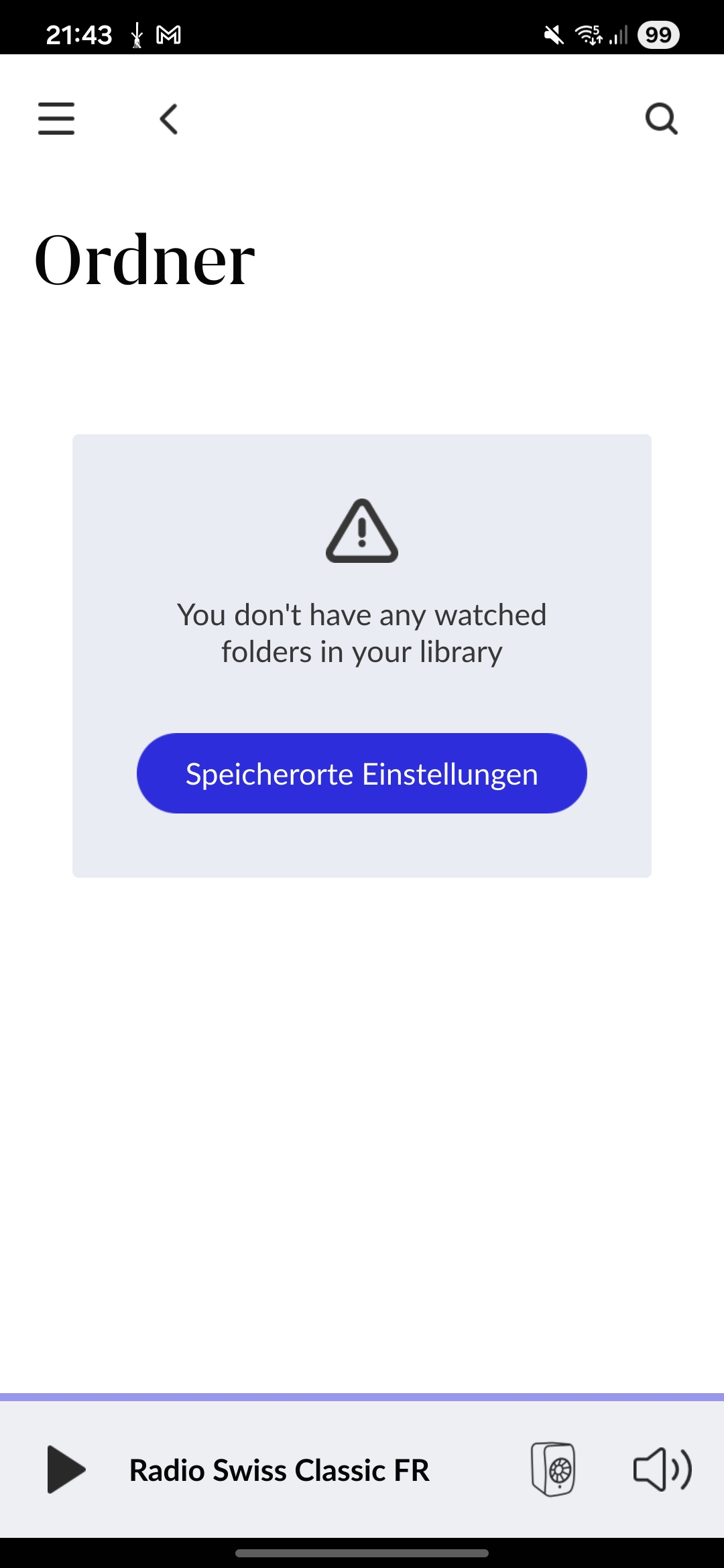

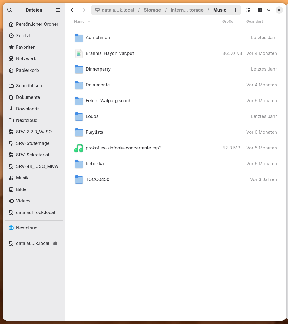

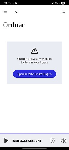

Also, I moved all my music files (not many) to InternalStorage (which I created, it didn’t exist). But still the “Folder” source in Roon says, there are no folders being monitored.
Finally found kind of a solution to part 1 (codecs). See this post: Getting Codec installed and working in Linux is?
There seems to be a massive problem of the two linux machines talking to each other. I have no idea why. Putting files from my desktop to the rock machine in the obvious simple way through the network access of the file manager (gnome/nautilus) does NOT work correctly. Others have found out, but the information is hidden in long disussions. This seems to be a networking issue on one of the machines. I have never encountered similar problems accessing other network shares from my laptop, even including remote access through vpn. But probably this is also the reason, rock cannot “read” the music files (which are there, I can see them from other locations, i.e. from my ipad.) Next step: I will copy my music through my ipad and check, if this works.

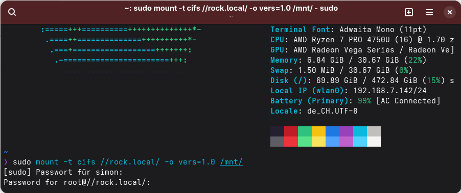

BTW: if I try to mount my rock network share to my linux desktop, I must provide a root password for rock. empty or ‘guest’ does not work. That is kind of peculiar. Is there a way to mount the share anyway? I tried this:
❯ sudo mount -t cifs //rock.local/Data -o vers=1.0 /mnt/
and also without /Data/

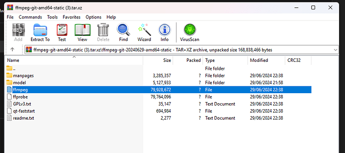

There’s your problem - you do need to decompress twice - you’ve copied the compressed ffmpeg to your Codecs folder.
This is what you get after the first decompression:
You then need to select the ffmpeg file and decompress that (Using “Extract to” in this WinZip example). That then gives you the ffmpeg-git-amd64-static folder containing the decompressed ffmpeg file:
