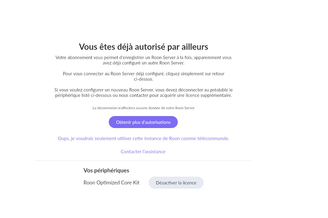

hi Benjamin ,i put all my back up in a separate on an external disc connected to my imac with usb .i lost the list i made with the nuc , i know it s not very important from a n external point of view .The problem remains the same because only lists transferred to qobuz are kept in the roon application when i swap servers .
now two questions please
1)What am i missing or ignoring? is it mandatory to record playlist in qobuz to keep them when i need to change roon core ?
2)how can i swap roon servers in roon interface ,everytime i tried the answer is see pict (even if i disconnected the nuc before )
.don’t laugh please …thank you .

Hey @pedro_bouricot,
Thanks for the additional information!
No laughing at all - we’re all learning as we go, and I respect you and your troubleshooting efforts so far!
I don’t believe you’re missing anything, perhaps a bit of confusion on your playlist tied to streaming services, versus playlist you’ve created in Roon directly - which are tied to your local library instead of originating on Qobuz.
Based on your screenshot above, it looks like you’re attempting to use your Mac to run Roon Server as well (you can see the option to deauthorize your ROCK below it). If that’s the case, you can move forward with deauthorizing your ROCK.
Either way, to restore all your playlists, you’ll want to restore from one of your recently saved backups on the external drive. Let me know if this makes sense and if it answers your questions! :+1:
