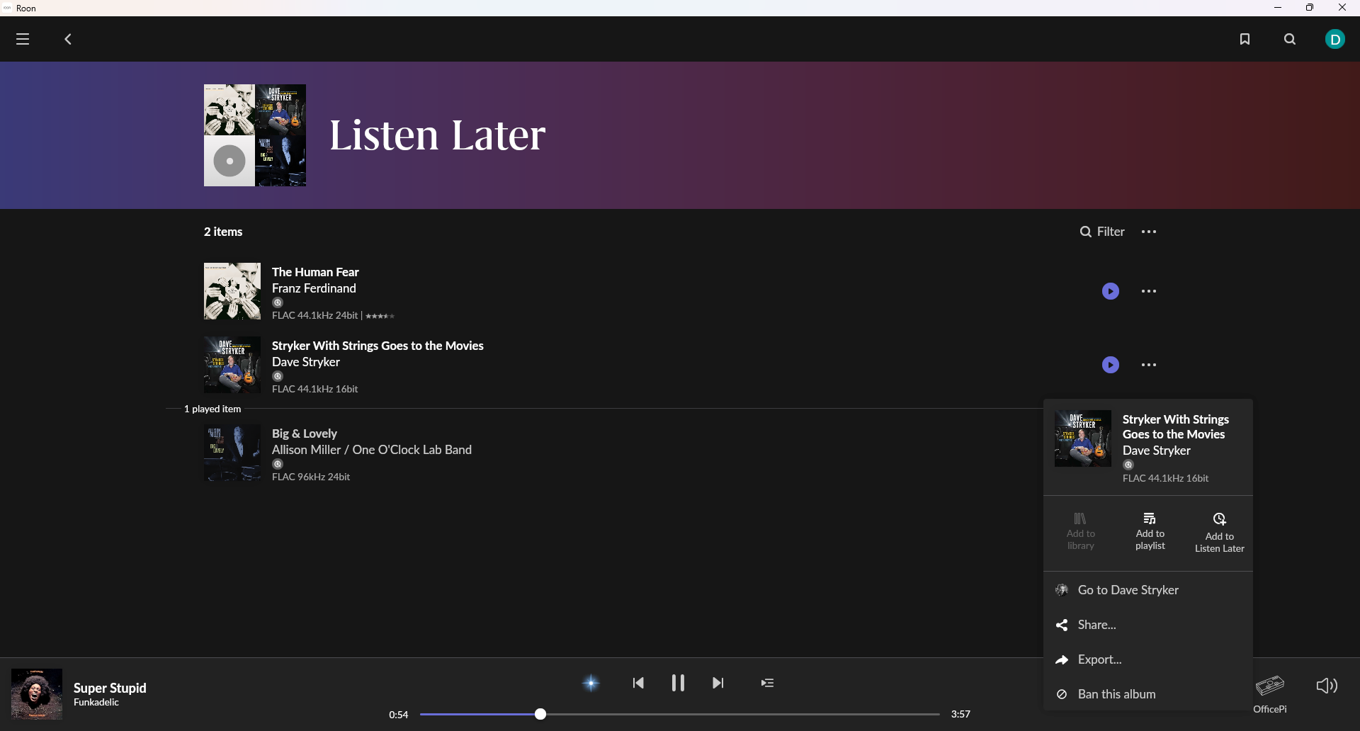

I can't remove an album from the new Listen Later screen. The attached screen shot shows there's no provision to remove the album from the Listen Later collection. I did add the album to my library if that makes a difference. Also, I have removed at least one other album with no problem.

@AceRimmer’s response is the correct workaround in this case. This involves Roon’s treatment of library vs. streaming objects; adding the Dave Stryker album to your library swapped a streaming object for a library object.
The team will investigate why the Listen Later options menu (…) isn’t reflecting the track’s current status in that page. Please keep an eye out for an additional comment here.

To remove the original instance you will currently need to remove the album from your library. That will enable the ‘remove from listen later’ option in the popup that opens when clicking the three dots to the right of the ‘listen later’ option
