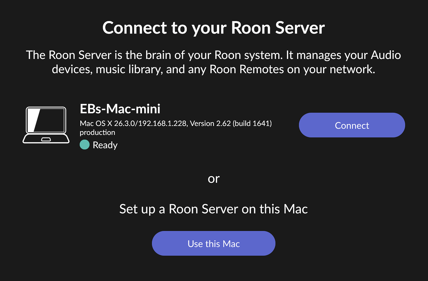

· After today’s update, I am unable to restart my Roon Server. My Mac downloaded and installed the update, and I tried to restart the server but it came up with an error that it could not find my Roon Server. I turned off the locations (local and network) and turned it back on. It still would not find my server.
I rebooted my Mac, and tried again. It got a little further and it came up with a screen that said connect to the Roon Server, I clicked connect and the connection icon came up and just hung there for more than 30 minutes before I closed the program.
Im running a Mac mini with the latest MAC OS with 16MB of ram. It’s a great clean machine. I have run into problems with updates in the past, but they always seem to fix themselves. This one seems stuck. If there are files (cache) that I need to delete, please advise. I’m not sure a reinstall would be helpful as my library has over 140,000 tracks to it and it would take a good chuck of time to start over.

It sounds like you’ve already tried retoggling Roon’s local network permissions in System Settings → Privacy & Security → Local Network.
We want to take a look at server logs, but the machine appears to be currently offline. At your convenience, please use the directions found here and send over a set of RoonServer logs to our File Uploader.
We’ll check for the source of the error and follow up.

To be completely candid about what is happening under the hood: this repetitive issue is inherently a macOS security behavior, rather than a Roon-specific bug.
When the Roon application installs an update and changes its underlying files, the macOS security layer often silently panics and corrupts the internal “Local Network” permissions for the new version. It essentially blocks the newly updated app from talking to its own network stack. This is exactly why the Roon interface suddenly can’t find the Roon Server, even though they are literally running on the exact same piece of hardware, because it still uses the network stack to find even the local server.
Our developers are continuously looking for ways to force Apple’s network layer to handle these update transitions more gracefully. However, because this is an OS-level block, you absolutely do not need to reboot your entire home network when this happens. The blockage is entirely contained within the Mac mini.
For future updates, here is the most direct way to clear the macOS network block without touching your router:
  1. Go to your Mac’s System Settings > Privacy & Security > Local Network and toggle both Roon and RoonServer OFF, then immediately back ON.
  2. Click the small Roon icon in your Mac’s top menu bar (near the clock) and select Quit Roon Server, then launch it again.
  3. If it still hangs, perform a standard reboot of the Mac itself.
