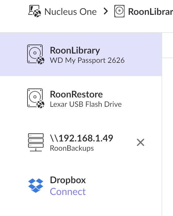

Under Storage, my Library shows like this: Nucleus One > RoonLibrary.

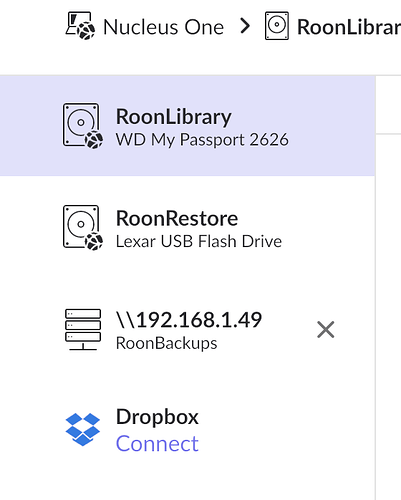

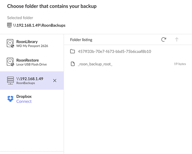

I was able to mount the Backup folder as a network share, and I was able to access it on the side panel, along with the Backup folder on the USB drive (see below):
However, when I select either folder to restore from, I get the same error message, just like before: “No backups found. Please check your backup location.” Just a further note, when I click on either of those folders (USB drive or network share), the file structure of the backup can be seen in the right-hand panel (see below):

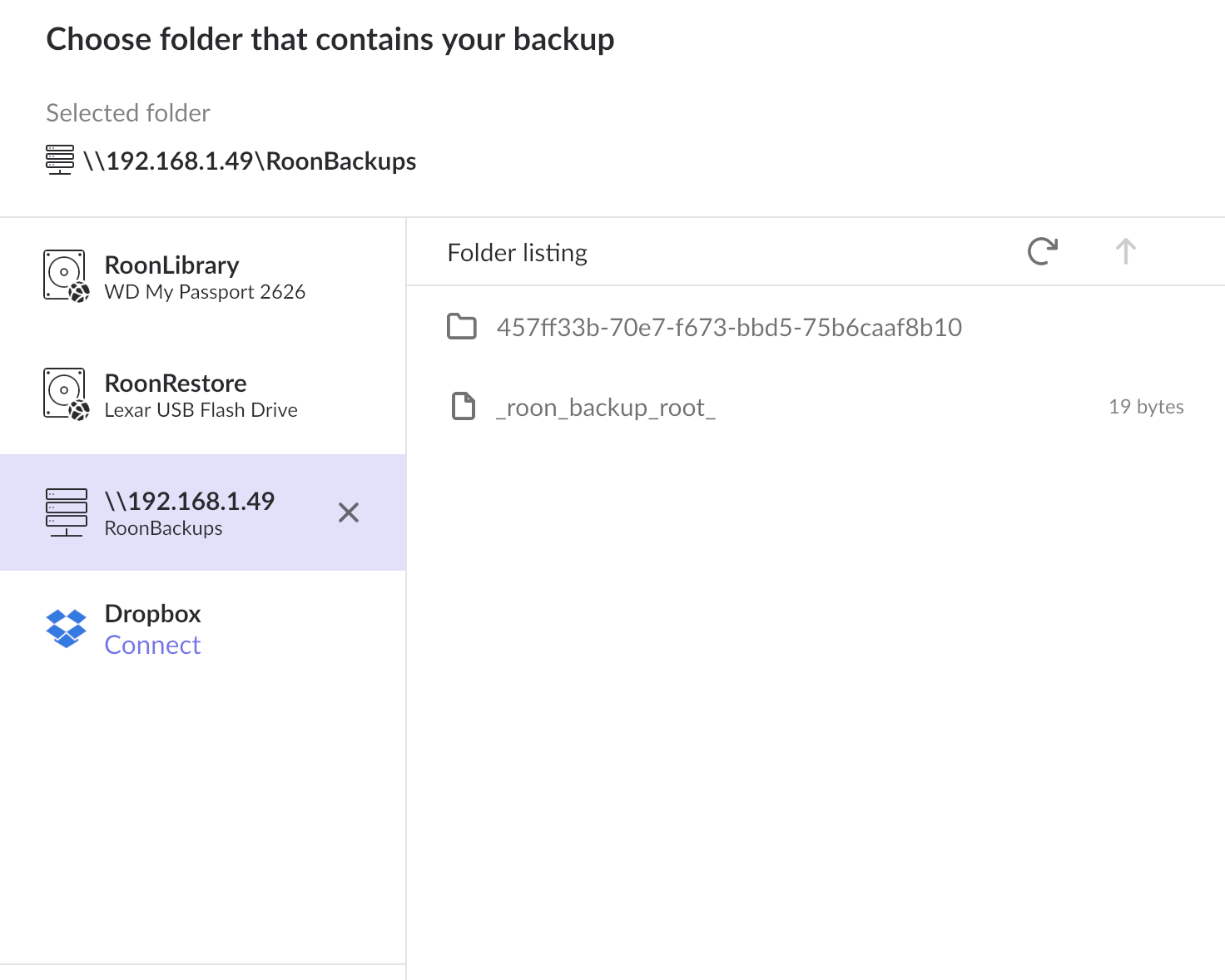

@Scott_Romans what does your “\\192.168.1.49\RoonBackups\” directory look like? I believe you are trying to backup from one folder too deep, instead of selecting just “\\192.168.149\RoonBackups\”.
Thank you, Robert. I get the same response whether I select just the network share or the folder that is in the first layer below the network share. Same for the USB drive.

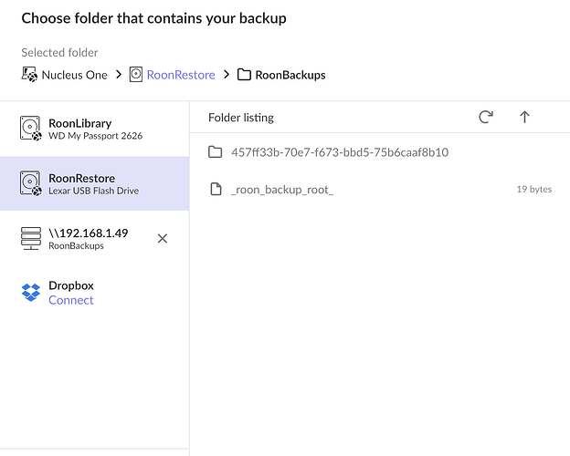

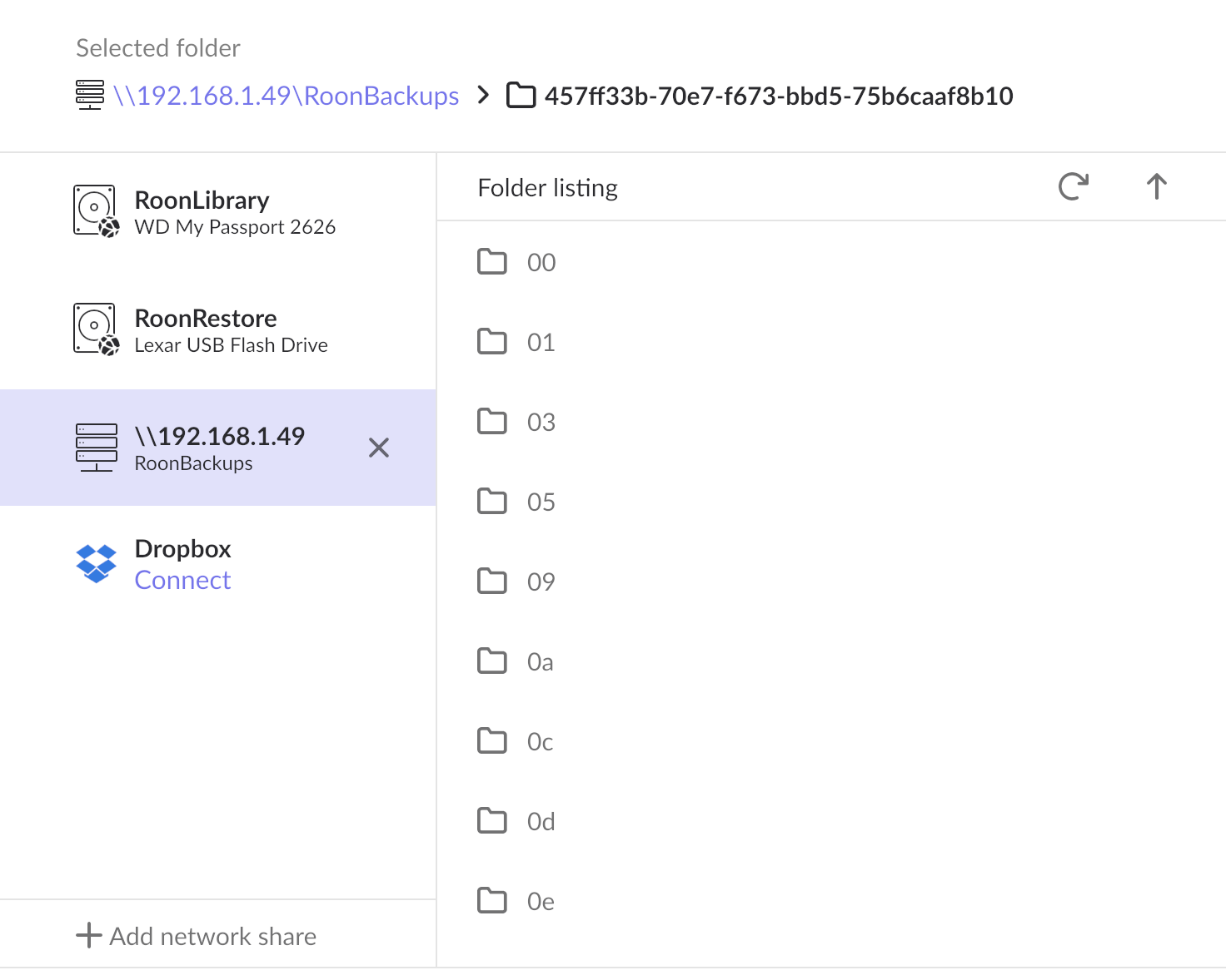

Let’s verify one specific thing: the folder you select in Find Backups must directly contain a file named roon_backup_root. That file is the marker Roon looks for - if it’s missing at the selected level, Roon reports “No backups found” even when the rest of the structure is intact.
So the expected layout is: the folder you point Roon at contains the roon_backup_root file, and next to it the alphanumeric subfolder (which in turn holds the short 00, 0a, etc. subfolders).
Could you check, on both the USB drive and the network share, whether the _roon_backup_root_ file is actually present at that level? When a backup gets copied between drives, this file occasionally gets missed. A screenshot of the folder contents in Finder, with that file visible, would help us confirm.
If the file is present at the correct level in both locations and the restore still fails, we’ll examine the archive you uploaded earlier and verify the backup’s integrity on our end.

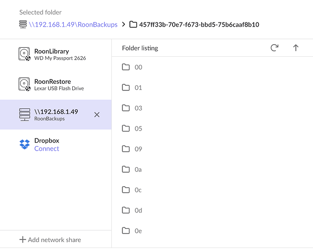

Yes, both backup locations have a file called “_roon_backup_root_”. Please see screenshots below:

Thanks for your patience through the hardware swap, and for the detailed screenshots, they helped. Now that the Nucleus One is online we pulled fresh diagnostics from it, and they let us narrow this down considerably.
The good news first: the mechanics of the restore are all working correctly. On both the USB stick and the network share, Roon mounts the location, reads it successfully, and finds your backup set, the roon_backup_root marker is being detected and the folder level you’re selecting is correct. So none of the things we’d normally chase here (drive format, permissions, pointing one folder too deep) are actually the problem.
The issue is one level deeper. When Roon opens your backup set and looks inside for the individual restore points, it finds zero of them, every attempt comes back “successful, but 0 backups.” In other words, the container is intact and the content folders (00, 0a, etc.) and the roon_backup/name files are all physically there, but the index that lists your actual restorable snapshots is empty or unreadable. That’s why re-pointing Find Backups at different folders never changes the result.
This almost always means the backup data itself was damaged or left incomplete, most commonly when a backup is copied between drives (in your case NUC → USB → network share → ROCK).
