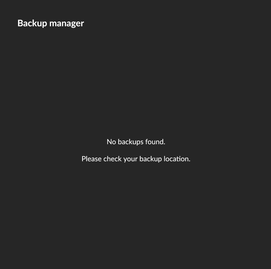

"No backups found" attempting to restore to DietPi NUC install. Backup originally created on ROCK.
I have moved from ROCK to DietPi (v9.18) roon server on the same hardware (NUC10i3). The DietPi install of roon is v2.56 (build 1582). The original backup from ROCK may have been roon v2.55 (build 1559).
Whenever I have attempted to restore the backup, I continually face "no backups found" message.

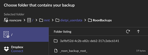

Hi @mookr,
This looks like it’s possibly a nested target folder issue.
The restore path Roon expects is the parent directory, /mnt/dietpi_userdata, not /mnt/dietpi_userdata/RoonBackups.
The screenshot from the Backups screen you’ve shared shows you’re likely one level too deep. The roon_backup_root file is a marker — it tells Roon “this directory contains one or more backup sets.” So when you point Roon at /mnt/dietpi_userdata/RoonBackups, it looks inside that folder for yet another roon_backup_root, doesn’t find one, and reports “no backups found.”
When Roon says “Choose folder that contains your backup,” you should instead pick the parent directory, not the …/RoonBackups nested folder.
Roon should then see the roon_backup_root marker and show your list of available Backups.
Please let us know if this helps or if you’re still having issues.

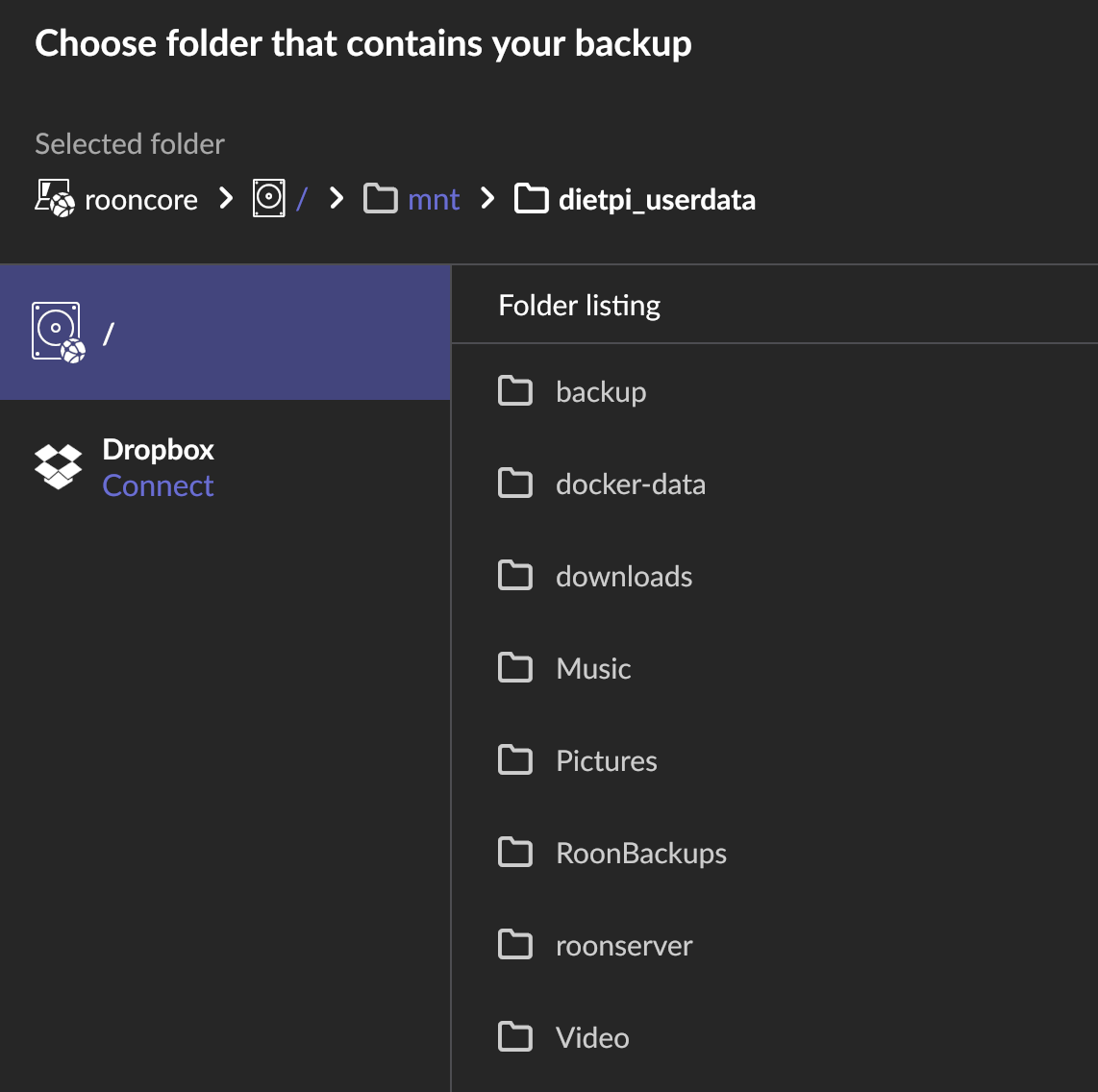

Hi @connor
Thanks for your reply. Unfortunately, I have the same result when pointing to
I should note: I am just attempting to restore. There has been no other backup activity on this system at this time.

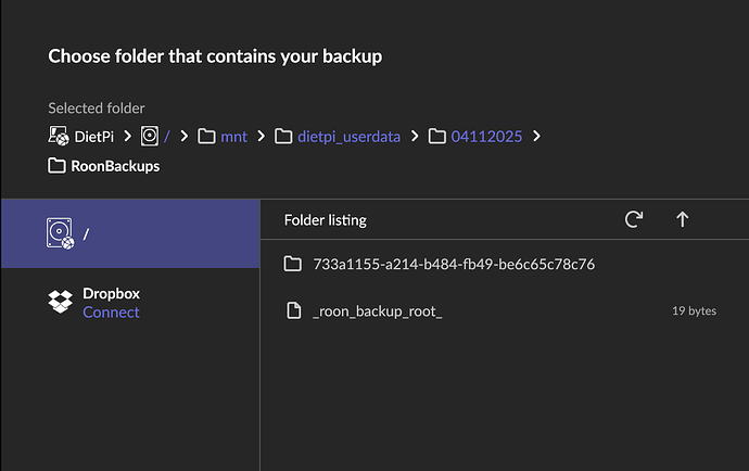

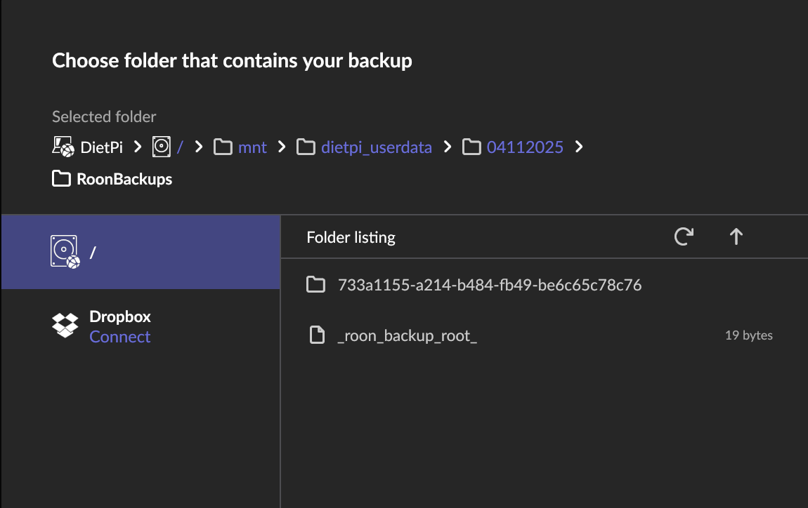

That is how my setup look like
Torben

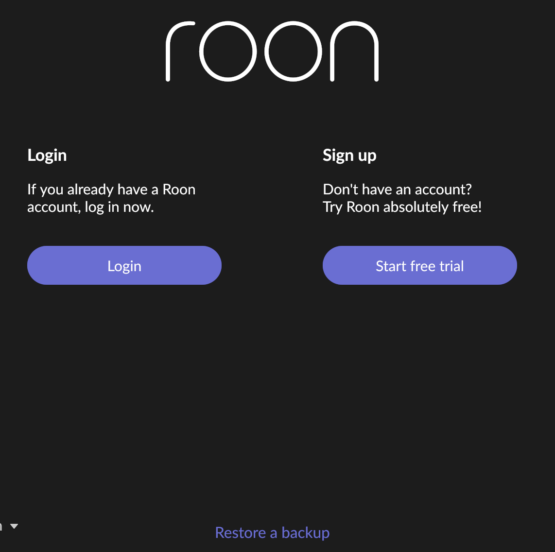

I decided to use the “Restore a backup” at the initial prompt vs. logging in. The result? The same as before: “No backups found.”
I’m starting to wonder: could the backup be corrupt? Are there any methods to validate a backup?
