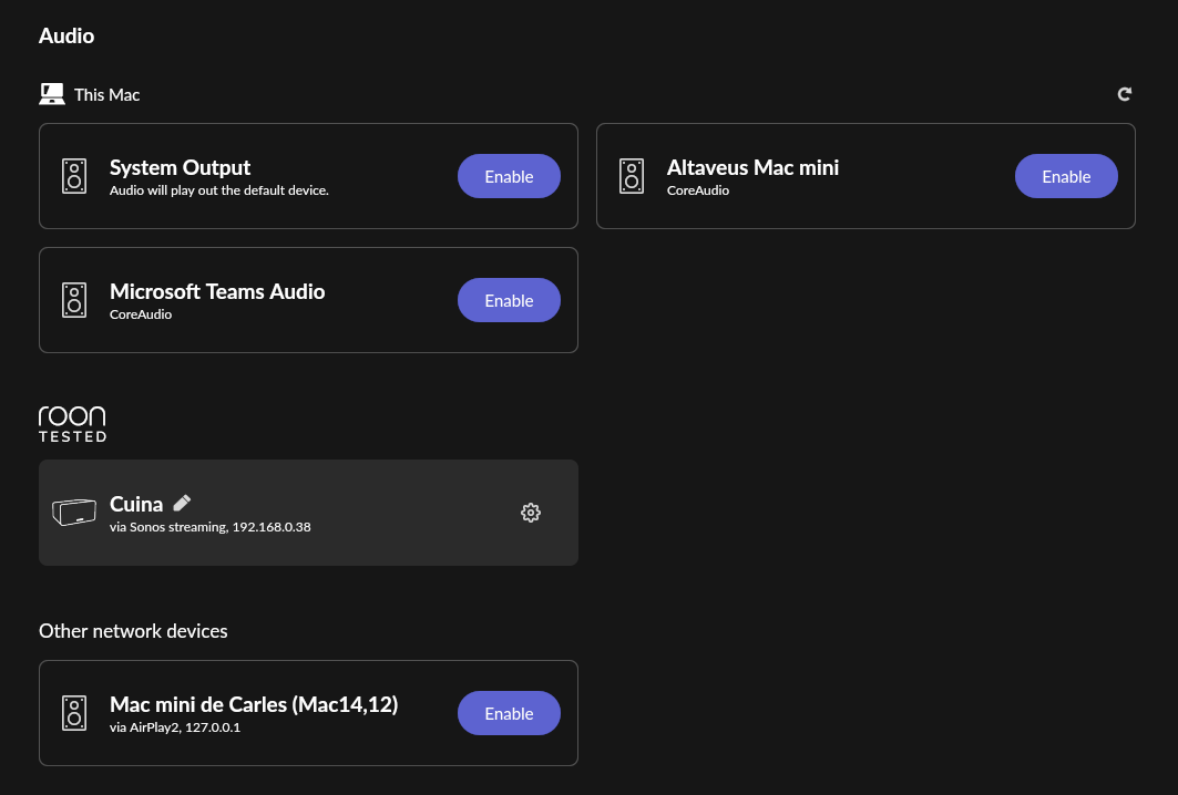

1.- Attached
I am unable to attache images. It appears the previous message.
In the screenshot only appera elements of my MAC (System Output, CoreAudio and Airplay).

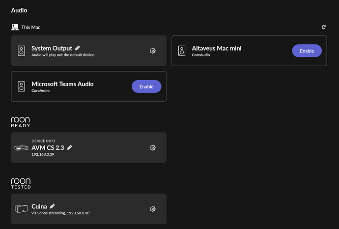

More Information: I just swich off and on the Roon application and now I can see the Amplifier but not the rest elements (TV, Chromecast, and other airplay devices).

I tried to follow your instructions and the problem “seems” to be fixed. However, not all the Roon the devices are visible in Audio section.
I tried to reboot the Mac several times and apply the same solution but only 1 or 2 devices are visible. Fortunately the AVM device was always visible doing the setting change.

Hey @Carles_Borrego_Bel,
What devices are you referring to specifically at this point? Just the AVM, or are you expecting to see additional devices? I see a sonos device based on one of your screenshots as well.
Did all the devices always show up properly until you updated your Mac to Sequoia? If you haven’t yet, I’d also review your Mac firewall settings - test out temporarily disabling it and restart Roon. Let me know if your devices show up properly :+1:
