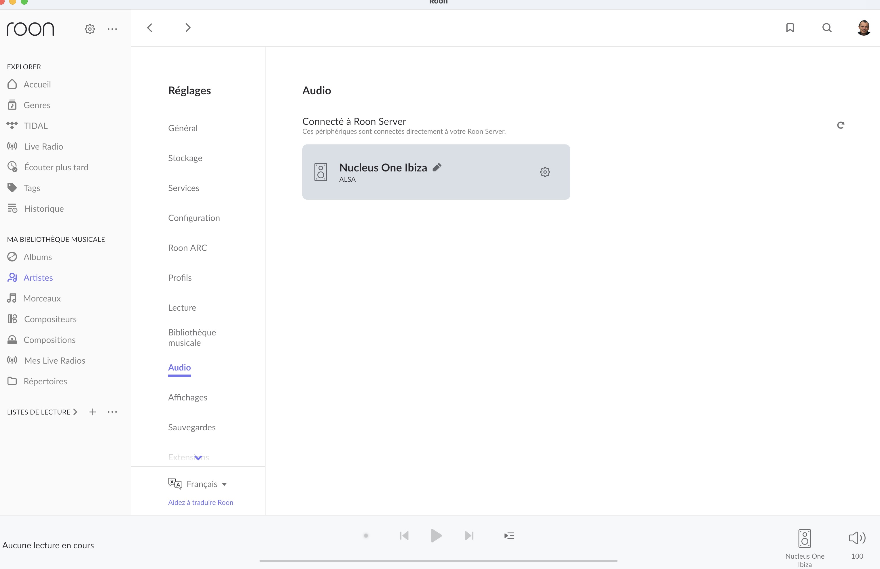

I can't connect Audio because i don't see any of my audio output
MOVISTAR-WIFI6-CFEO WPA2-PSK
Hello @Philippe_GIRAULT,
Thank you for reaching out to Roon support and welcome to our community!
Could you kindly provide some additional details about which exact audio devices are not visible in the sound tab?

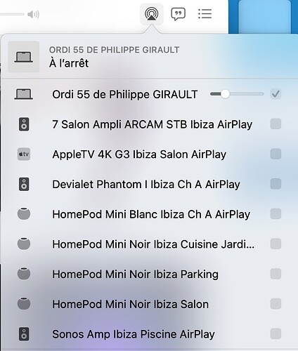

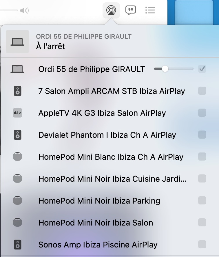

Roon is already enable on my Mac and off/on and reboot change nothing
Here are the Audioi devices I want to Add (they are on Airplay)
  • Devialet
  • Sonos
  • Arcam
Add images

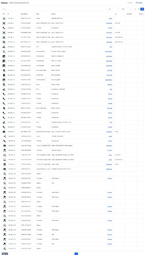

Yes I need help to know which device is acting as the extra DHCP server
Hi @Philippe_GIRAULT,
From your posts above, you have both a MOVISTAR and a Mikrotik router in this setup. This is more than likely the issue, since both routers will be broadcasting a primary subnetwork over WiFI to which the Roon devices relying on WiFi can connect.
I recommend placing the MOVISTAR router in Bridge mode or equivalent. This should be available in the settings - it’s often called “IP Passthrough” if you don’t see Bridge mode.
