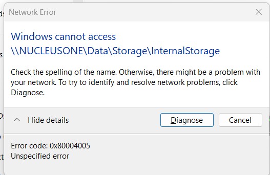

In the article you referred to I was supposed to navigate to \NUCLEUSONE\Data\Storage\InternalStorage. If I navigate here
If I replace \NUCLEUSONE with \192.168.1.72 I get the same error.
I never get to a dialog to enter a password. The error code is a generic unspecified error

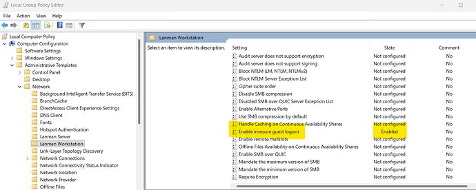

It seems to me that you have not implemented the troubleshooting steps to address the tightened security of Windows 11 that are given in the article.
Indeed I have. I edited the Group Policy. It should not be this difficult for something this expensive. When the Roon server was on my computer I had all the functionality I needed. Honestly, this is a terrible customer experience.
Well, I would check that you have done it correctly, or perhaps some of the other things you have tried are preventing the connection to the Nucleus One. And BTW, this issue is of Microsoft’s doing, not Roon Labs…

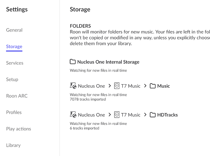

And, I’m able to play music off the USB connected to the NucleusOne. As you can see, the internal and external storage are present. I cannot however access the internal/external storage with the File Explorer making at least the internal storage impossible to use and the external storage difficult because it need to be disconnected, reconnected to the computer for management and then reversing the process
Yes, as shown, the Nucleus One is behaving as expected. The issue is that Windows 11 is refusing to connect to the Nucleus One using SMBv2. This is now the default behaviour of Windows 11 since Microsoft tightened network security in Windows 11 a few months ago. You have to enable insecure guest connections in Windows.
The steps shown in the article I referred to should be all that is necessary. I don’t know why they apparently do not work for you.

I had read the article thoroughly and completed all the steps, including the group policies
Then it’s possible that something you did earlier before doing the two steps in the Group Policy Editor is causing a conflict in the Registry. Suggest you raise a formal Support Request.
Did you reboot Windows after making that change?
And because it’s not visible in the screenshot: be sure that you set the policies in both required places
