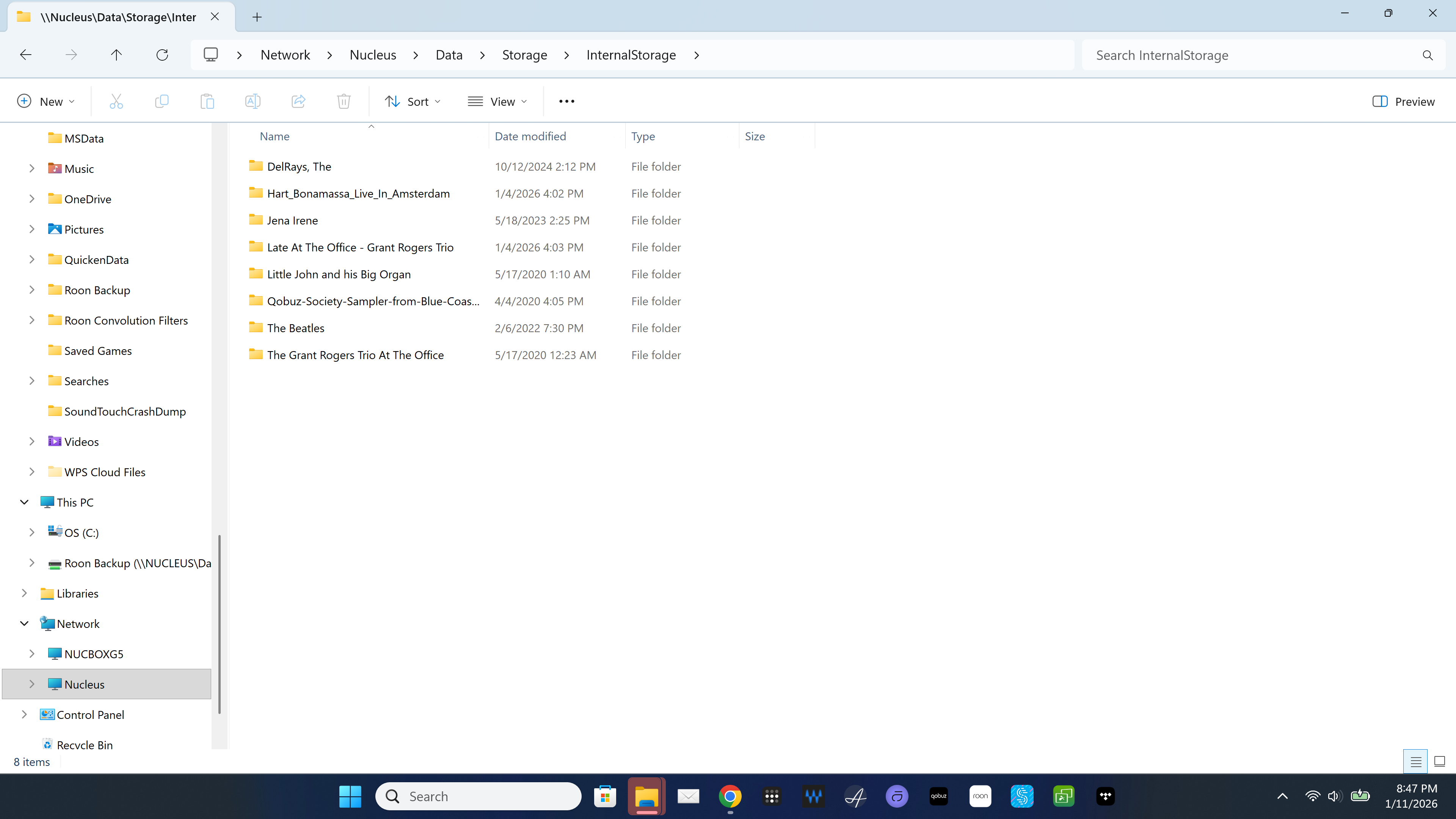

This is exactly what I want. I finally figured out how to use an external drive (tiny memory stick) for saving backups, but my library is on a second external HD connected to the other USB spot on my Nucleus, and I need to move the music files from ther to the internal SSD u installed in the Nucleus.
I pulled the watched external HD off the nucleus and plugged it into a Mac. I was actually able to see the Nucleus and its drives, including internal drive, as a pert of the network and dragged and dropped the music files. It’s currently transferring and Roon is detecting them as that number is increasing. Says it’ll take another 2 hours. Fingers crossed!

Thanks for the update — it’s good to see that you were able to access the Nucleus over the network and start copying the music from the external USB drive to the internal SSD.
Once the copy completes, Roon will automatically import the files from the internal storage and you can disconnect the external USB drive if you wish.
