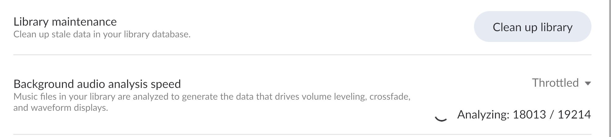

The background audio analysis speed was already set to throttled.
However there is a spinning wheel in that section and it seems frozen at 18013/19214
