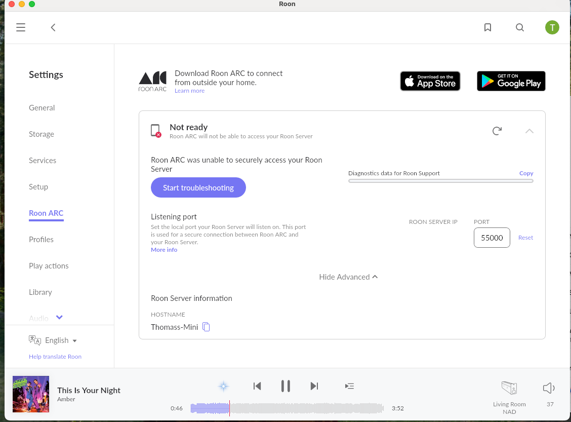

I am able to connect to my Roon server via ARC however I am unable to stream any of my tracks. My music library is shown in the app and I can download albums but can't stream. The server indicates that ARC is not ready.
Roon server: Mac mini M4, Gateway: Ubiquiti Dream Machine Special Edition, Switch: Ubiquiti USW Ultra, Router: TMobile 5G. Mac is connected via ethernet through the Ultra to the Dream Machine.

Are you attempting to use Arc through port forwarding or through Tailscale? If you’re using tailscale, you won’t want a specific port number in your Roon Settings>Roon Arc, you’ll want to set the number to 0. Here’s more info on Tailscale :

However, you will need to ensure that the port assignment is set to 0 Settings → ARC, to prevent RoonServer from attempting to rely on the failed port forwarding that has been automatically configured.

Looks like updating the port assignment to 0 fixed the issue. Really appreciate the assistance!
