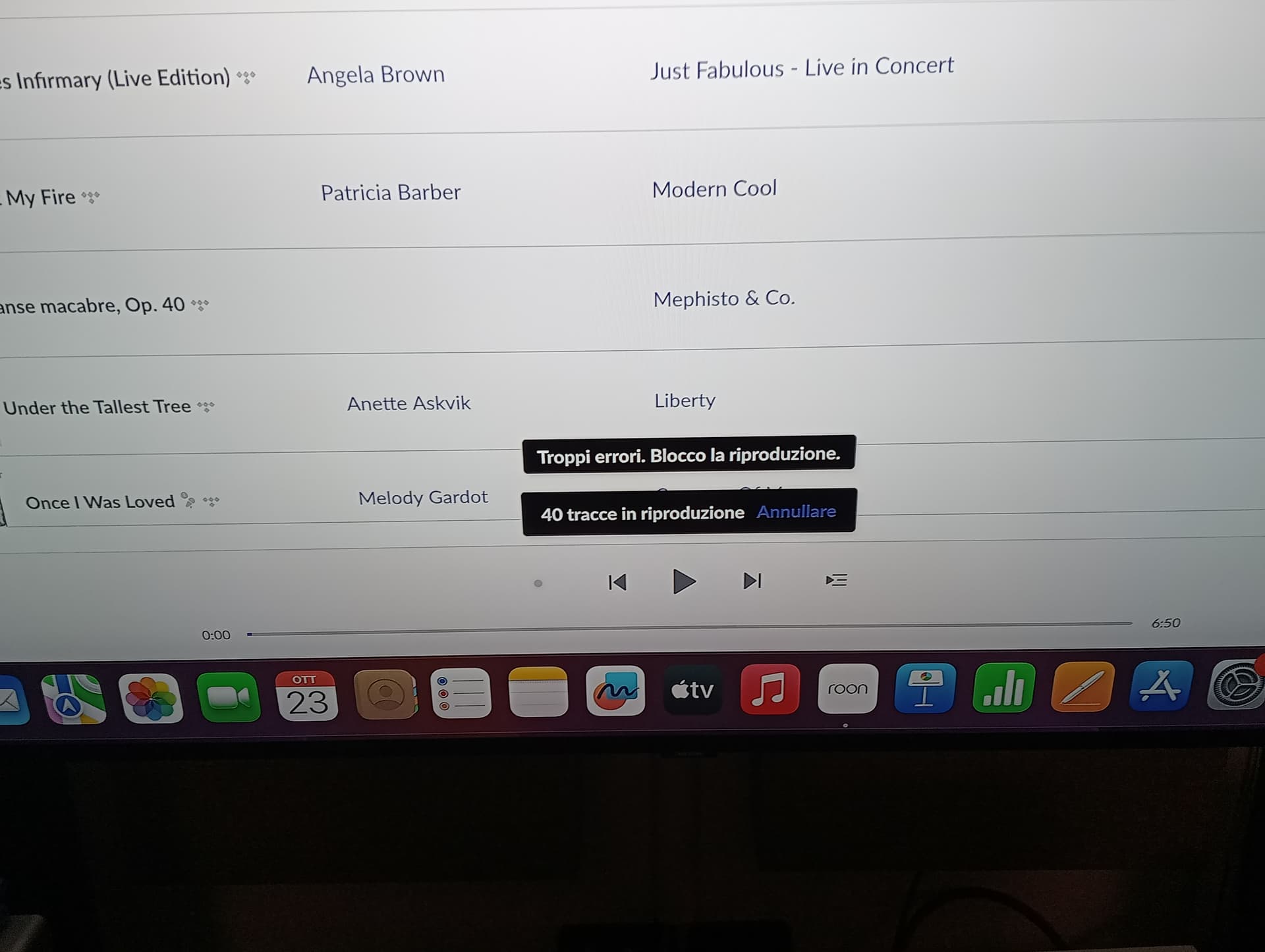

Hello, I followed the steps described and now I can no longer listen to Tidal. Roon says there are too many errors and stops playback. The Tidal library is displayed but not can’t reproduce anything. Can you please help me? I’m frustrated. Thanks

I have regular access to the Tidal service but cannot play any songs. I have restarted the router but to no avail. I do not have any firewall or VPN on the Mac Mini. The problem has arisen since I I followed the procedure you indicated by moving the cachet folder to the desktop. Something must have gone wrong during that operation. From that moment on, there is no longer any possibility of enjoying music from Tidal.I attach the images of the errors for completeness. I sincerely hope that it can be resolved soon
