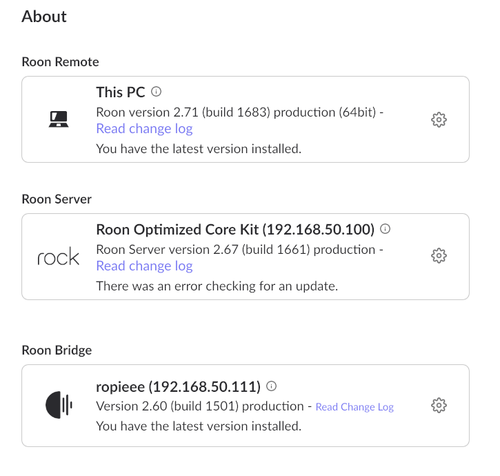

Unable to update ROCK to 2.67 build 1661 on NUC (ref#8EPDS9)
· I’m stuck on 2.67 (build 1661)
I keep getting an error when trying to update ROCK trough ROON Windows
I tried different browsers
I tried reinstalling OS in web interface, which btw doesn’t reinstall
I tried restarting server
Running ROCK on a NUC with only ROCK installed
· Everything is working fine, never had any trouble updating before.
Fiber in
Asus RT-AX86U router
Standard TP-Link non config Switch
No VPN
I have ADGUARD home, but tried disabling it as well
Have a Samsung Galaxybook 360 pro
so it is INTEL NIC
