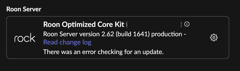

· Running Roon server on ROCK intel Nuc based system. Unable to update to latest version. Running System: Roon Server version 2.62 (Build 1641) Production, Roon OS version 2.1 (build 271) production, OS Version Roon 2.1 (build 271) production, HW: Intel NUC NUC10i7FNH I7-10710U UHD Graphic 32GB RAM, 252 GB SSD

Thank you for the Tailscale clarification. Regarding the update same behavior. I’ve proceeded with the suggested reinstalation (twice actually) and not only does it show up on the same version of when I reported the ticket, but receive exactly the same indication via roon client GUI (Update available, unable to update).

Our servers seem to indicate the ROCK remains on an outdated build. Have you tried the database refresh per the steps above? Please share a screenshot of the RoonOS web admin page when you have a chance.
Hey, @Helio_Jesus,
Just checking in on this before the thread auto-closes. Were you able to try the database refresh on the ROCK and share a screenshot of the RoonOS web admin page? If you have any update, let us know when you can, thanks.
