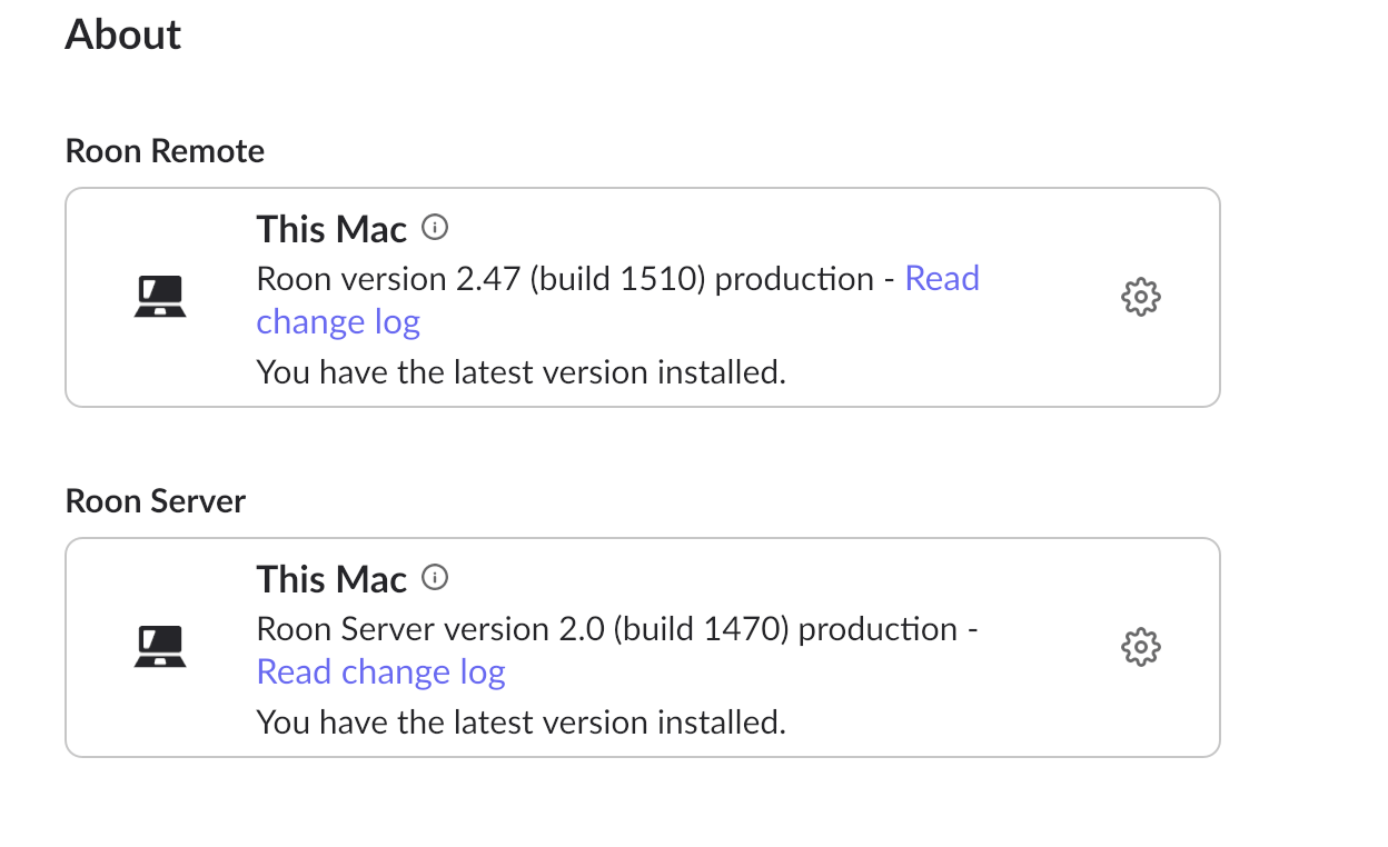

I am unable to upgrade to the latest software version. Currently on Roon Server Version 2.0 (Build 1470). When I try to upgrade it says: "There is an update waiting to be downloaded." I click to download it, it says it's downloading the update, then the following message pops up: "There was an error checking for an update."
I'm running Roon on a 2024 Mac Mini, Apple M4 Pro chip and Mac OS Sequoia 15.3.1

I noticed that your server is more than one version behind. Did you just notice this issue with updating recently?
Daniel:
I followed your instructions and… IT WORKED! One question: is it safe to delete the “ROON_OLD" and "ROON SERVER_OLD” files now? They’re fairly large at about 3 GB total.
You asked if I just noticed that the version was out of date. Yes, I was reading about OPRA in an email, so I went to try it and found that feature didn’t exist. That’s why I looked at the version, and tried to update the version to Build 1510, but ran into issues. Note: automatic updates WAS tuned on.
