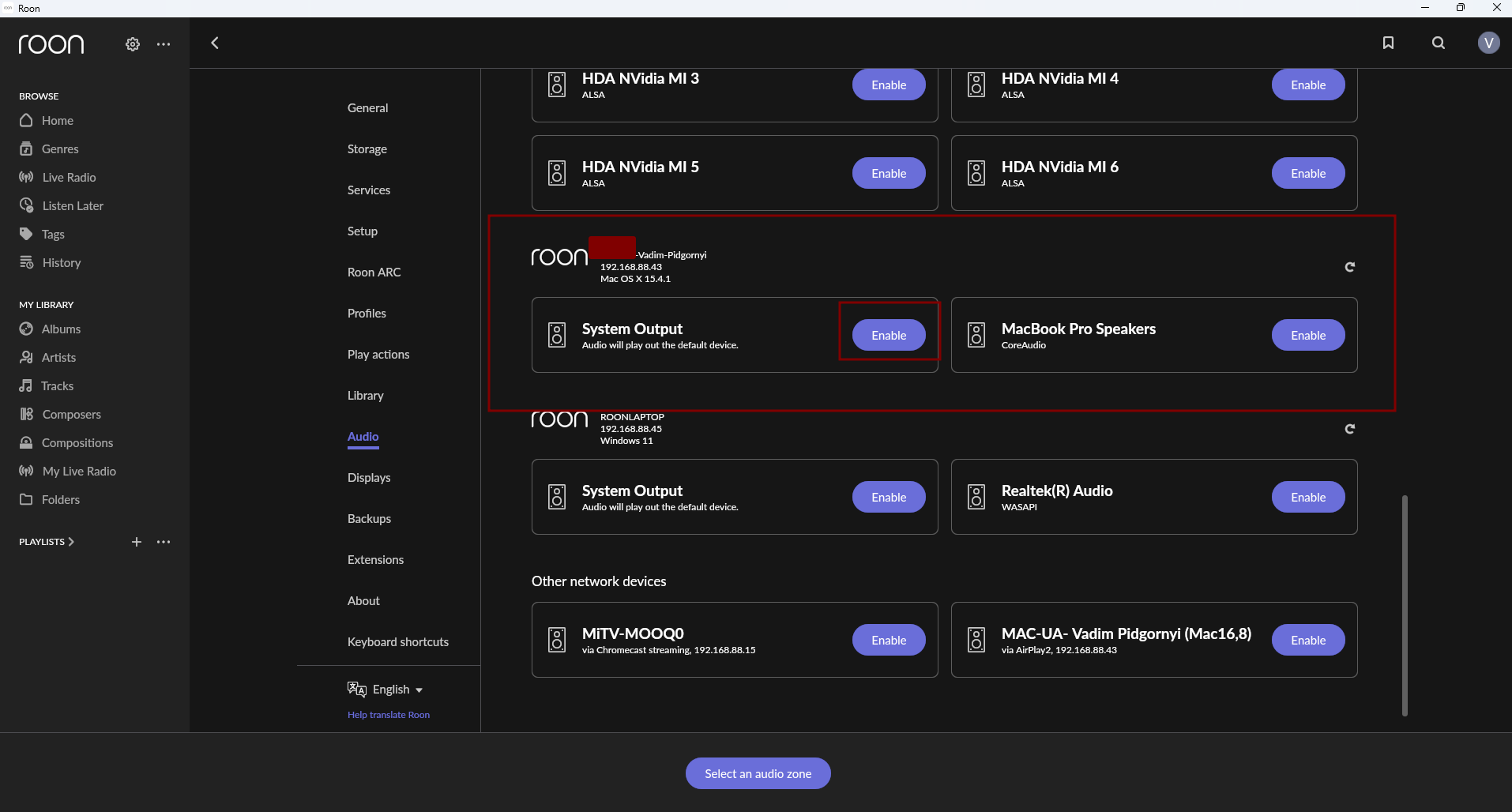

Additionally, could you please confirm that LAN access is allowed for the Roon app on both macOS devices? You can check this under System Settings > Privacy & Security > Local Network, and ensure Roon has permission
Here’s a screenshot for reference — my Roon Server is running on a Linux machine, and I’m controlling it from a Windows device while successfully using a macOS laptop as the audio output.
Let me know how it goes
