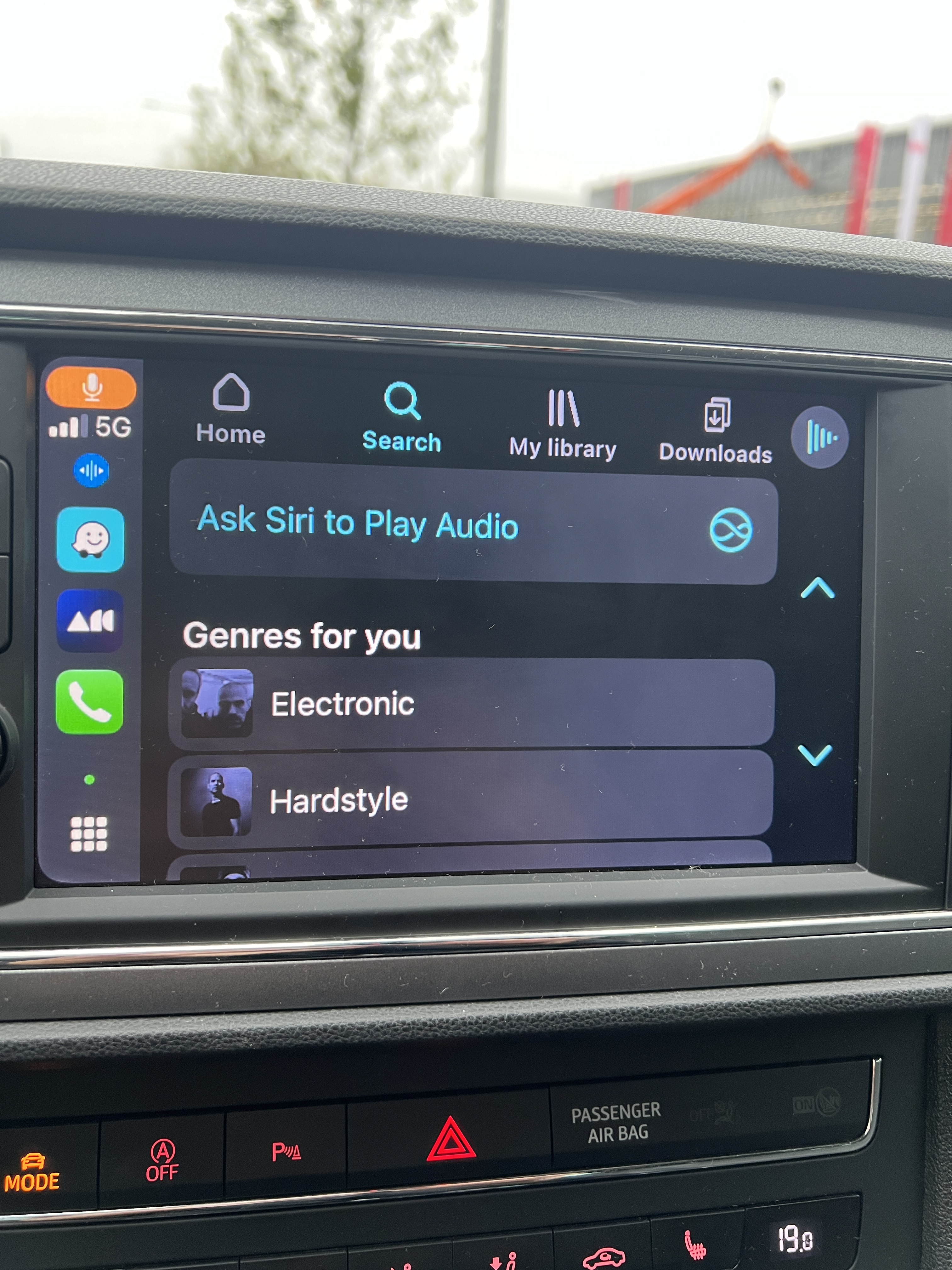

Similar issue here. Also when standing still, parked or even with engine off.
iOs 18.0.1
CarPlay
Head unit SEAT 5F0919606.
See picture from being parked.
@roon: so it is obviously not only affecting my head unit
Hi @Michael_Klug,
We’ve investigated this case thoroughly with development. There is no command from ARC instructing the head unit to disable the keyboard utility; it’s not something that’s ever been implemented in the current or previous version of the app.
Keyboard functionality - including any conditional disabling - is entirely controlled within the head unit firmware. Please verify if there are any driver profiles or settings within your specific head unit that might have control over keyboard access.
Development will investigate whether we can add any conditional logic to ARC that would request the head unit to keep keyboard access enabled. This would be something we’d likely have to implement on a case-by-case basis for affected head unit models. It may take some time to implement any potential future changes here. This thread will remain open in the meantime to track the ticket, but we can’t guarantee a fix in each case.
Since you’ve already provided your head unit firmware, there are no additional technical details we require at this time. @Synthex, we’ll also investigate the model you’ve provided.
Thanks for getting back to us @connor.
The one thing I can verify is that the driver profile isn’t affecting keynoard availability, since that function is accessible on Waze in the same scenario.
