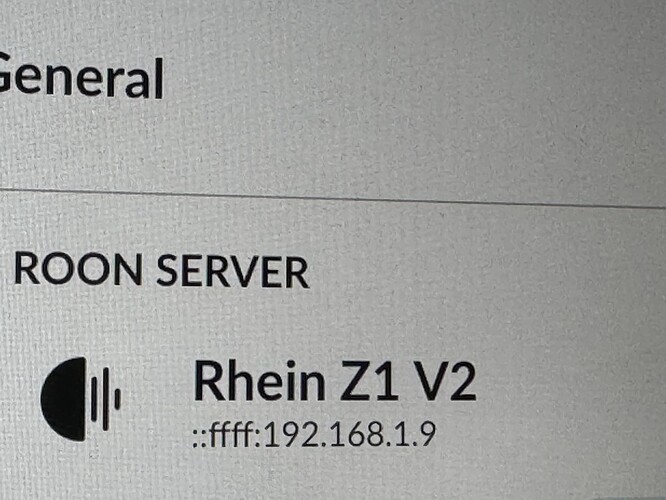

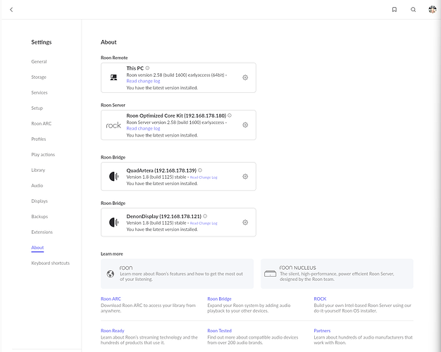

That seems to be a partial photo of the General screen instead of a screenshot of the About screen. It should look something like this…
(I’m using a Roon Server on a ROCK/NUC system)
Please try again.
Thanks to help Geoff, this you mean?

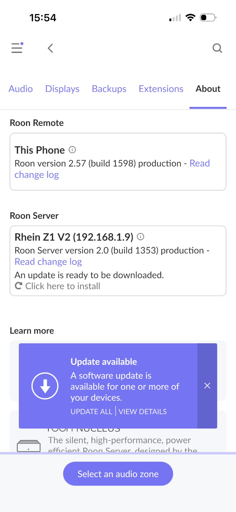

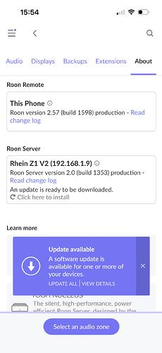

this with my iphone
Well, that just confirms it - your Z1 is running a very old build of Roon Server (1353) - the current build is 1598:
I suggest that you contact Silent Angel support to find out how to install current versions of Roon Server onto the Z1.
Personally, I very much doubt whether Silent Angel will ever reach a deal with Roon Labs to licence the Z1.
Have you tried clicking update all? Seems very strange if Silent Angel does not support the standard roon update process. Roon releases are very frequent, and roon will eventually break if not kept up to date.
That could be a solution, that should be a solution.
When i try to update the 1353 it always gives an error on checking for an update.

What’s the error?
When i click to update it is downloading, then it goes to installing, after about 30 seconds it says: there was an error checking for an update
