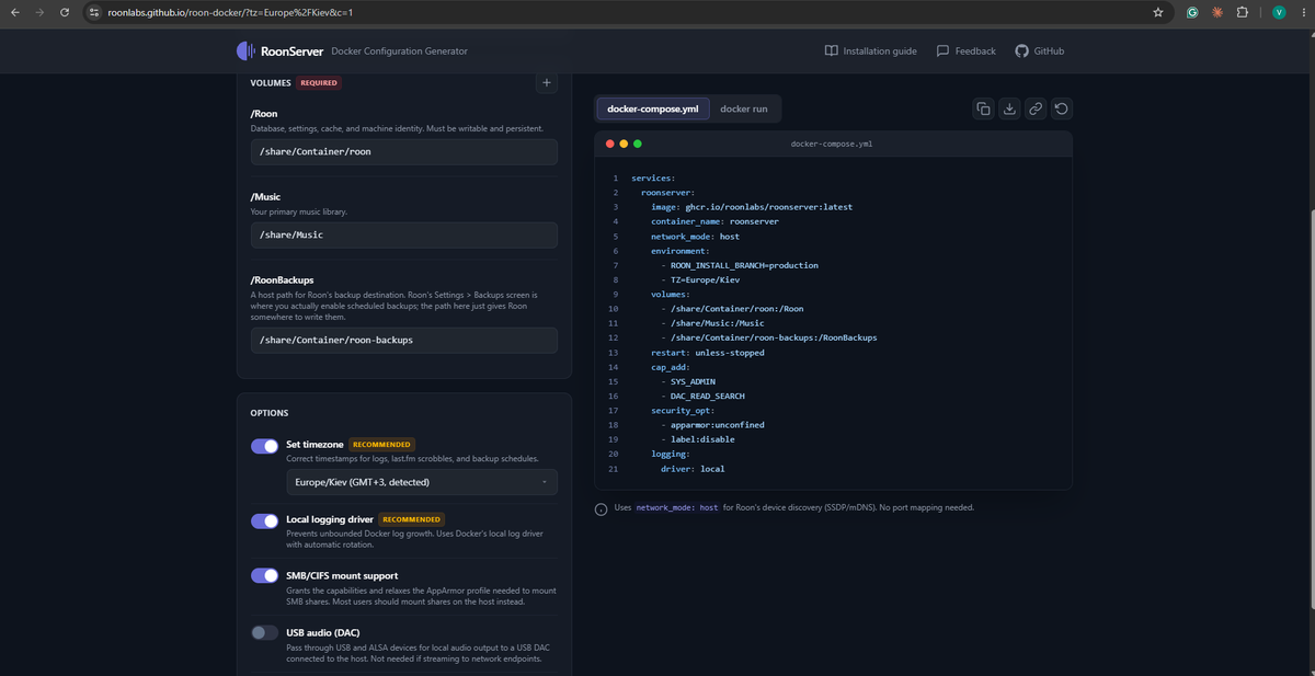

Would you kindly confirm that you have enabled the SMB/CIFS mount support during the container deployment?
Your configuration file should contain the following:
 cap_add:
 - SYS_ADMIN
 - DAC_READ_SEARCH
 security_opt:
 - apparmor:unconfined
 - label:disable
This looks to be like the port (:8080) for your your NAS’s web administration interface. Please don’t include a port number for an smb:// URL.
