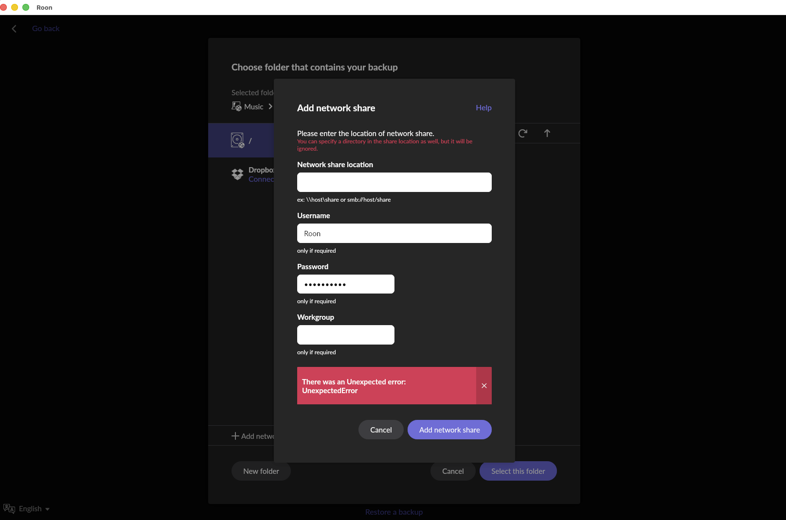

· I need to restore my Roon backup after installing Roon in Container on a QNAP NAS (called "Music"). Installation was successful (Roon running in Container). I would like to restore a backup however I receive a "There was an Unexpected error: UnexpectedError" message.
I believe I am incorrectly entering the Network share location in the "Add network share" to identify the folder that contains my backup and would like assistance.

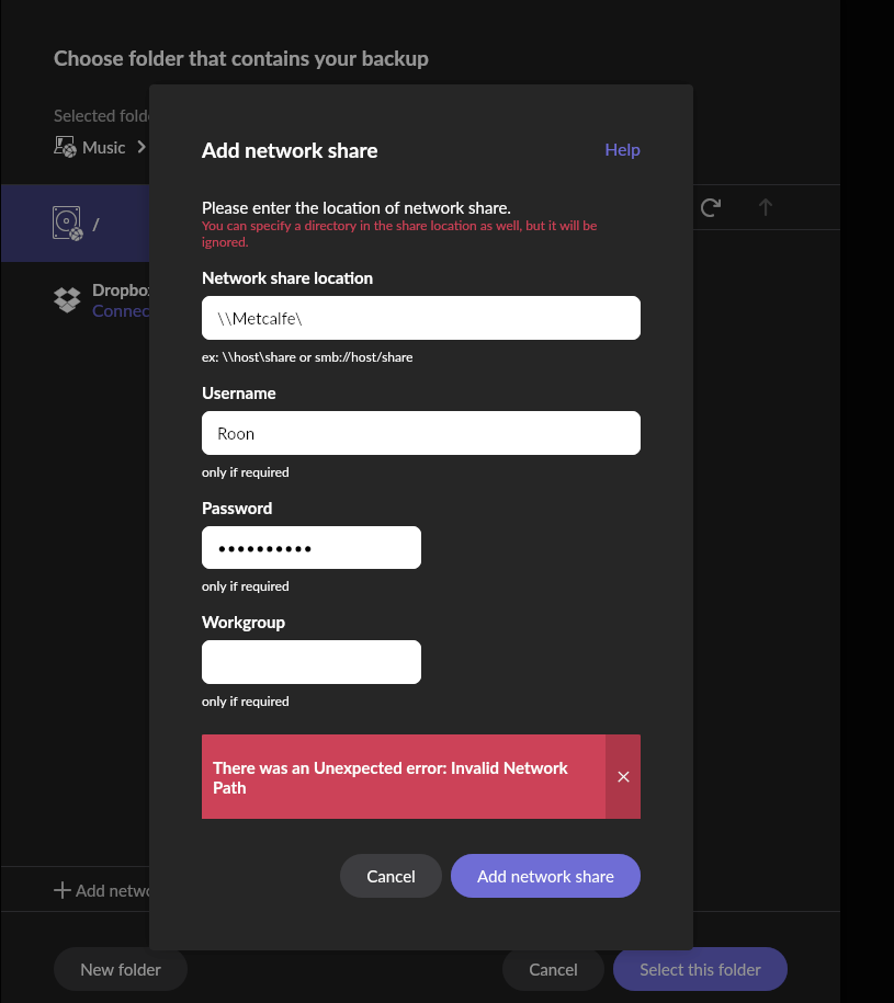

Difficult to say because your screenshot doesn’t show what you entered

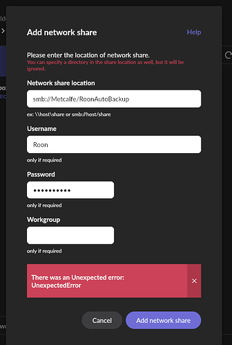

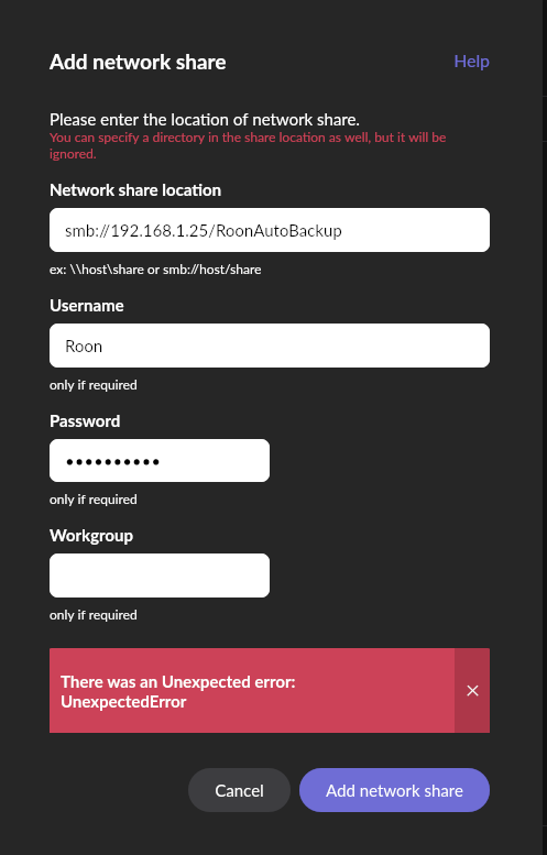

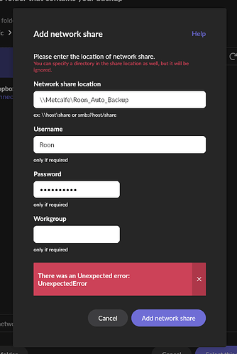

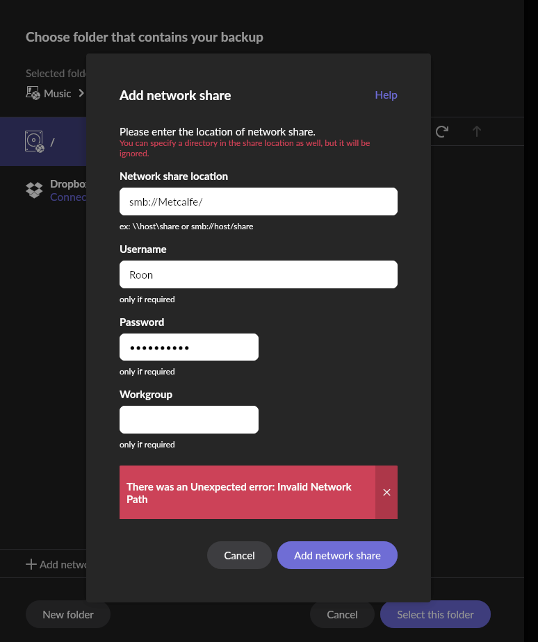

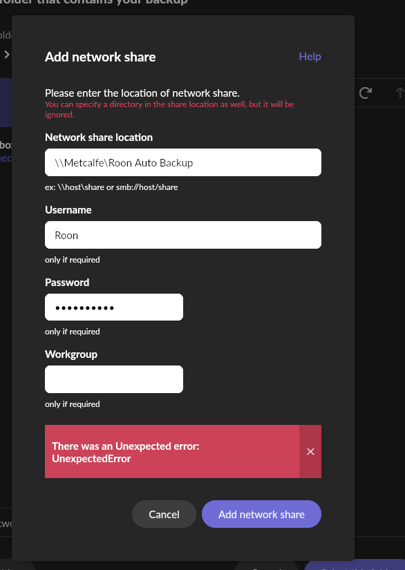

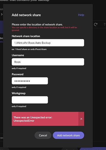

Here are the variations I’ve tried. Thanks for the help.

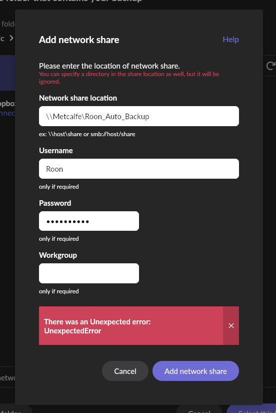

The errors are different between the different cases. I’d start with finding out what your shared folder name really is. You wrote:
But then you tried “Roon_Auto_Backup” with underscores in some of the screenshots. I suppose you tried it that way because you were out of ideas :slight_smile: but if “Roon Auto Backup” is correct, “Roon_Auto_Backup” can’t work.
If “Roon Auto Backup” is correct, the spaces might get in the way. Spaces in network share names are problematic. You may have success if you try it WITH the quotes, exactly as “Roon Auto Backup”, but you might be better off by eliminating the spaces in the share name to begin with.
I’d also go with the smb:// notation, because this is what Linux-based OSes like QTS usually use, while the \\ notation is a Windows thing.

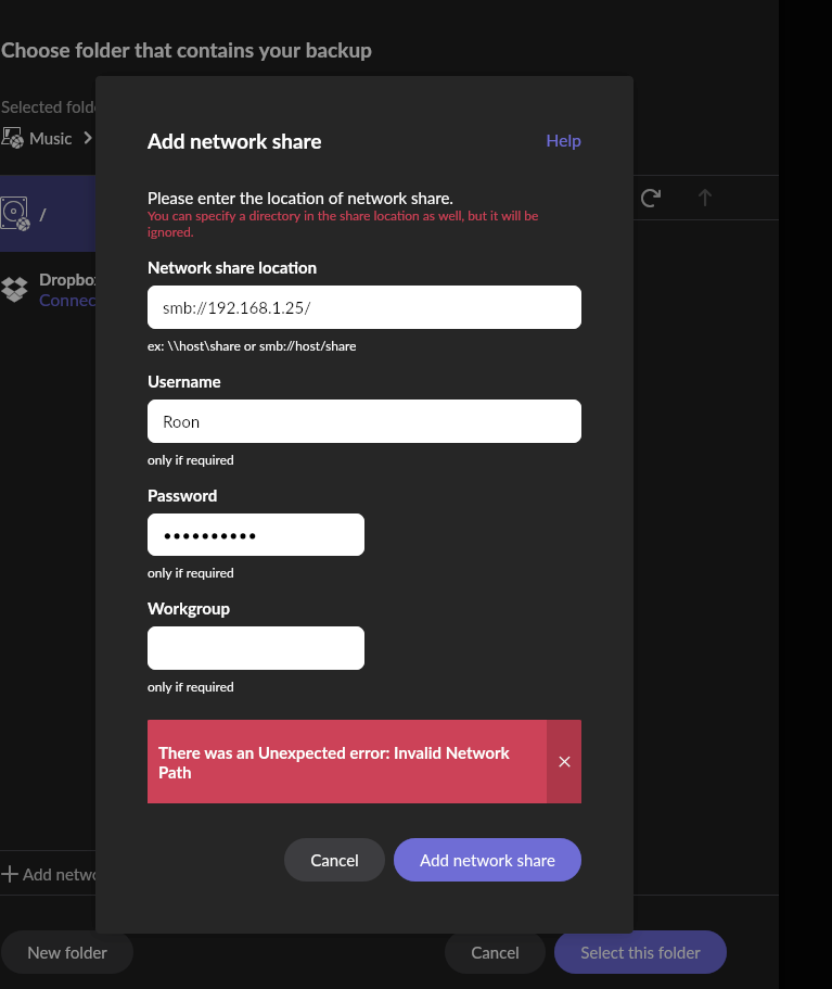

Finally, in some attempts you left out the share name altogether and got an „invalid network path“. You HAVE to include the share name.

Als tried this:
Still no luck. Interesting, the NAS doesn’t report any attempts to login using incorrect passowords, etc.

And yes, you were correct…I tried the underscoring after initially trying with “Roon Auto Backup”.

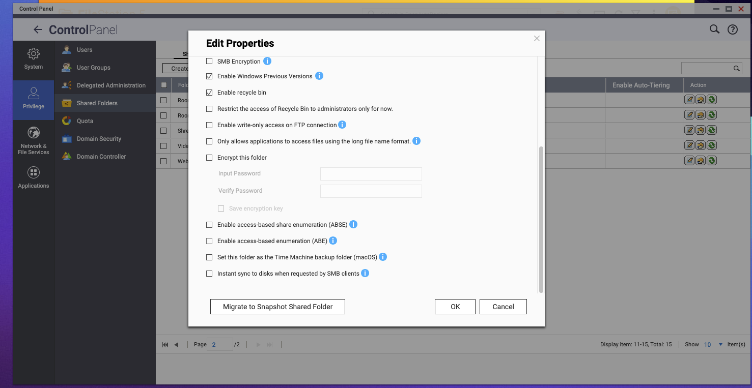

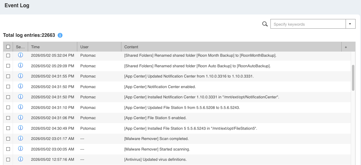

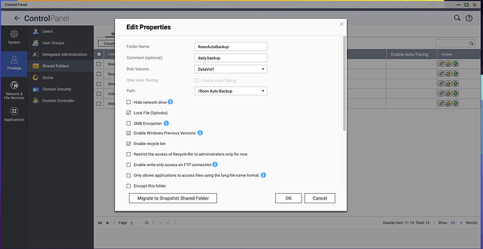

Here are screenshots of the share properties for the folder “RoonAutoBackup”. I see that even though I changed the Name to eliminate the spaces, the Path remained with the spaces. Could that be an issue?
I would prefer to get this addressed because I use QNAP’s HBS 3 to automatically backup up my “Music” NAS to both an attached USB drive and to “Metcalfe”. And Roon backs up to “Metcalfe” which in turn backs to a USB attached to “Metcalfe”.
Perhaps. You could also create a completely new share without spaces and try if you can connect to that. If you can, copy the folder that contains the backups into that

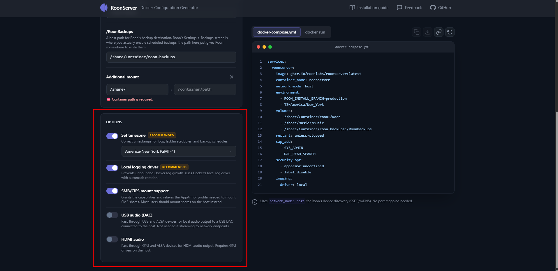

And when you created the container, did you follow the official guide? And if yes, did allow the container to use SMB shares? Also, if the backups are on the same NAS you better change the backup path you setup when creating the Docker Application to match the backup path. Or simply copy your backup(s) into the new backup folder.
I followed the official guide. Only thing I changed was where my music was located. It’s in the “Music” folder under the shared folder “Multimedia”.
I’m not a techie so I missed the option? to allow the container to use SMB shares. It would be helpful to know where that is one when creating the application.
Along the same Iines, my Roon Server app was located on a flash drive attached to my “Music” NAS that contained my FLAC, DSD files (and on which the Container operates). Is it possible for the container to use that as the place for the new version of Roon? Or does the new version have be stored on the NAS drive itself? If I can set up the new version to mimic my old setup, it would be ideal so I can take advantage of the speed of the SSD rather than the hard drives. on the NSA.
Thanks in advance of your help and @Suedkiez .

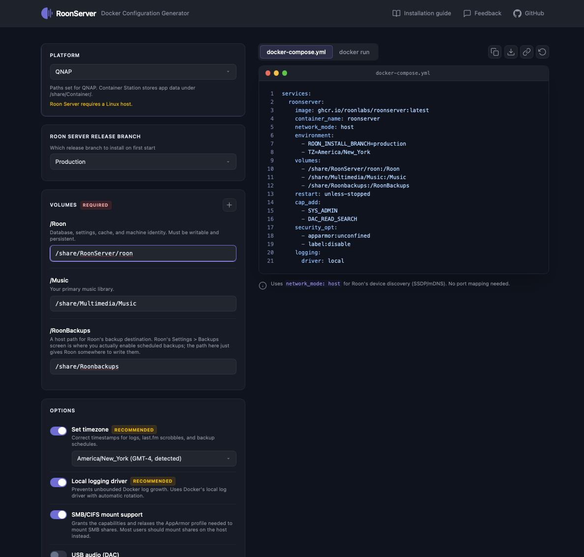

Picture from the official guide.
You already changed the second path for /Music to point at your library. So just change the first path for /Roon to point at your SSD.

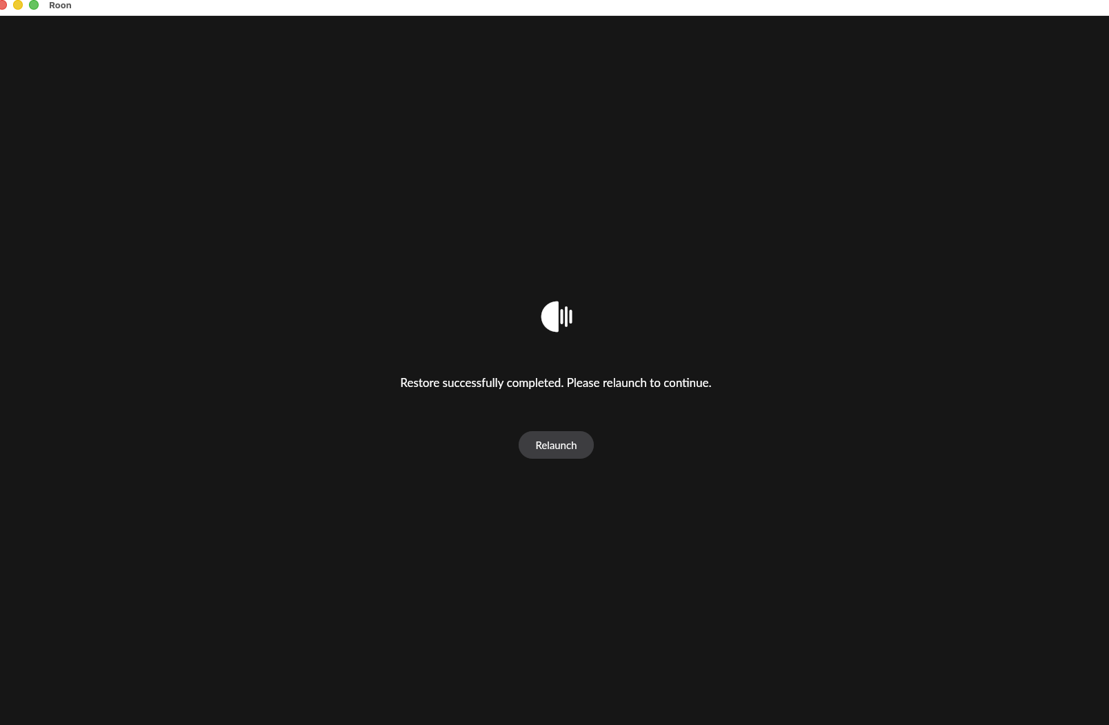

Once Roon started, I was able to access the new “Roonbackups” shared folder on the “Music” NAS drive and restore the backup.
Unfortunately, after Relaunching, I was back at the screen asking if I wanted to Login or Signup or Restore a backup. Because I was expecting that Roon would start on my Home page, I selected to Restore a backup.
The second time around I got wise and selected to Login. At that point I ended up having to deauthorize the prior Login and Roon launched perfect.

@Cosmic_Encounter As Pacoinmass and Roger_Morrow confirmed above, the way out of this loop is to select Login instead of “Restore a backup” after the initial restore is complete.
When you do this, Roon will prompt you that your license is already in use. Simply select the option to Deauthorize your previous native QNAP core. Once you deauthorize it, your new Docker instance will take over the license, and you will be taken straight to your Home screen.
