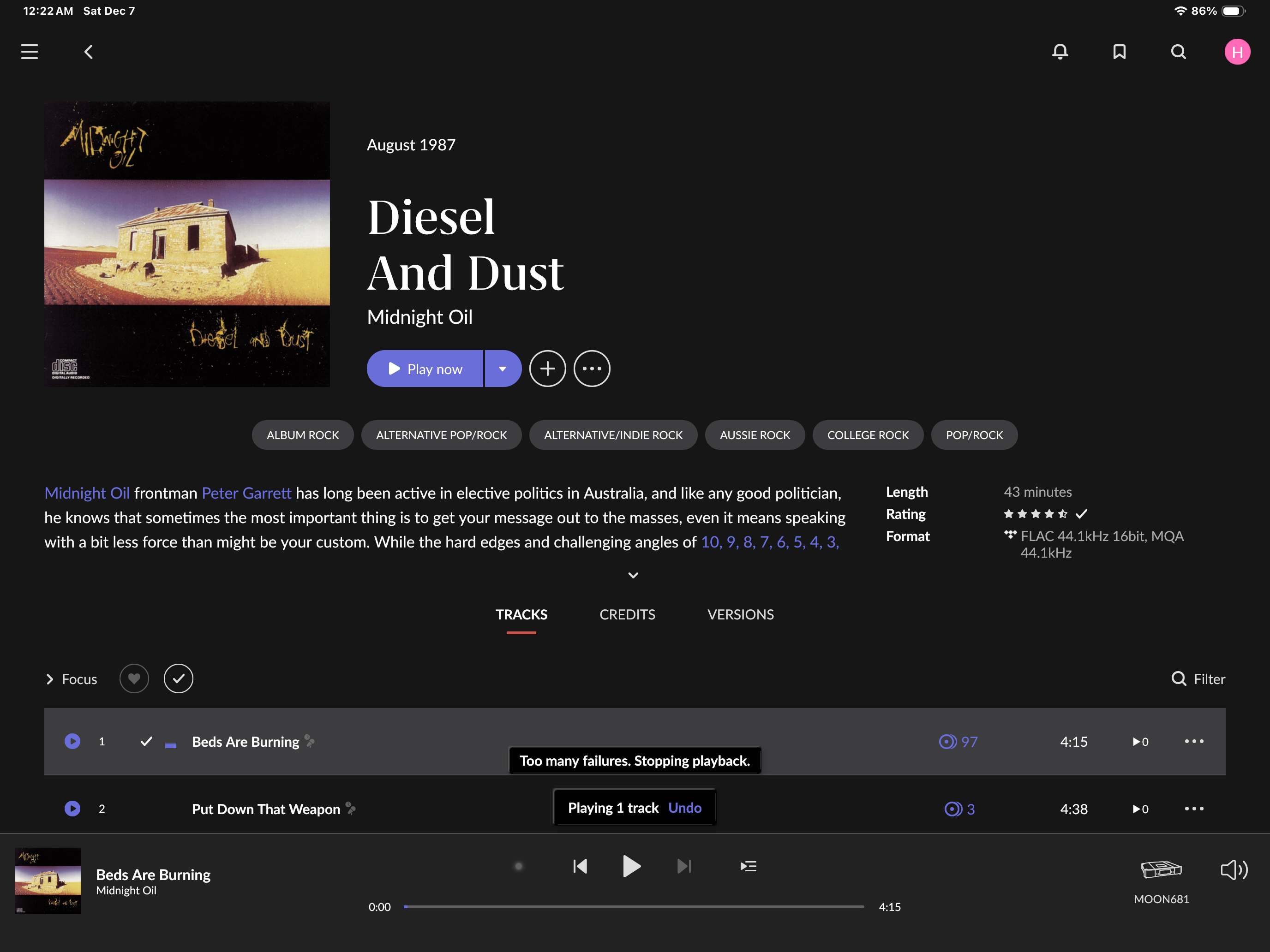

I am getting errors when playing my library tracks with Tidal. Mostly MQA. Suddenly started. No changes to my system.
“Unexpected error when connecting to audio device”
Too many failures. Stopping playback..
Seems to be a Tidal issue when working through ROON. The same tracks play directly on tidal.
Rebooted everything. No better. Please help.

Alyhough I listen to multichannel a lot this issue is with Stereo tracks, MQA only.
I however believe I have tracked down the issue! - The Procedural filter when any channel except the 1 Left and 2 Right are ticked, causes the error immediately.
When the error occurs, “Unexpected error when connecting to audio device”
“Too many failures. Stopping playback…”, there is no signal chain as there is no playback.

As soon as I add ANY another channel to the Procedural EQ , any channel 3 to 8, the error occurs.
“Unexpected error when connecting to audio device”. I just need to remove a channel and leave it at ONLY the L and R, and all plays fine as I have noted in the signal path above.
