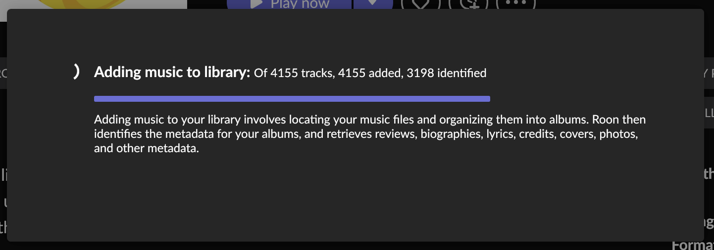

Unexpected library rescan causes music drops and skips (ref#NNIXB1)
· Unexpected library rescan is causing music drops and skips
· Netgear cable modem to Apple Nest Wifi Pro to Etherregen Switch to Nucleus Titan
Not clear why the full library rescan was triggered – all I did was add an album from TIDAL. Is the rescan supposed to be so resource intensive that it causes music playback to stall and skip tracks?
