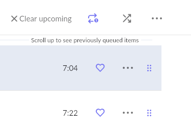

· The queue often activates 'loop all' when I'm starting playback. This appears to happen at random.

I can confirm it’s also occured with shuffle. This morning it was a ‘loop 1’ when playing a single track - and no remote in sight :slight_smile: I’ll get in touch with Lyngdorf. Interested in what the results are from your side!

The loop all issue has just occured again. 22:10 GMT+2, track ‘Reet Petite’ by Jackie Wilson
And now (7:50PM) again. I queued several tracks separately, then it started looping them starting with Toasty - The Knowledge
Sorry for the spam, but it’s happened again - so now constantly when queueing tracks. This time with the minced oath album. All tracks were already duplicated in queue straight away.

09/22 19:54:48 Trace: [zone Lyngdorf] SetLoopLoopOne
From the logs, we can confirm that the loop settings are coming from the Lyngdorf device during the playback of the song. We clearly see the command SetLoopLoopOne.
We already escalated it with our partner’s team to Lyngdorf. Please feel free to reach out to them from your side.
