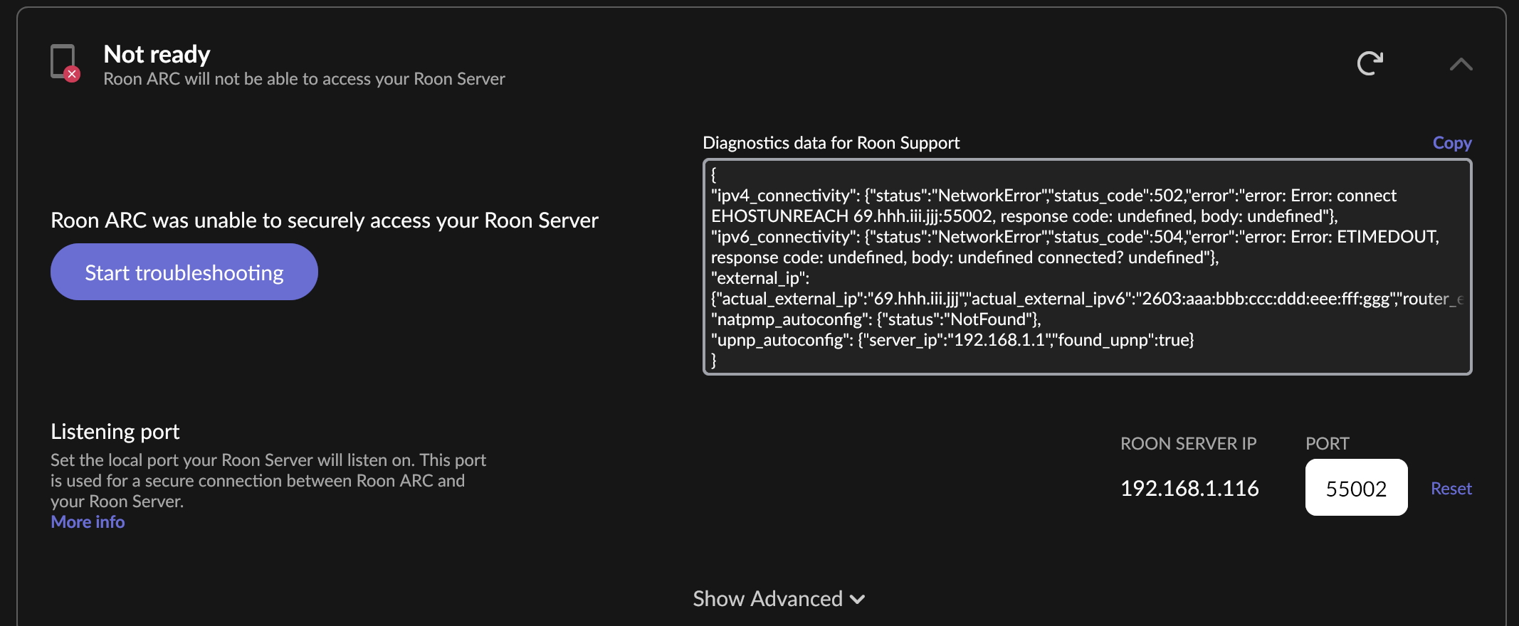

Here is the error message from Roon: {
"ipv6_connectivity": {"status":"NetworkError","status_code":504,"error":"error: Error: ETIMEDOUT, response code: undefined, body: undefined connected? undefined"},
"ipv4_connectivity": {"status":"NetworkError","status_code":504,"error":"error: Error: ETIMEDOUT, response code: undefined, body: undefined connected? undefined"},
"external_ip": {"actual_external_ip":"69.hhh.iii.jjj","actual_external_ipv6":"2603:aaa:bbb:ccc:ddd:eee:fff:ggg","router_external_ip":"69.hhh.iii.jjj"},
"natpmp_autoconfig": {"status":"NotFound"},
"upnp_autoconfig": {"server_ip":"192.168.1.1","found_upnp":true}
WiFi Charter/Spectrum Router

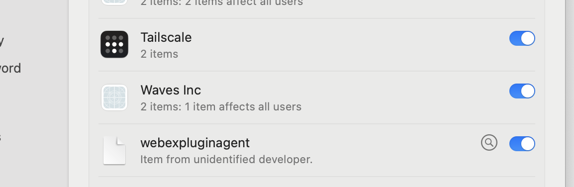

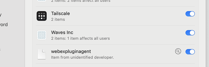

In addition, my Mac will not apparently allow me to approve the TailScale extension, which makes no sense to me. I see it enabled in Settings, but TailScale keeps telling me that I need to approve the system extension. See attached screenshot. If that is not “approval”, then I’ll be damned if I can figure out what is.
Hi @Kevin_Shelton,
Please verify that you’ve toggled local network access for Roon/RoonServer in Privacy & Settings → Local network in addition to the permissions in your screenshot above. We need to ascertain why MacOS is preventing Tailscale from accessing the machine’s network interface outside of Roon.

Both Roon and Roon Server were (and are) toggled on for local network access when I checked.
Hi, did you toggle (switch off and then back on) those settings?
Yes, I did.

I ended up finally figuring out for myself how to do this a few minutes ago, but thank you for the information. Even after finally authorizing the extension to run, however, still no luck getting Roon ARC to work. TailScale is toggled on, by the way. See below (“more follow-up”).

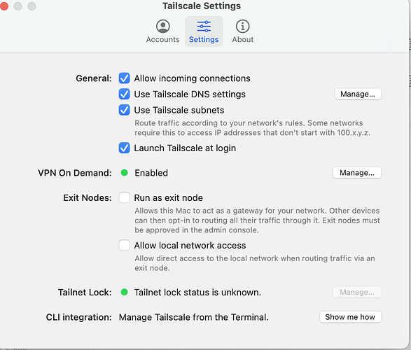

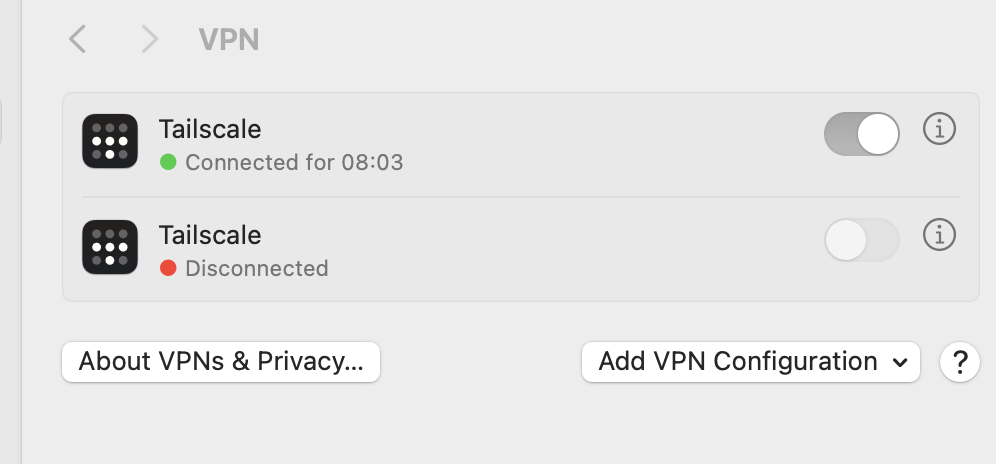

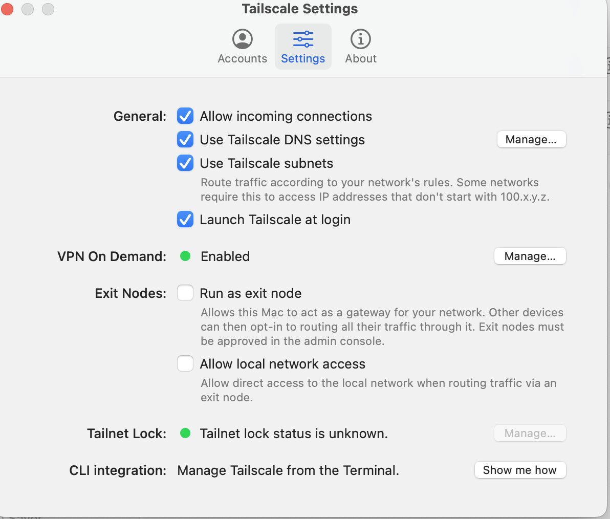

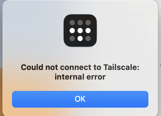

More follow-up. Something really seems to be fouled up with TailScale. See the attached screenshots. None of this makes any sense to me. By rights, this should be up and running. Some mysterious and unlabeled “internal error” is at the root, apparently.

More interesting information. According to Roon on my desktop computer, I am not connected. See attached screenshot. (Note that I have tried it with the Port set both to 55002 and 0).

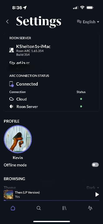

BUT, according to Roon ARC on my mobile phone, I AM connected. (see attached screenshot). It also works remotely on my phone from other rooms in my residence. But will it work in my car or in my office tomorrow, which is where I want and need it 99% of the time? Likely not, but I’ll let you know.
