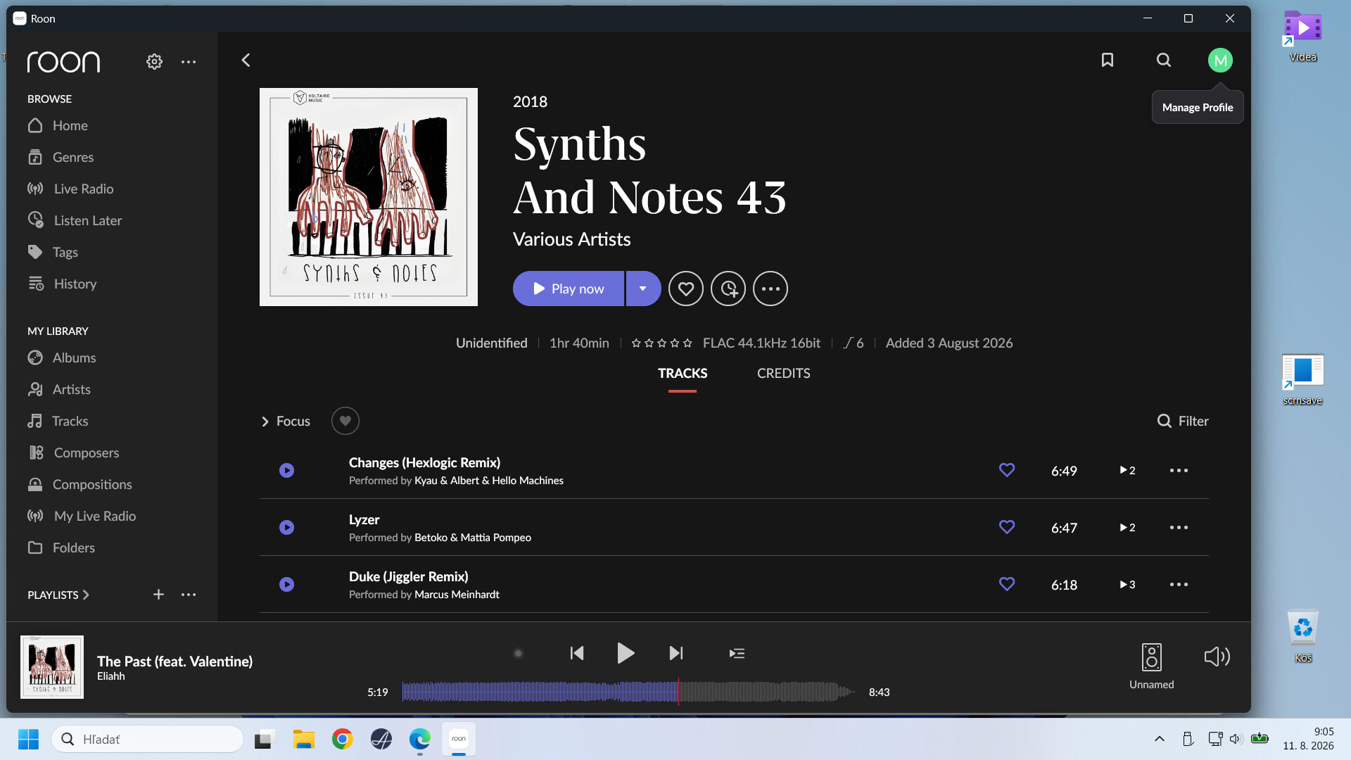

“Hi Vadim, ever since updating to version 2.7.1, there is another annoying issue. When I launch Roon on Windows 11, the app window flashes blindly white first, like a welding torch, before loading the dark UI. It hurts my eyes in the evening and version 2.7.0 never did this. Your v2.7.1 code is clearly broken from the start.”
“Hi Vadim, another playback pause occurred today (Tuesday) at exactly 9:05 AM. There was no ‘Audio device lost’ error message at all. The music simply paused, and when I clicked the Play button, it immediately started playing again without any issues. This clearly proves it is not a hardware, cable, or DAC connection fault. It is a pure software bug within the RAAT protocol or buffer management in version 2.7.1 on Windows 11. Please look up this exact timestamp (9:05 AM) in my diagnostic logs and fix this issue.”

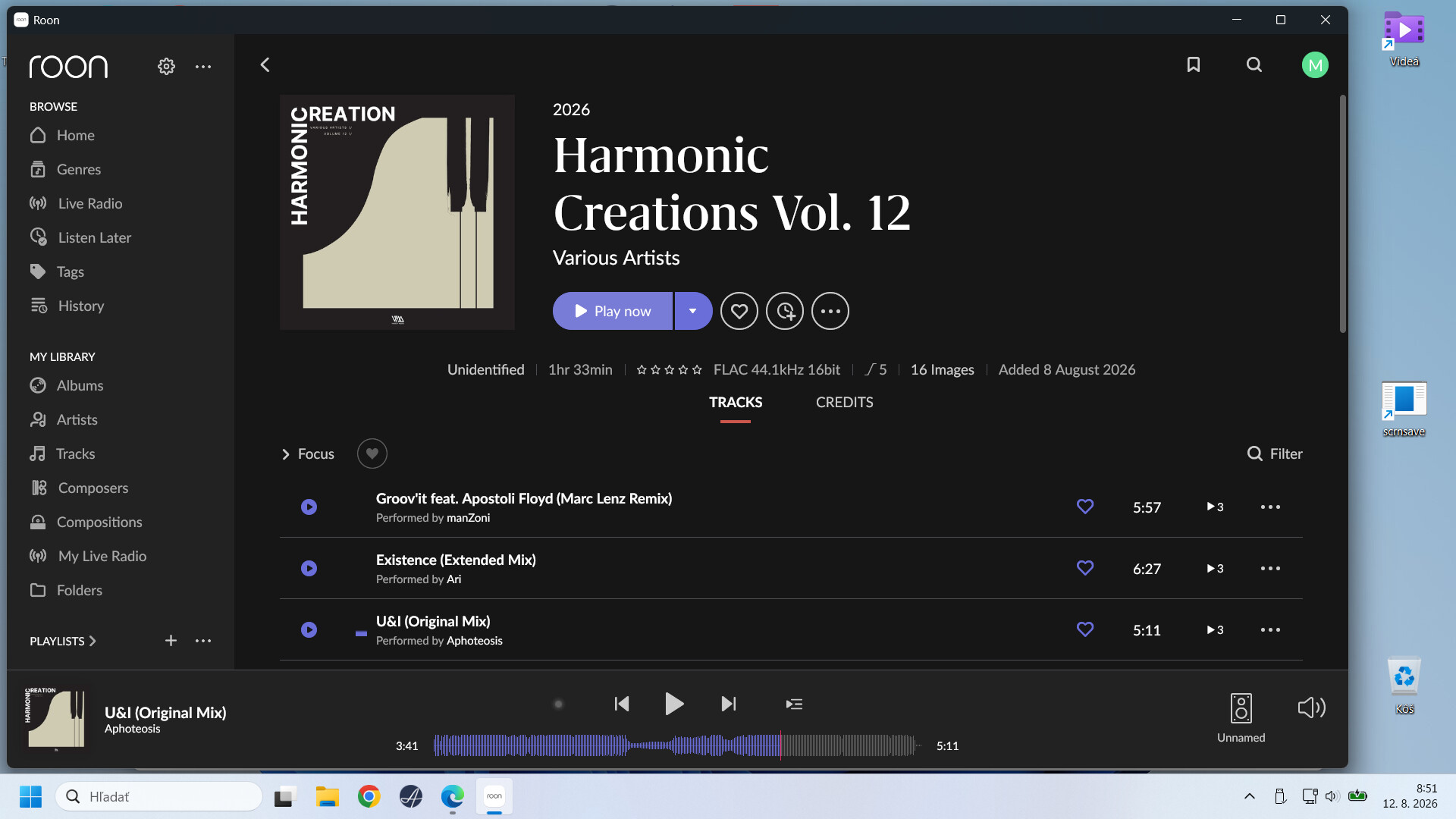

Hi Vadim, it just paused by itself at 8:51 AM without showing any error message. I am sending a photo. Best regards, Marian.

Your three timestamps are exactly what we need, thank you.
The reason we have not looked yet is that we cannot. Enabling diagnostics tells your Roon Server to upload its logs to us, and your machine has no network or internet connection at all, so nothing reaches us and nothing ever will while it stays offline. That is not us asking for more tests, it is that the logs have no way of getting here.
So we need them sent manually, which is a one-time job. Please use the directions found here and send over a set of logs to our File Uploader. Once they are uploaded, please let us know so we can check the server for your files.
With those and your timestamps of 20:30 on the 10th, 09:05 on the 11th and 08:51 on the 12th, we can go straight to the right moments.

Hi @bejdamarian,
Thanks for the logs and for noting those three timestamps, that made this much easier to pin down.
I found all three events, and they all look identical. Here’s what happens at each one :
  • Your Michi’s ASIO driver reports a device_reset to Roon
  • One second later, Windows reports the Rotel PC-USB Audio 2.0 device being removed from the system
  • One second after that, Windows reports the same device being added back
So the P5’s USB audio interface is briefly dropping off the USB bus and re-enumerating. When that happens Roon loses the endpoint it was playing to and stops the zone. By the time you look over and press play, the device is already back, which is why it starts up again immediately with no error message.
The good news is we can rule out most of the usual suspects from your logs:
  • Not sample rate related. Every one of these happened mid-track at a steady 44.1kHz/16-bit, never at a track change or rate switch. That matches what you found testing lower rates.
  • Not your files or your drive. No buffering problems, no dropouts, no read stalls anywhere in five days of logs.
  • Not the laptop being overloaded. Roon Server’s memory and CPU look completely idle in the seconds before each stop.
  • Not Roon Server crashing. It keeps running right through each event and reconnects to the device within a second.
Right up until the instant the driver resets, everything on Roon’s side is healthy. So the cause is below Roon, in the USB link between the laptop and the P5.

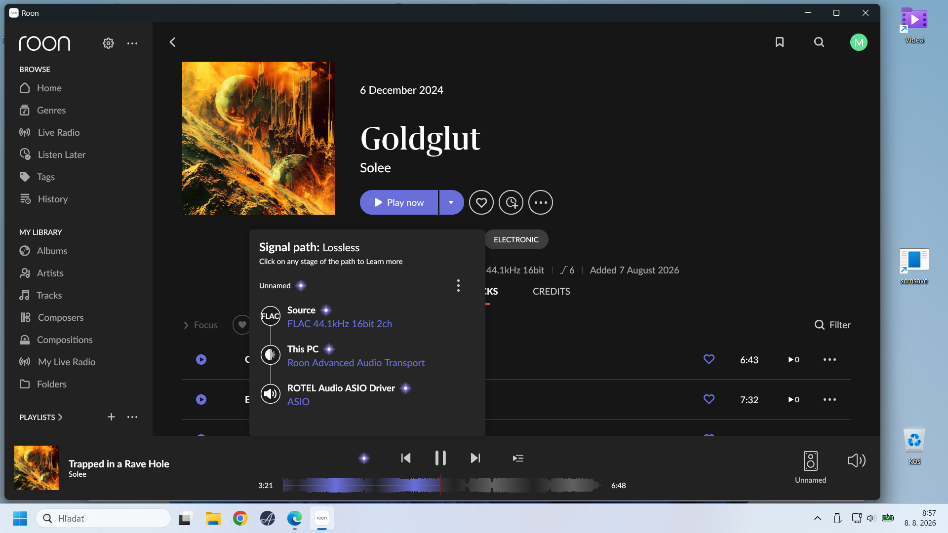

If it still drops after all that, could you run a listening session using WASAPI Exclusive instead of the Michi ASIO driver? In Settings → Audio you should see a “Rotel PC-USB Audio 2.0” WASAPI entry alongside the ASIO one, enable that and play through it for a while.
This splits the problem cleanly in two:
  • If it still drops on WASAPI → the issue is at the USB or hardware level
  • If it stops dropping on WASAPI → the issue is in the Michi ASIO driver, and a driver update from Rotel is the fix
Either way it tells us where to go next, and it’s worth checking Rotel’s site for a newer ASIO driver version regardless.
