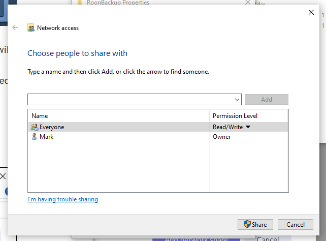

Roon server running on Rock, Roon Remote on this PC, RoonBackups directory set us as shared with everyone, on a USB connected hard drive, pasting the share link from the properties of the directory

Hi sorry, about the garbled request. I was trying to use the help function. I recreated my problem for the screenshot and typed it in wrong that time but \\DESKTOP-DP3CL33\RoonBackup gives the same error.
I don’t understand the point about not sharing with everyone. This is the only option I think because the only other account is the owner? But I did try sharing with Mark (me) and using this as the username and this doesn’t work either. I do not have a password on my windows account. I’m using Windows 10.
Screenshot 2

In the Help article about shared folders in Windows I linked to, follow the link in it (at the bottom of the article) to see how to create a local Windows Account and use this.
