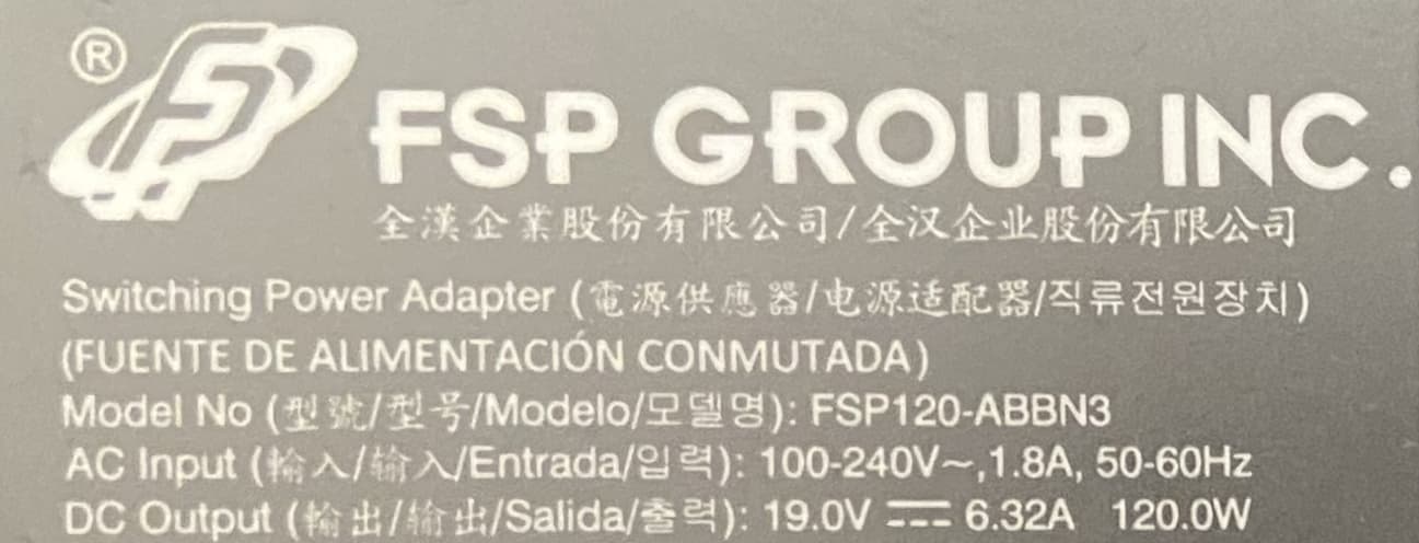

What would be you suggest? Below a picture of my NUC/ROCK’s SMPS.
Something like this (a European 240V analog, of course)?
No fans or anything, and honestly I would not even think about running a 24/7 computer holding any kind of database without one…
I do wonder if some kind of a hack could be designed to gracefully shut down ROCK if power goes out (should be basic functionality, really). If running on standard Mac/Win/Linux, or even a NAS, it’s builtin.
It depends if you consider the NuC part of the analog side or the digital side of the playback chain.
Analog, you’re right in that you don’t want a UPS. Maybe something like a Stromtank. Or a whole home surge suppressor just to catch spikes when power comes back.
If you consider the NuC part of your digital playback chain then throw everything you know about analog noise out the window because it’s just not the same thing. Digital “noise” is easy to get rid of with things like network (fiber), USB isolators, galvanically isolated streamers, etc. Or even a combination of all these things. Then, “noise” from the NuC is never gong to make it to the analog side of your playback chain and you can use any UPS you want. It’s the analog side we listen to.
