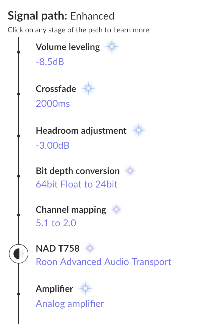

I am using Roon with multiple endpoints, including a NAD T758v3 receiver in a 5.2.1 setup. When I play multichannel SACDs or DVD-As on my disc player, they play in proper multi-channel goodness. But when I try to play multichannel rips through Roon, they play back in 2 channel only – not even as a proper downmix, just losing information. When I look at the signal path, I see:
How do I tell it not to alter the channel mapping from 5.1 to 2.0?

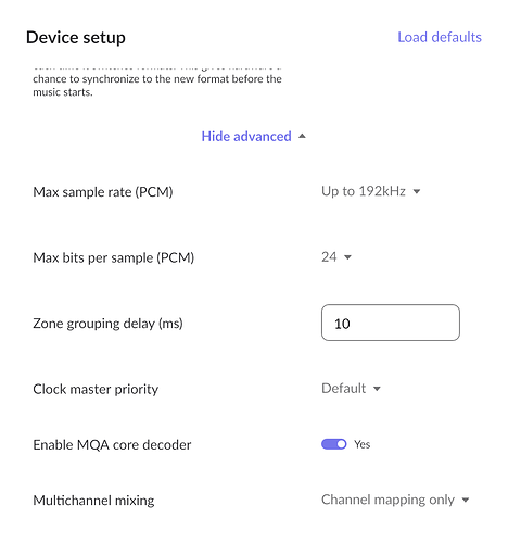

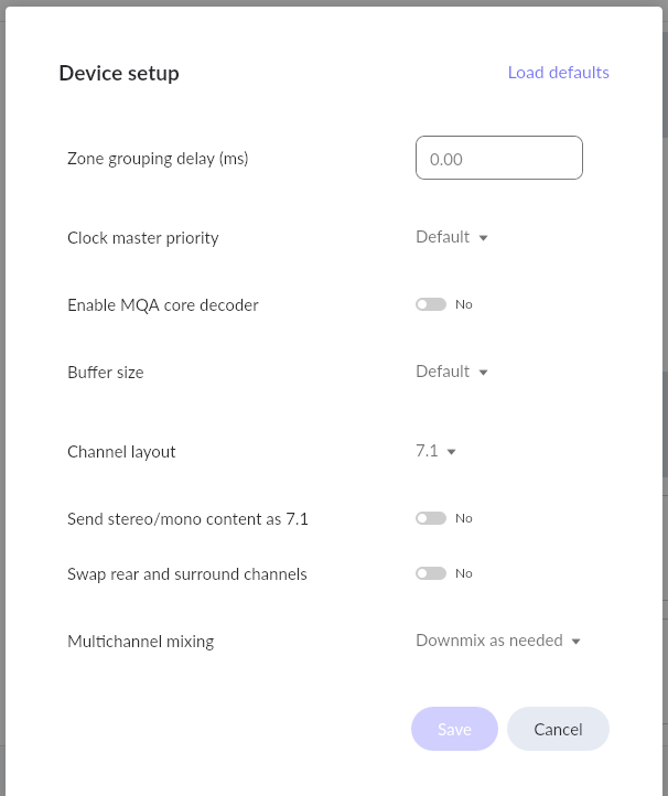

@John_Steinberg - For Multichannel output, you would need to use HDMI unless your device specifially supports it via another method (). Please ensure that you have edited Device Setup → Advanced for the zone and have selected a 5.1 channel layout:

Your problem is your endpoint. NAD gets it’s “Roon support” via the BluOS device attached to the back which uses a Wifi link in and a USB output to your receiver. The T758 has no idea about Roon. BluOS is a impaired implementation of RAAT and only supports limited sample rates and and 2CH. The RAAT protocol informs the Core that the endpoint is unable to handle MCH and so the Core down samples your MCH tracks to stereo. My guess is it won’t pass DSD or DXD 2CH either and the T758 probably can’t handle it if it could.

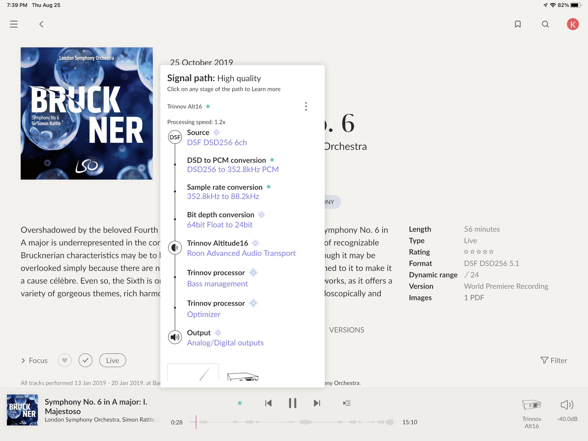

The problem is not with Roon. Here is what the output from my Core looks like feeding a 5.1 DSDx2 track to a Trinnov Altitude 16 which has it’s own RAAT software. The Trinnov accepts a max of 24/96, so you can see my Core has to down sample the track (RAAT informs it of the endpoint limits) but it maintains the 5.1 channels.

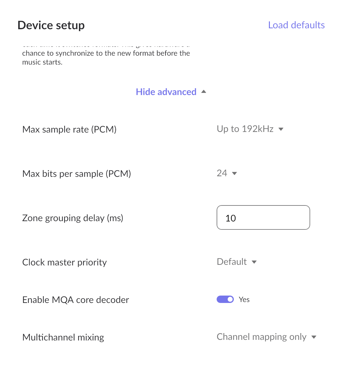

First, thanks for helping me out here. I tried to manage the channel layout as shown in the “Multichannel” link you sent, but I don’t see any menu option for selecting any flavor of multichannel. I just see this:
Am I looking in the right place?

Interesting - Roon seems to think that only 2 channels are available. I suspect the solution to the puzzle is to connect your Roon Core directly via HDMI to your NAD, and then tell your Mac to set up multichannel over the HDMI connector (using the MIDI setup? - I’m not a Mac user, so don’t know the mysteries of Apple). Then you should see the full setup in Roon:
OK, after a long struggle and lots of experimentation, I have finally found a way to play 5.1 content through my NAD HT receiver. As suggested earlier in this thread, it required moving my core (MBP) into the room so that I could connect it to the receiver via HDMI.
