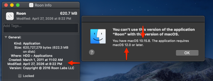

· Latest update is not running on my macOS 10.15. The update technically broken my setup. I don't appreciate the lack of backward compatibility and I need to downgrade and rollback.

Roon had to update some foundations and your outdated macOS does not support these anymore, because it is end-of-life by Apple.
You can temporarily reinstall Roon version 2.64, which works with your outdated macOS. The download link is in the release notes:
You will then need to make sure to deactivate automatic updates in Roon Settings > About.
Then make sure you have a safe Roon database backup on a different device (such as an external USB drive).
Going forward, you need macOS 12 (Monterey), but most old Intel Macs that don’t get the update from Apple can easily be updated with Open Core Legacy Patcher (OCLP):

As @Suedkiez mentioned our recent platform migration to a newer framework means Roon now strictly requires macOS 12 or newer. We understand this can be frustrating when you are running older, stable hardware.
The community suggestion above is exactly the right path forward:
  1. Use the 2.64 to roll back to Roon 2.64.This is the recommended approach only for transferring your database to another device.
  2. Go to Settings > About and turn off automatic updates so the system doesn’t try to overwrite it again.
Crucial Note: Please treat this legacy version only as a temporary solution—ideally to gain access to your current database, create a fresh backup, and prepare to migrate your Roon Core to a supported machine or OS. Roon requires version parity between the Core and its Remotes. Any other devices you use (like your mobile phone or tablets) that automatically update to newer Roon versions will soon be unable to connect to a 2.64 Core due to the version mismatch.
