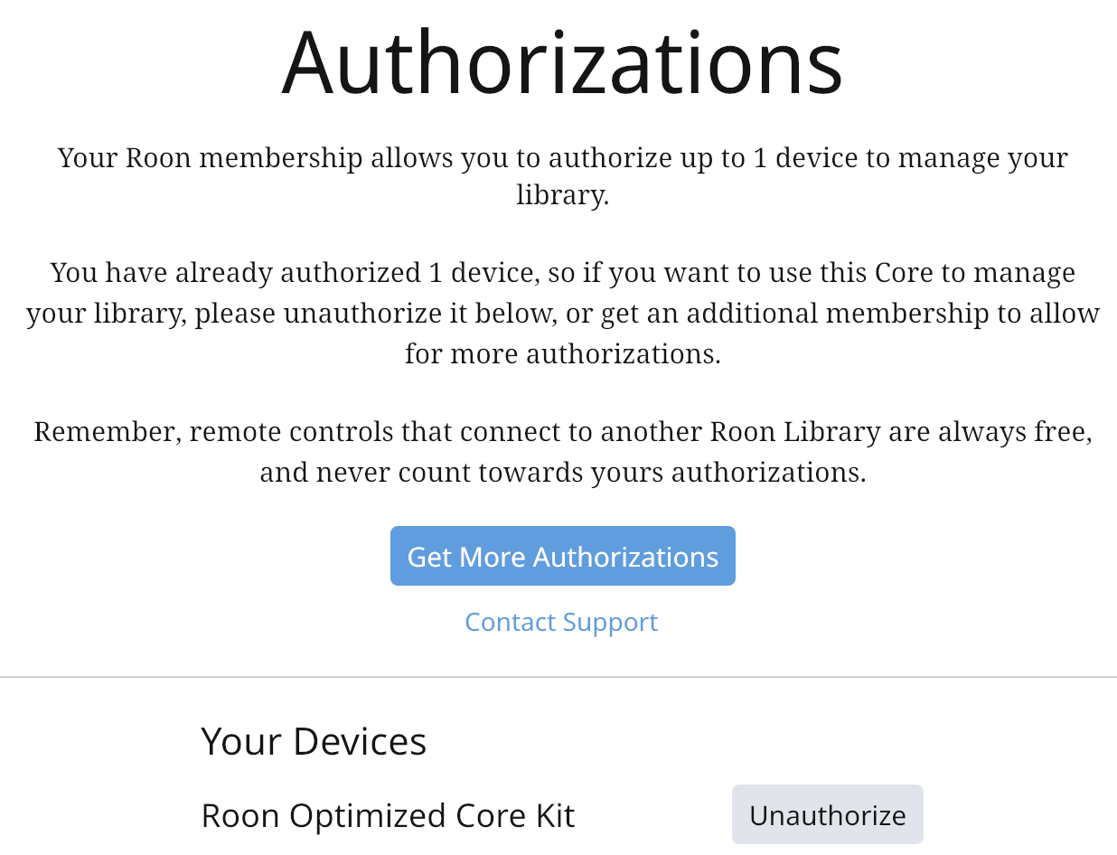

The login step takes a while (over a minute?) and then displays the option to unauthorize rock or buy more authorisations to install Core on the Mac instead. It does not connect to Rock as it would normally do.

10.49.20 Timeout and show Authorizations dialogue.
Authorizations dialogue:
Just realised I ought to inform that my Roon Core on Rock is installed by myself on an Intel NUC from the minimum tech specification list, so it’s not your Nucleus product.
Have you tried clicking “unauthorize” next to ROCK?
No, I haven’t tried that. I consider it a last option since it’s gonna be even more days outage while first the new Mac core scans the library after importing the backup and then I need to transfer the license back to ROCK who will also scan the library again… It takes days before a full library scan is completed. (My music library is ~ 7 TB in size.)

When you have a chance I would try pressing the Unauthorize button and re-authorizing your ROCK Core (if this is where you intend to keep the Roon Core). Do let me know if you have any further issues.
Actually I decided yesterday to take this step rather wait for a conclusion and how to recover without a rescan. By unauthorizing ROCK it selected ROCK core automatically without a rescan. Also I didn’t have to authorize it again. Seems illogical but never mind. It works again and in the end that’s all that counts.
