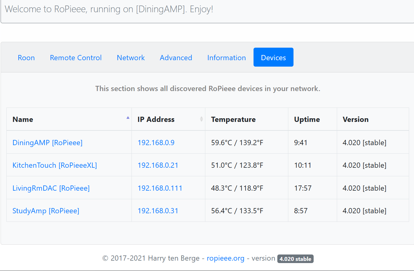

I’ve been very happy with Ropieee for many years now, and I’m still very happy. Just wondering, does it make sense to update things? Or does “if it ain’t broke don’t fix it” apply here? Here are my Ropieee devices:
There are updates. However, it seems that you haven’t taken them.
How does one take them?
Open a web browser, and enter the IP address of one RPi, and click on update. Repeat for each RPi: these are listed on a separate tab.
Where might that button be?

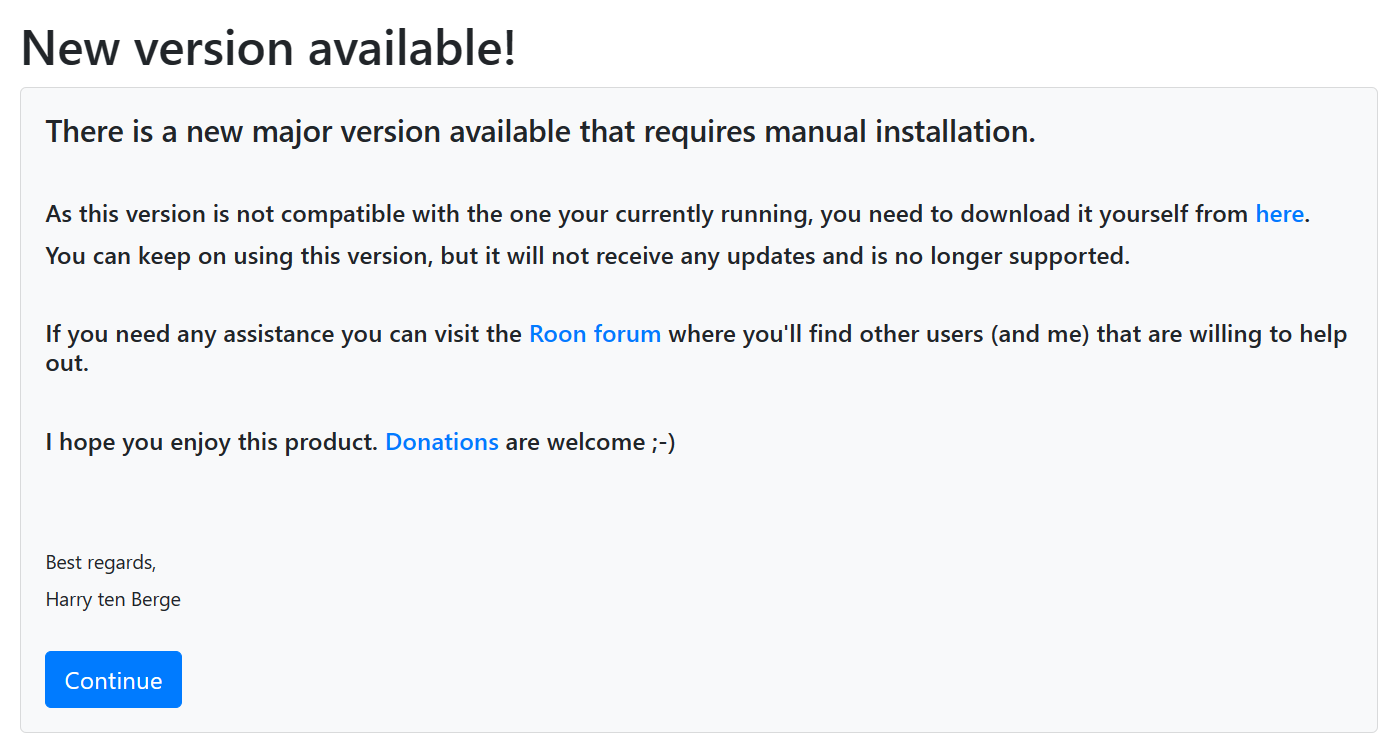

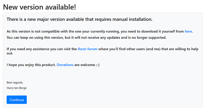

Note that this applies only to the “Kitchen Amp.” All other Ropieee devices have this screen:
**Before getting to this screen: **
I think you need to reflash your SD card to move beyond version 4.020, but @spockfish should be able to confirm.
Yes, manual installation is needed for all RPi, which means reflashing the SD cards. This applies to “Kitchen”, too, as this is also running an outdated version, although not the terminal release.
