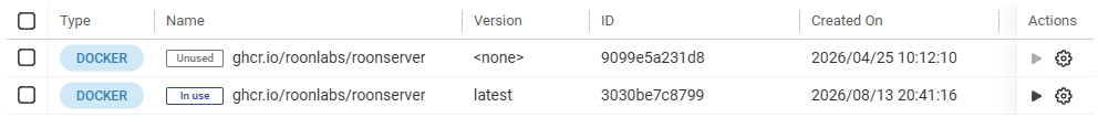

Updating Roon on QNAP NAS after Docker Install
Ok done and seems to work… which image should I delete now exactly?
The <none> one that is Unused and older.
Thanks, works now!
