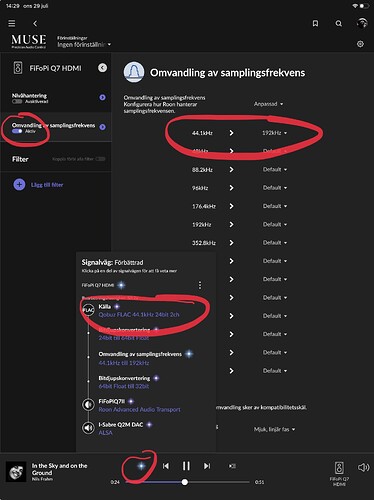

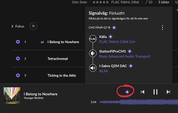

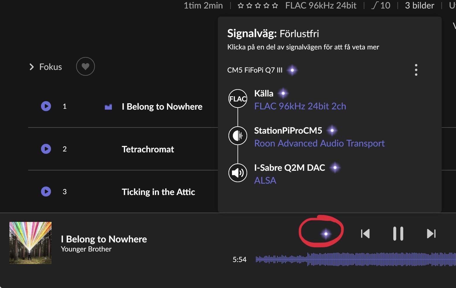

Look at the signal path, the little coloured icon when playing music.
(This shows a zone which is NOT upsampling, btw)

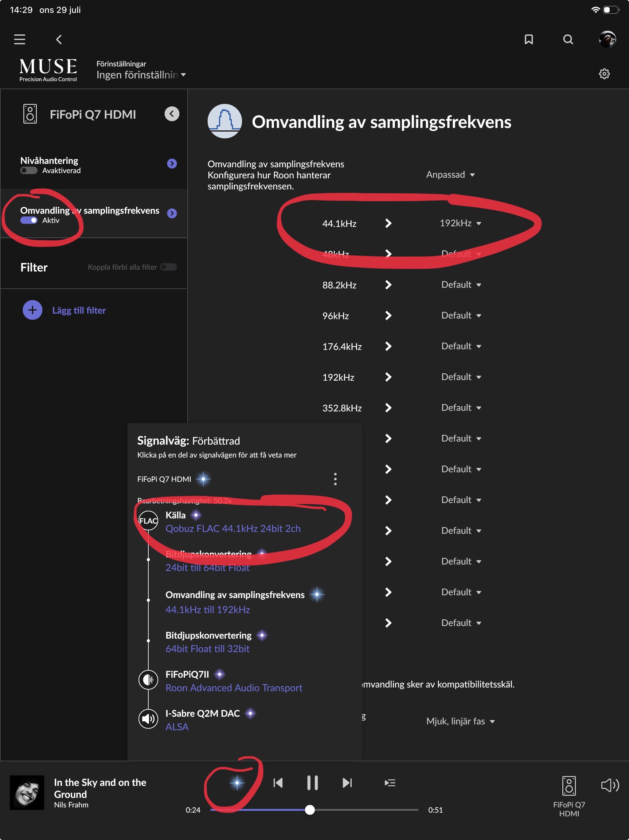

MUSE: Upsample → Custom → 44.1Khz>192Khz
Signal Path: Showing source sample rate and output sample rate as well as any modifications, and processing speed.

No, the source part needs to tell what material you are working with. Below the various modifications to the audio stream are exposed.
The upsampling part is shown in my screenshot right before “Bitdepth conversion”…
