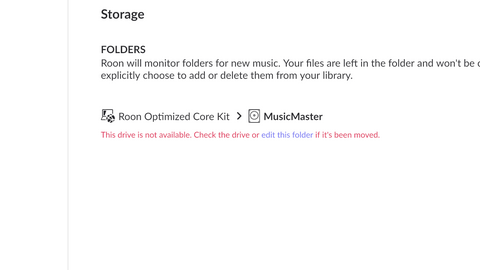

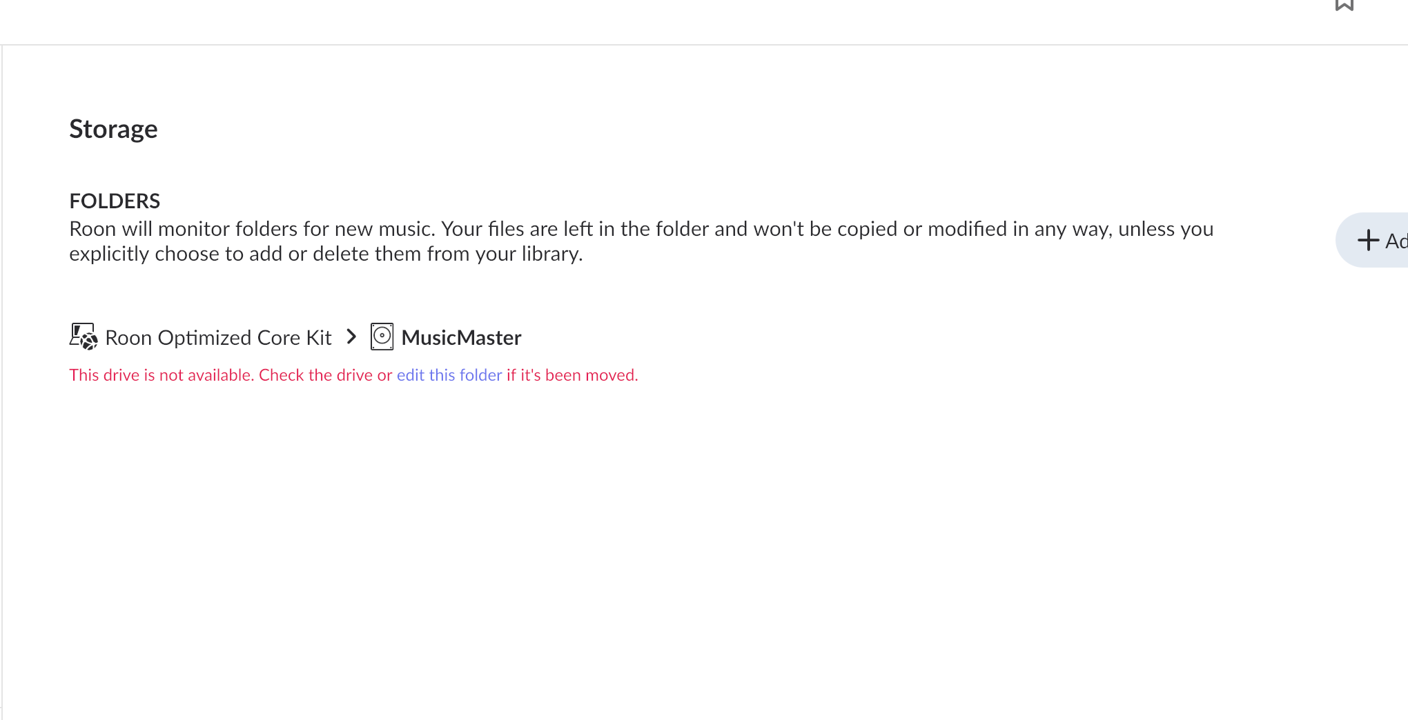

Directly connected external(USB-C) storage is not available.
Not relevant, directly attached via USB-C
Just to add what was happening. Music was playing. Paused it. Restart and tracks flew by onscreen with a message about the audio track was loading too slow. I went to investigate and discovered the drive not available.
I powered off the ROCK, removed the external drive and mounted on my Mac. I ran diskutils on it with no issues reported. I reattached it to the ROCK. Roon still could not see it.
From my Mac, I made a SMB connection to ROCK and that was successful but the storage directory was completely empty. Other directories where there.
ROCK is running 2.55 (build 1559) and OS is version 2.1 (build271)

Hi @mjw and @Geoff_Coupe. From within the Roon App, I have edit ability under the three dots. All the music is visible. Additionally, in the Roon app and via the folders menu item I can see everything.
You might have missed it to my other post in this threed this morning but it does not appear to be a file system issue. When I get the errors on loading files, it’s not on input as one would assume. Rather, it is on output,
From my prior posts in this thread. It was working fine until yesterday so what changed since I said I paused the music that was playing fine and then restarted it and had the problems. Well, why did I pause it in the first place? I wanted to add another zone (in Roon, group) to what was playing via RAAT to the WiiM Pro zone. I added the Eversolo zone via RAAT to create the group. That was when the problem because evident.
