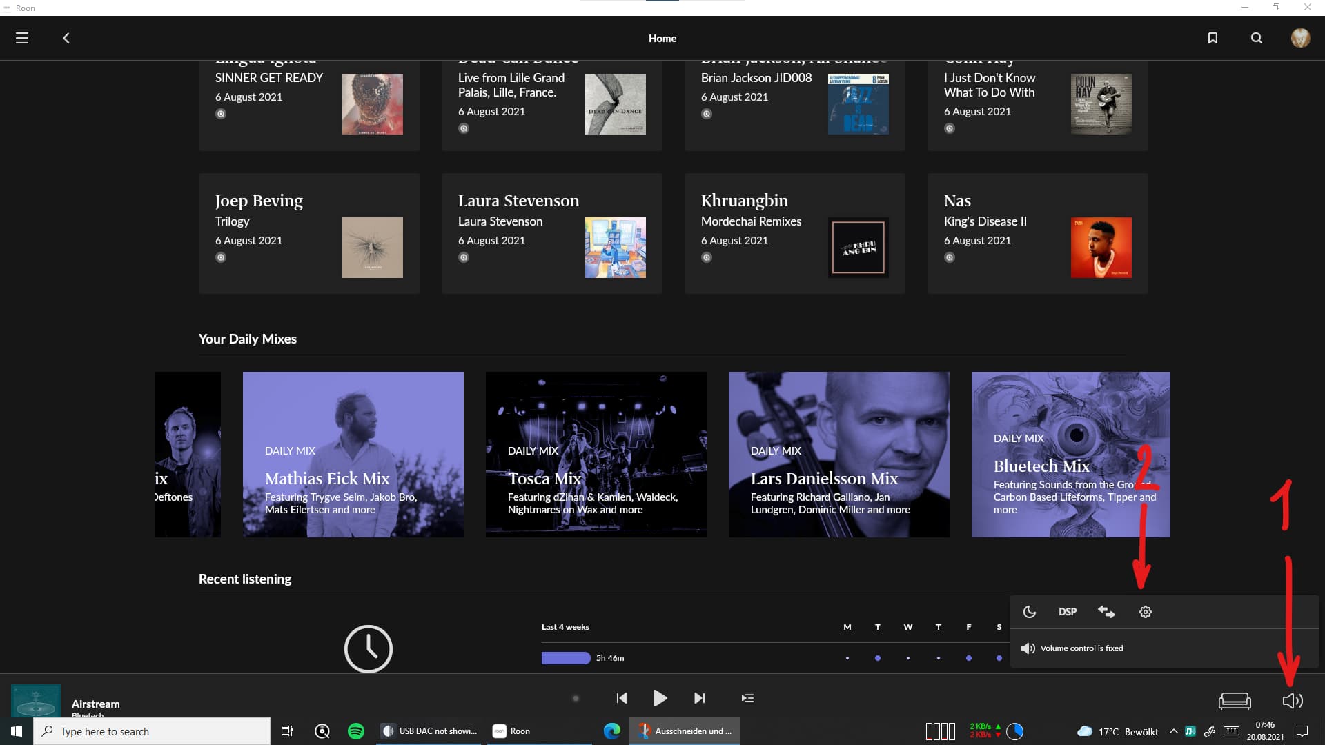

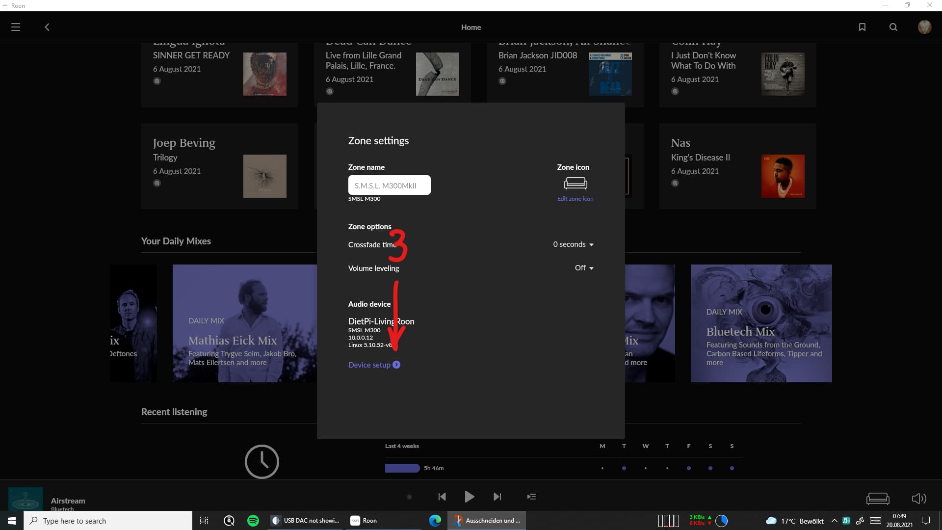

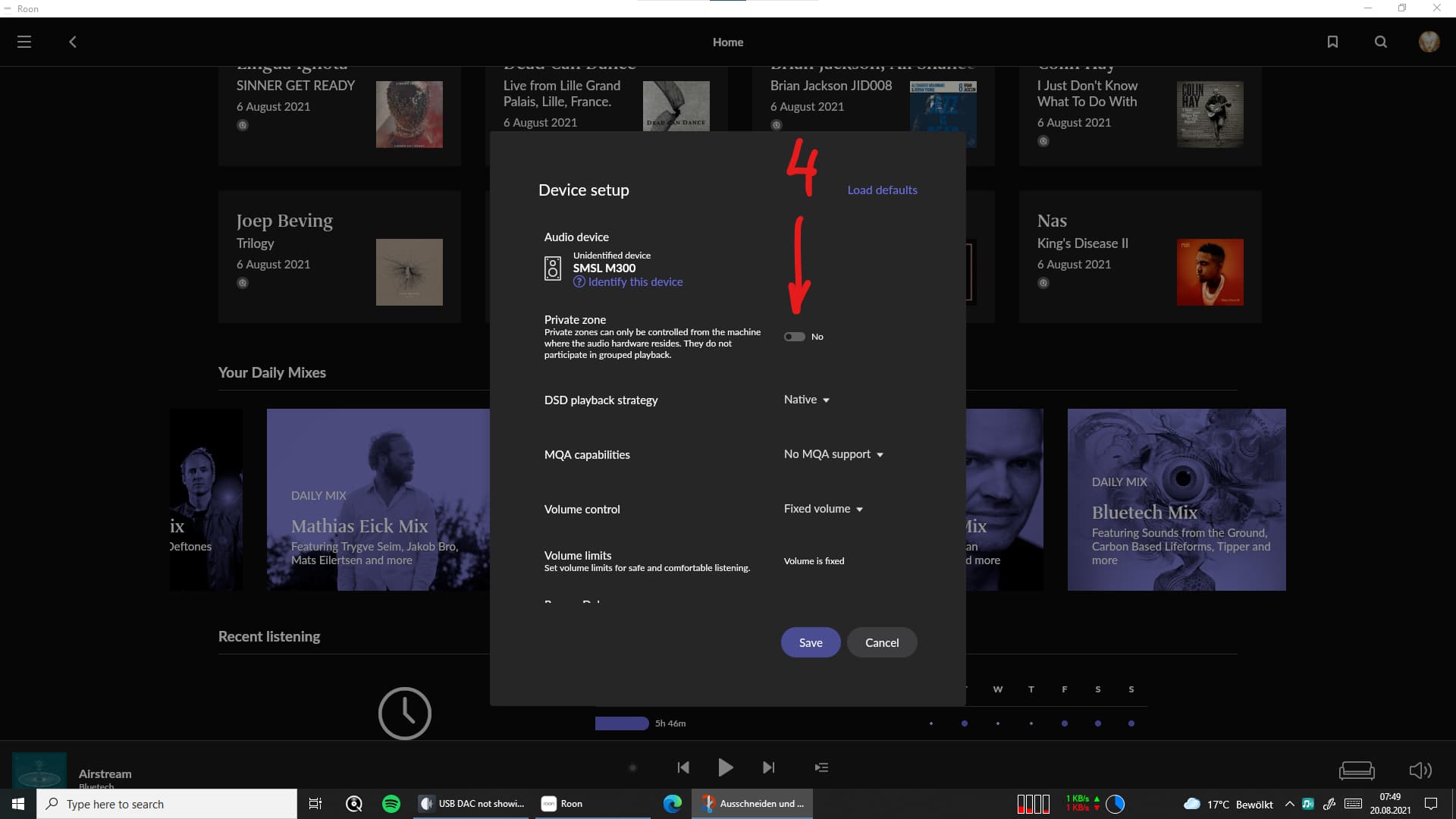

It may be set as a private zone (mine is not, as shown in the screenshot)
Many many many many thanks. That was it.
