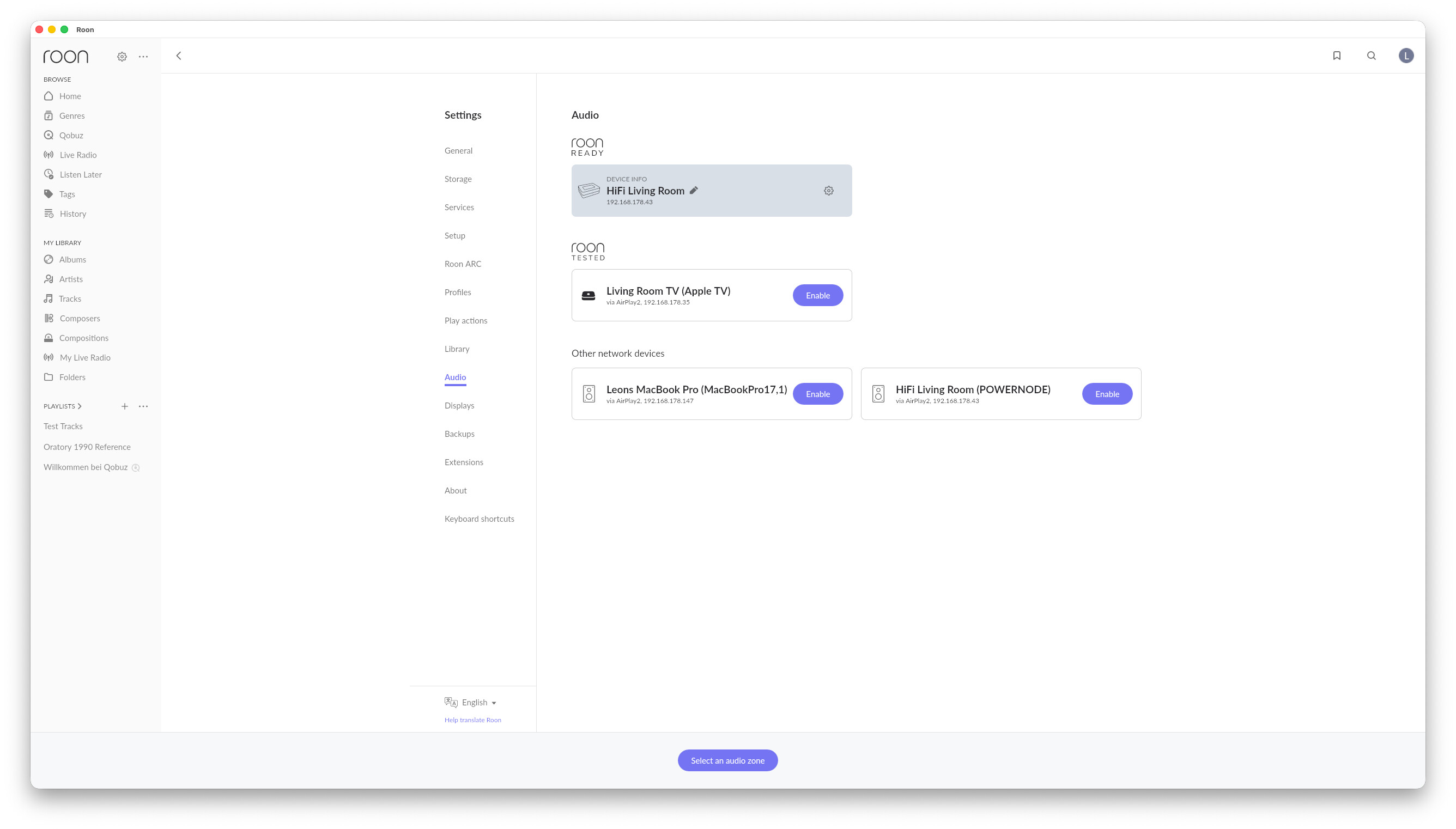

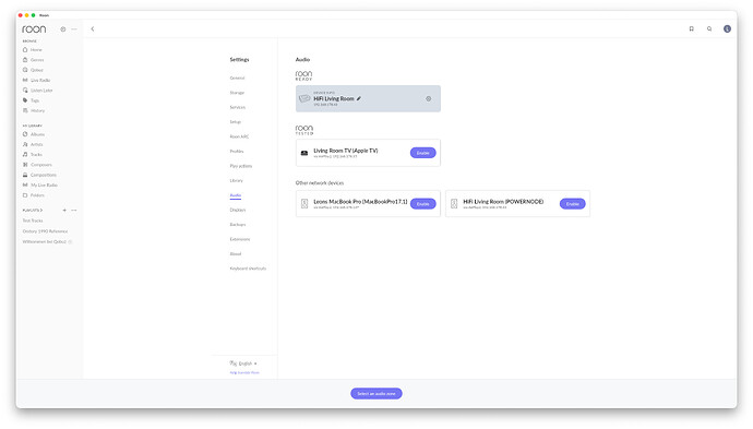

Here we go again, same problem as in November. My USB DAC works just fine, macOS can play system audio through it, but it does not show up under settings → audio. Worked just fine before the system update (on 26.3), but now it’s borked again. Last time enabling full disk access was what did the trick, I turned it off and on again, also restarted my mac, to no avail. Also using rosetta2 does not help.

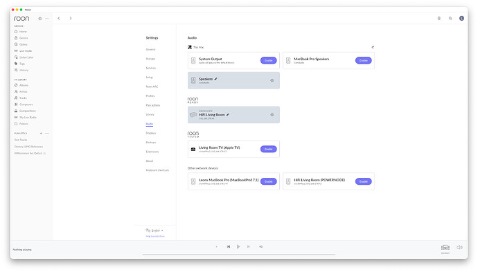

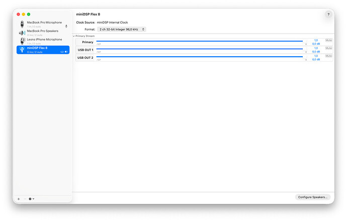

Can you please share a screenshot of Roon Settings → Audio as well as your MacOS Audio Midi Setup utility showing the USB DAC?
We’ll watch for your reply. Thank you!

My DAC is a miniDSP Flex 8, works fine in macOS, shows up under the midi settings, just roon not recognizing it. Also under Windows 11 it works perfectly fine too, also with roon.

Thanks for sharing screenshots.
Most likely the issue here is how miniDSP is being identified.

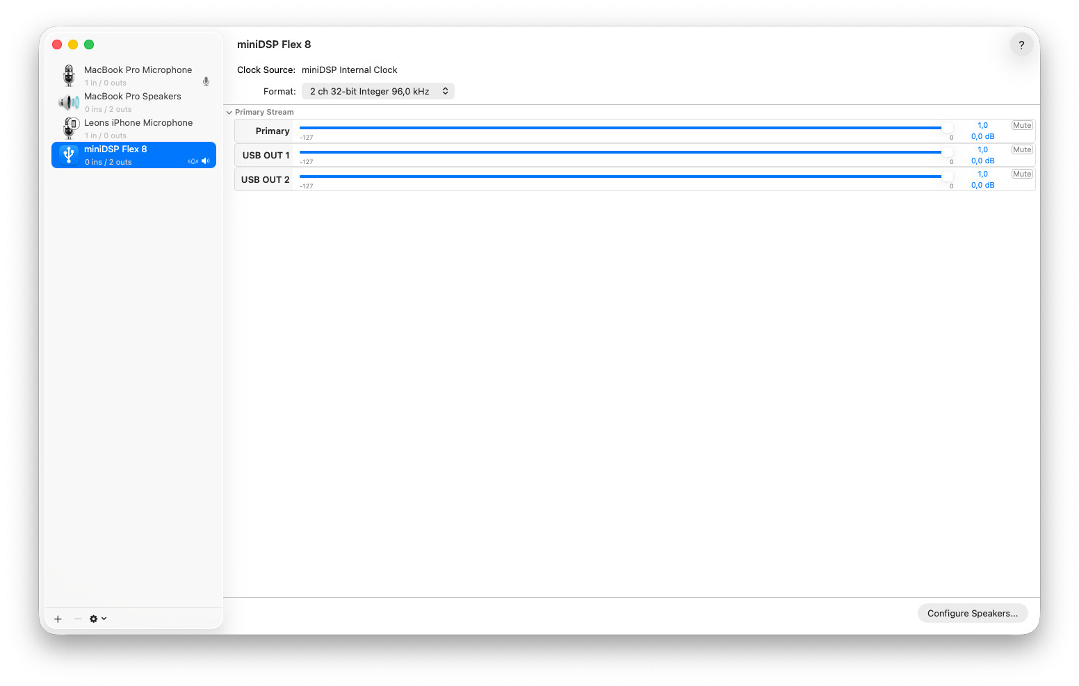

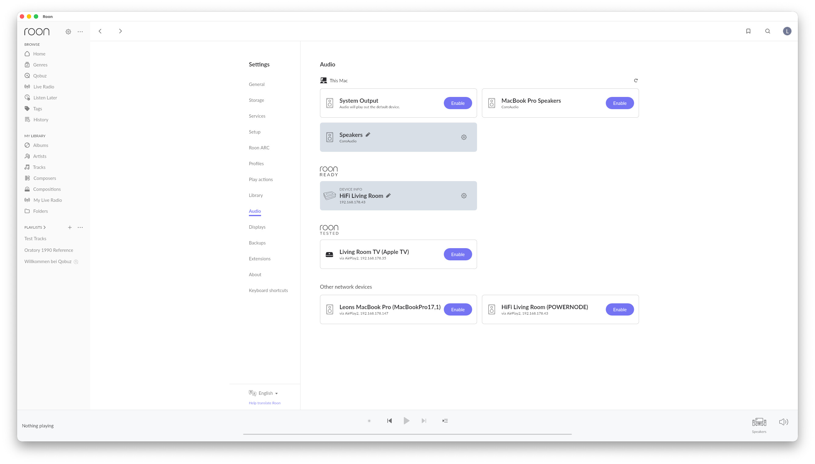

Interesting to note though that together with my USB DAC, System Output and MacBook Pro Speakers also vanished from the list of audio devices, and are now back.
