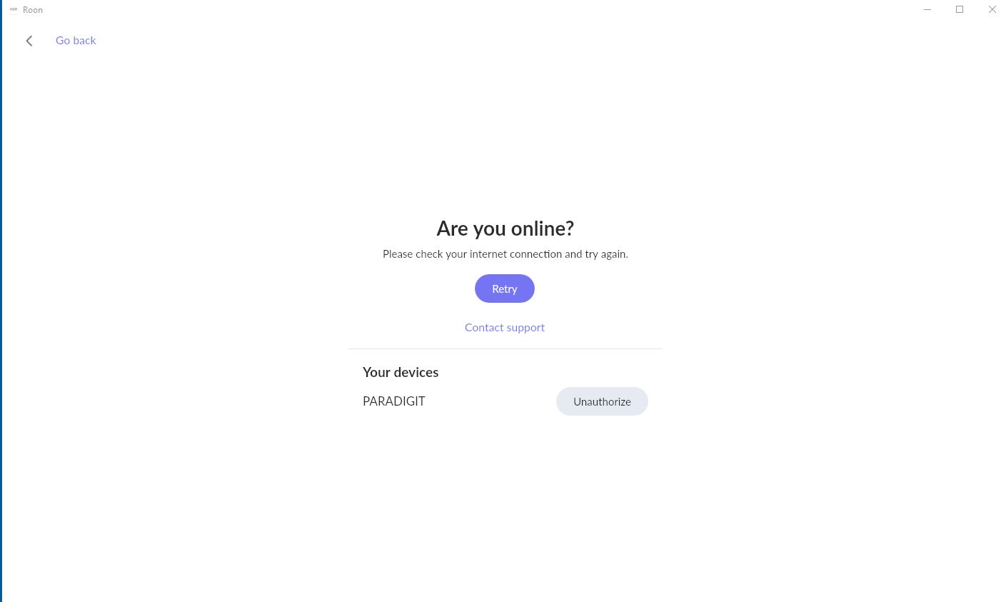

Unable to unauthorize. I bought a Nucleus One and I am trying to transfer the connection from my PC (PARADIGIT) to the Nucleus One. This fails. I see both machines (This PC and Nucleus One with status ready. When I try to connect to Nucleus One I get the choices Login, Sign up and Restore a backup. Login and choosing my account will lead to the question Are you online? I can click Unauthorize but that leads to the same screen.

When I open Roon on the PC it opens a screen where both servers (the PC and the Nucleus One) are shown as Ready with a green dot. The PC has Version 2.0 (build 1496) and the Nucleus One has Version 2.0 (build 1359). Bith choices have a Connect button displayed. At the bottom the link Configure Roon OS devices is shown. That will show only the Nucleus One with Version 1.0 (build 259). The web interface indicates all the statusses as OK.
Just now I selected the Connect option on the right of Nucleus One, and now it seemed to work, but only for a brief moment. It display that something was wrong, but it is now busy adding music to the library. Fingers crossed.
