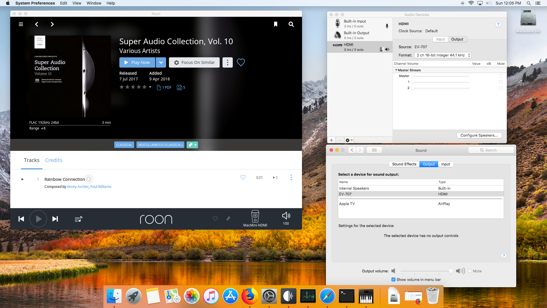

Thanks for contacting support, I’d be happy to take a look over this issue with you. Can I please ask you to provide a screenshot of your Audio MIDI Setup screen of your Mac Mini after the HDMI output is selected? More information about this screen can be found on Apple’s site here.

Here is the screenshot showing the Roon screen the apple sound output and the MIDI screen.
Hello @David_Carmichael,

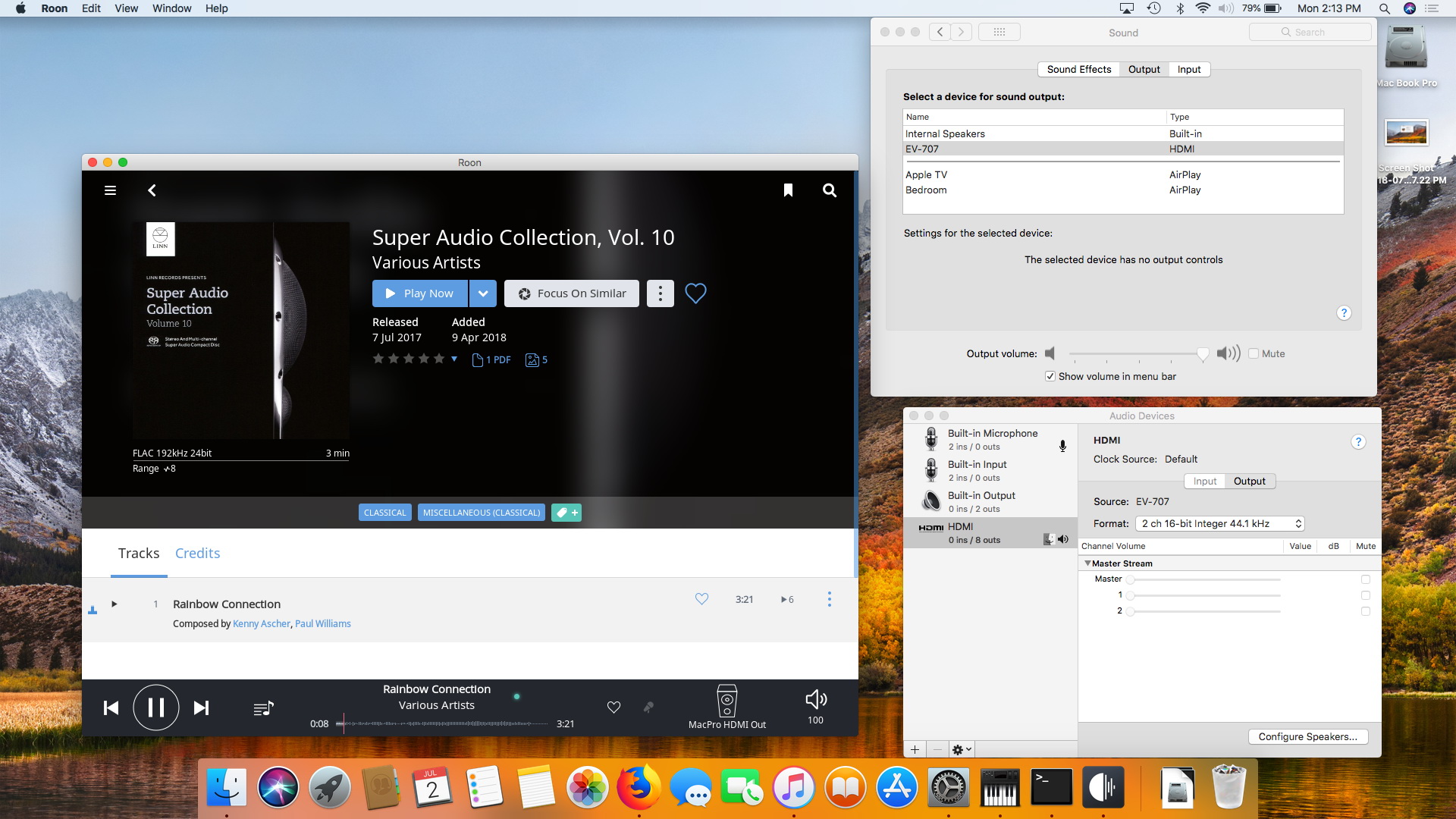

Thank you for providing that screenshot of the MIDI screen, it looks as expected so I am wondering why this issue occurs myself. Would it be possible for you to send me a screenshot of the MIDI screen on your Macbook Pro as well? I just want to confirm that it looks the same as the Mac Mini in this case.
I can confirm that we have received the needed diagnostics info from your Mac Mini and have started a case for you with our QA team, this interesting behavior and I would like for them to take a closer look as to what could be going wrong. Please provide a screenshot of your MIDI setup on the Macbook Pro when possible so that I can add that as a note in your case as well and we can continue from there.

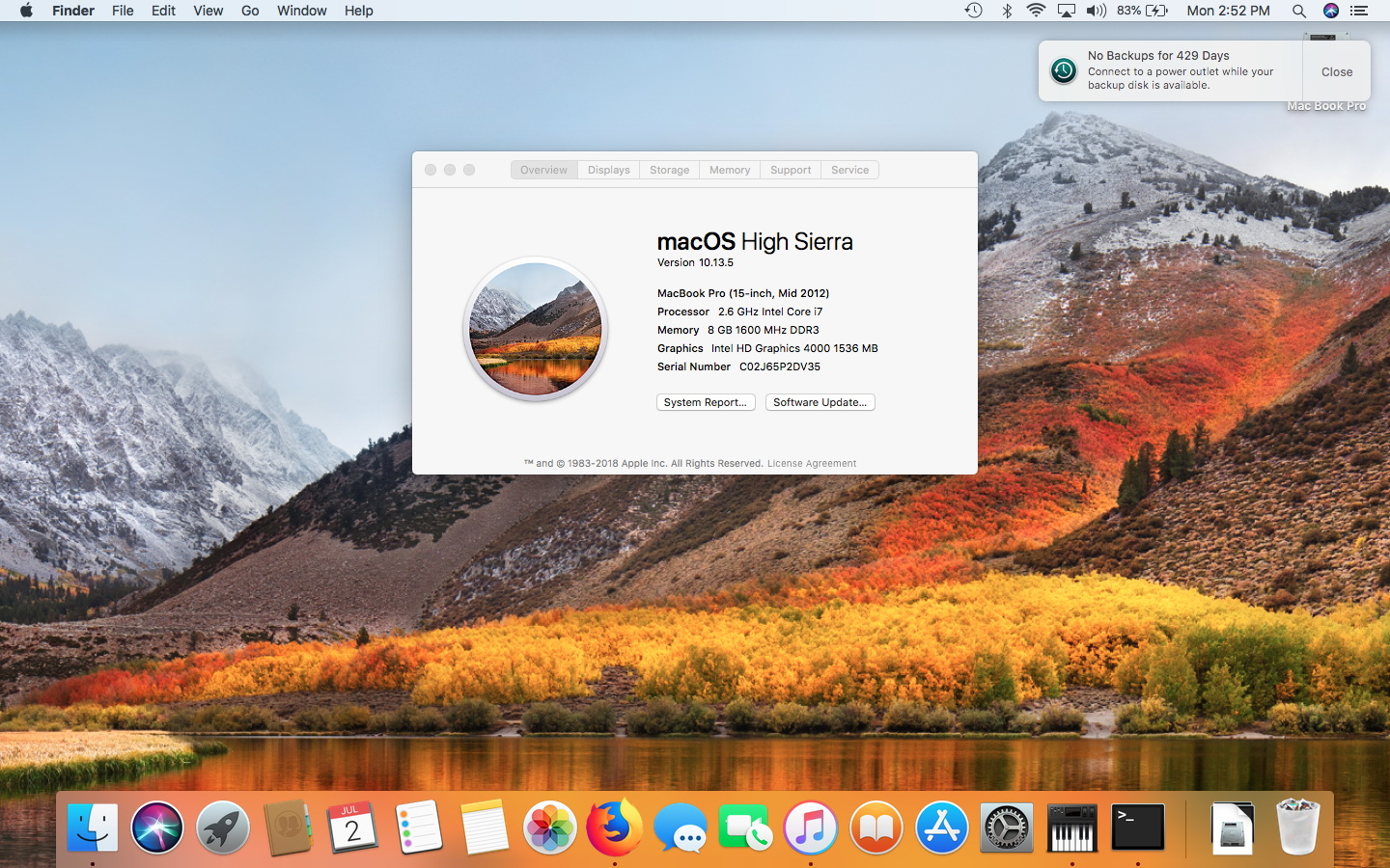

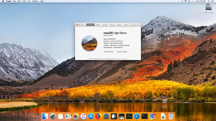

This is truly a bizarre problem and it has me baffled. Attached are screenshots of the MacBook Pro MIDI as well as the about information for both MacMini and MacBook Pro. If you look at the about information you will find there is a difference in the video cards the MacBook Pro is Intel while the MacMini is Radeon.
MacBook Pro MIDI
MacBook Pro About Screen
MacMini About Screen
