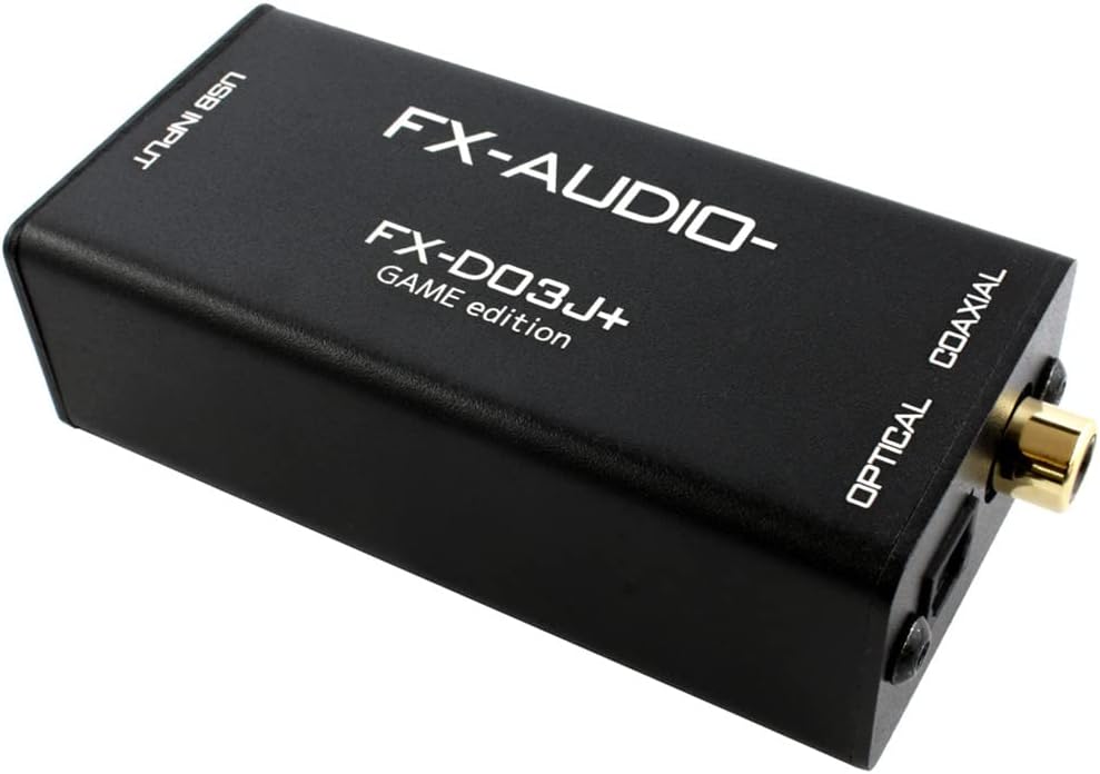

Starting from the source, you need a DDC connected to iPad, I’m using Matrix Audio X-SPDIF2 and AES/EBU connection to HDSPe AIO, but there are many other options as well (cheaper too). Singxer F1 works as well, it is coaxial S/PDIF device.

I found something similar to Singxer F-1 in my storage, so I plan to use this one.
Hopefully, the iPad will provide enough power to run the device.
I already use the optical input for another source, so I’ll use the coaxial input for this.

PS. The device in my previous post wasn’t stable – it started not to follow the input fs and sticked to 32kHz after an hour or two.
I’ll pull out the Singxer SU-6, which I used before Holo RED, and that one should be more stable, if a larger machine.
PS2. Singxer SU-6 didn’t work at all for some reason. Never made it to play any sound.
