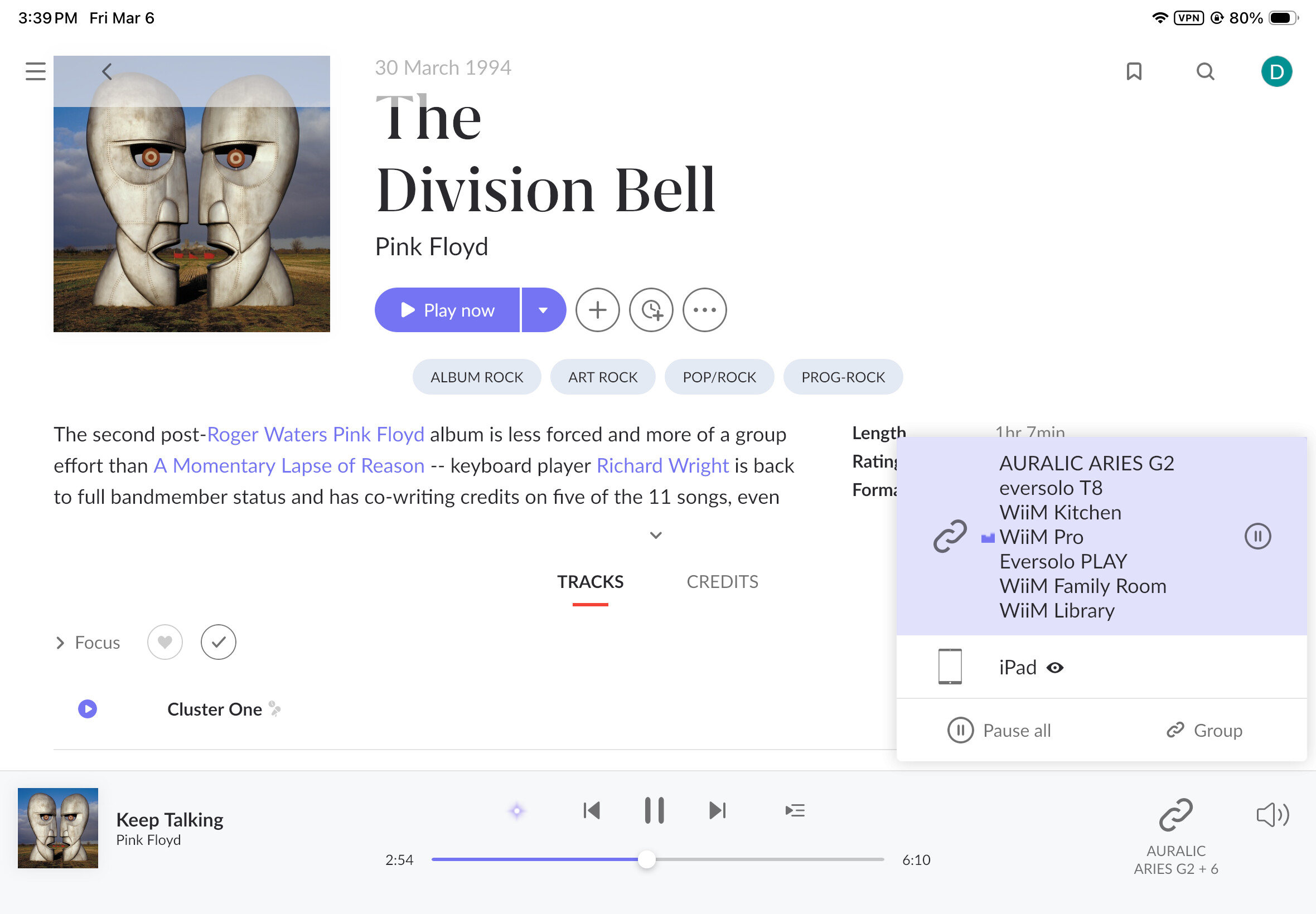

The NUC is attached to your network. The T8 is attached to your network. The T8 outputs to your Denafrips DAC. Does that make sense? See my screen capture above.
I don’t have an Eversolo. But since the T8 is being listed as Roon Ready. Your Roon NUC will find it. As long as they are on the same network.
You don’t need to physically connect the two. As the music data is sent through the network connection. For best results have them connect to your network using Ethernet and not wifi.
