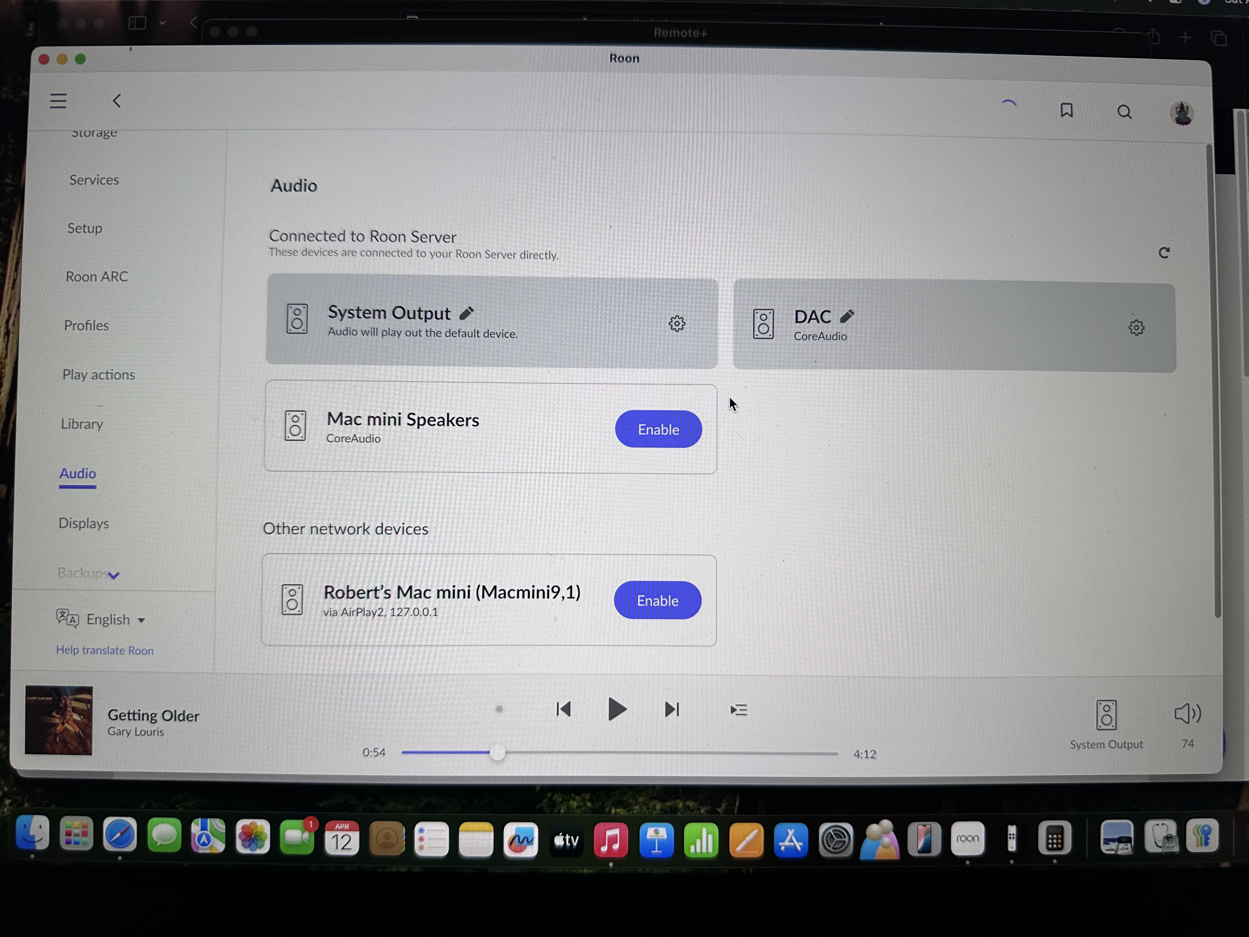

@Robert_Chatfield Roon Support will need you leave on the mini so they can examine its logs. On the MacBook, can you post a screensot of your Roon’s Settings → Audio page with the mini and MacBook on?
Ok, the Mini is on & running Roon. I have included the picture of the MacBook screen …
What version of Roon are you running on the mini and MacBook? It does not appear that Roon Remote on your MacBook is visible to the mini as a native Roon endpoint. This is similar to seeing my wife’s MB Pro as an AirPlay Roon endpoint option even though she does not have Roon installed on it. This may indicate a mismatch between versions of Roon, or Roon is not enabled through your MB’s network connection.
