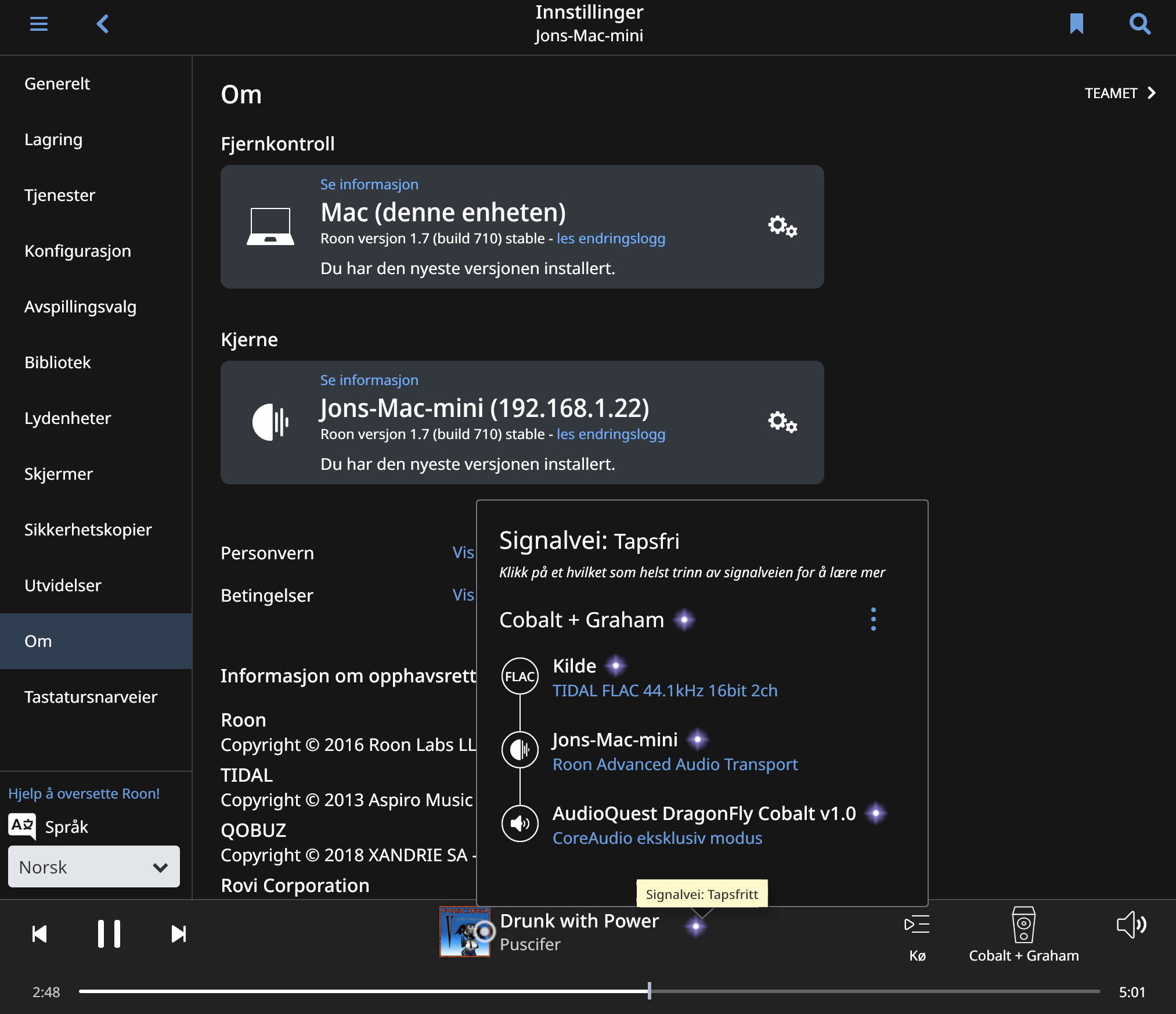

Mac Mini Server 2010 with new SSD as of 09-2020. Mac OS X High Sierra 10.13.6. Roon Server
300/300 Mbps fiber network. Network Nighthawk R8000p/X6s router - wired to Mac Mini
Mac Mini Server 2010 with SSD. Roon Server installed, USB connected AudioQuest Dragonfly Cobalt(DAC/amp in DAC only mode), connected with jack to RCA cable to a Schiit Asgard 2 headphone amp. Focal headphones. MacBook Pro 2019 as Roon Remote (Roon 1.7 build 710).

Every 5 minutes or so during music playback, I get a very strange noise/sound. It is hard to describe, but it sounds like an electronic charge passing by. About 3-4 seconds duration. The noise is almost identical each time, but seems a little influenced by the music playing. I found out this must be something concerning the Parametric EQ. Each time I turn that on of off, the noise appears after 2 seconds. But either EQ is turned on or off, the noise appears about every 5 minutes.
