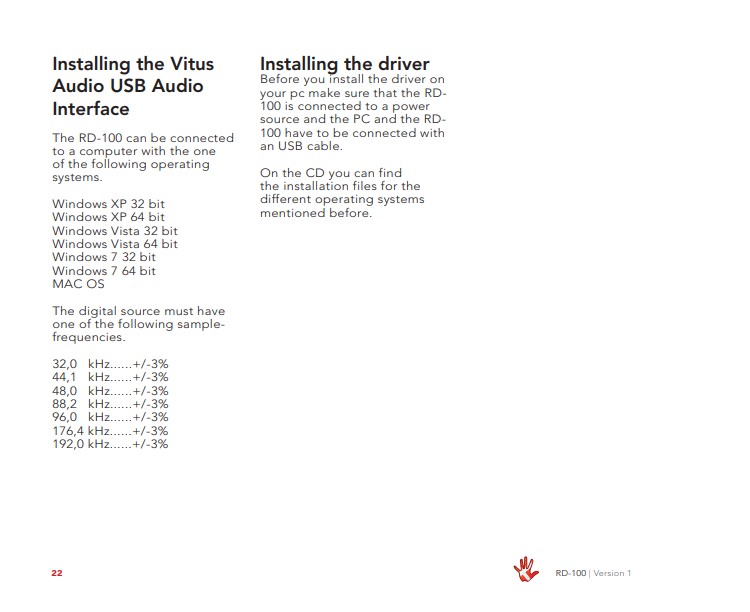

As Scott says, you need to ask Vitus. I notice that there’s no mention of the RD-100 working with Linux-based systems (which is what your QNAP is) in the manual:

Vitus do indeed say the USB interface, an M2Tech module; M2TOEM-01-USB-to-I2S requires windows and Mac drivers.
Later Vitus updated the module to M2Techs; M2TOEM-04-USB-to-I2S which M2Tech say has native support for W10, Mac OS and Linux.
So it maybe that my unit doesn’t have the updated module. I’ll have to check this with Vitus i suppose!
