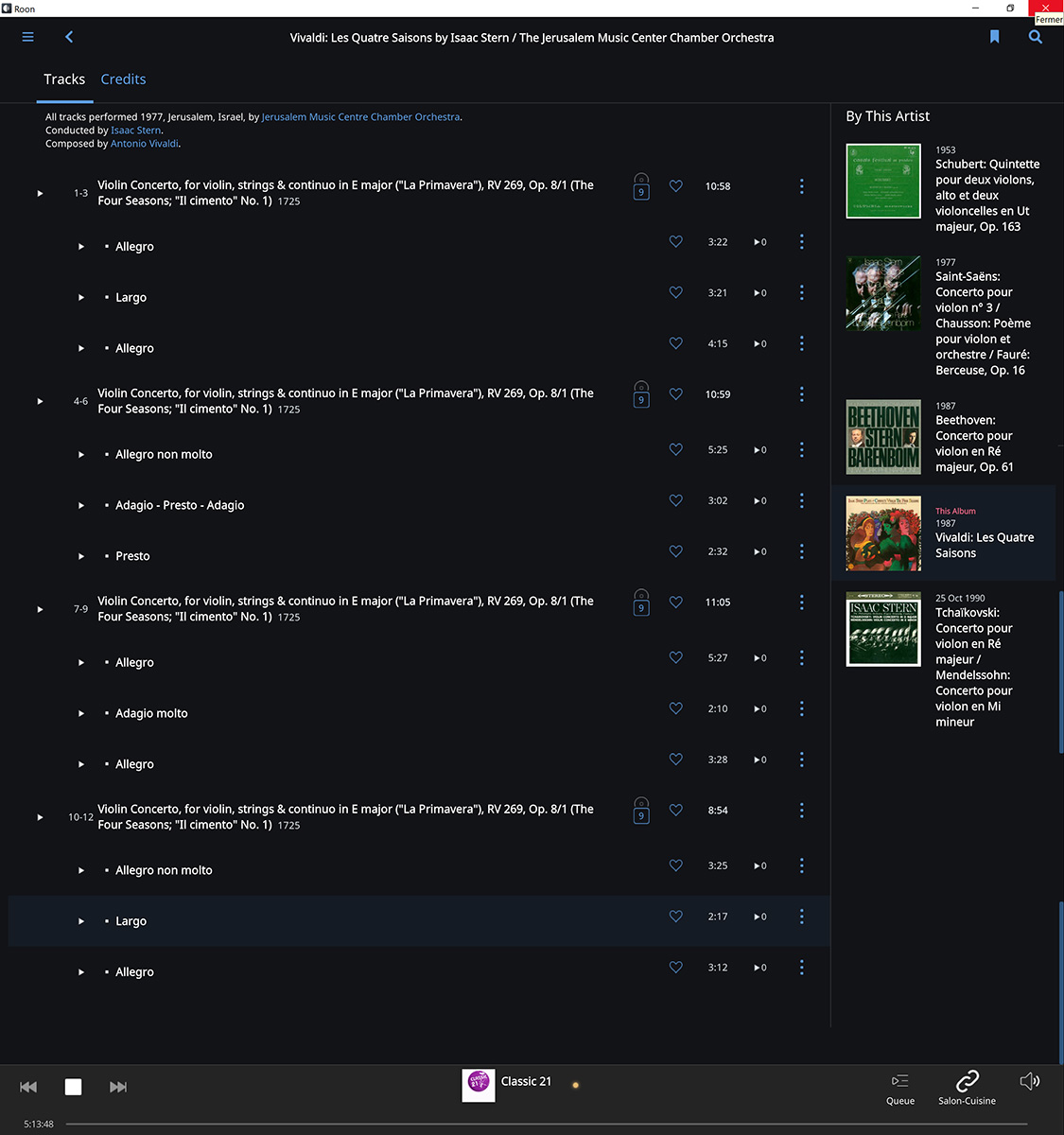

In Roon, if I set Multi-Part Composition Grouping to “Prefer Roon”, here is what I obtain:
Because I prefer to have each part associated with its corresponding concerto (and not with the more general “Il cimento dell’Armonia etc” title, which does not separate the different concertos), I set Multi-Part Composition Grouping to “Prefer File”.
But strangely, this is what I obtain when I set Multi-Part Composition Grouping to “Prefer File”:
As you can see, each concerto is now separated, but has the same name (i.e., the name of the first concerto of The Four Seasons).
(of course, in the WORK tag, each concerto has its own title).
Any idea as to why this happens? Why doesn’t Roon reproduce the concerto’s name - for concertos nb 2/3/4 - from the WORK tag? And is there way to correct it?

I unidentified the album, but nothing changed.
I also setted metadata preferences to “Prefer File” for all options. Nothing changed.
Then I wondered whether, in this particular case (for this particular album), Roon would have a problem reading the WORK tag (for an unknown reason) when I unidentify the album.
I wondered whether this problem could be due to the fact that the WORK tag contained the “default” name of the Vivaldi’s concerto (the name used by Roon in other versions of the Four Seasons).
So, I changed the WORK tag and entered for each of the concertos another (French) name.
For example, the WORK tag for the first concerto was:
“Violin Concerto, for violin, strings & continuo in E major (“La Primavera”), RV 269, Op. 8/1 (The Four Seasons; “Il cimento” No. 1)”
I changed it to:
“Concerto n° 1 en mi majeur, Op. 8, RV 269, “La primavera” (Les Quatre Saisons - Le Printemps)”
And so on for the three other concertos.
And then, after reimporting the album and unidentified it, surprise!
Here is what I get:
Each concerto is separated, but once again they all have the same name… but this time it is the one we can find in Allmusic for this album:
“Il cimento dell’Armonia e dell’Invenzione, concertos (12) for solo instrument, strings, and continuo, Op. 8”
This composition name is not in the file tags!
So, although the album is not identified (because I de-indentified it), there remains a link with Roon’s metadata, and Roon refuses to use the information written in the WORK tag (all the Metadata Preference options are setted to “Prefer File”).
My question is: why does Roon refuse to use the WORK tag in this particular case?
