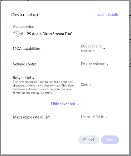

Show a screenshot of the device setup page in roon.
@ivan are there any other steps I can try to help debug the issue?

Ben here with the support team, thanks for providing that additional information! If possible, could you please recreate the issue, and then use the directions found here and send over a set of logs to our File Uploader?
If you could share the specific date, time, and name of track of when the issue occurs as well, that would be helpful. Thanks!
